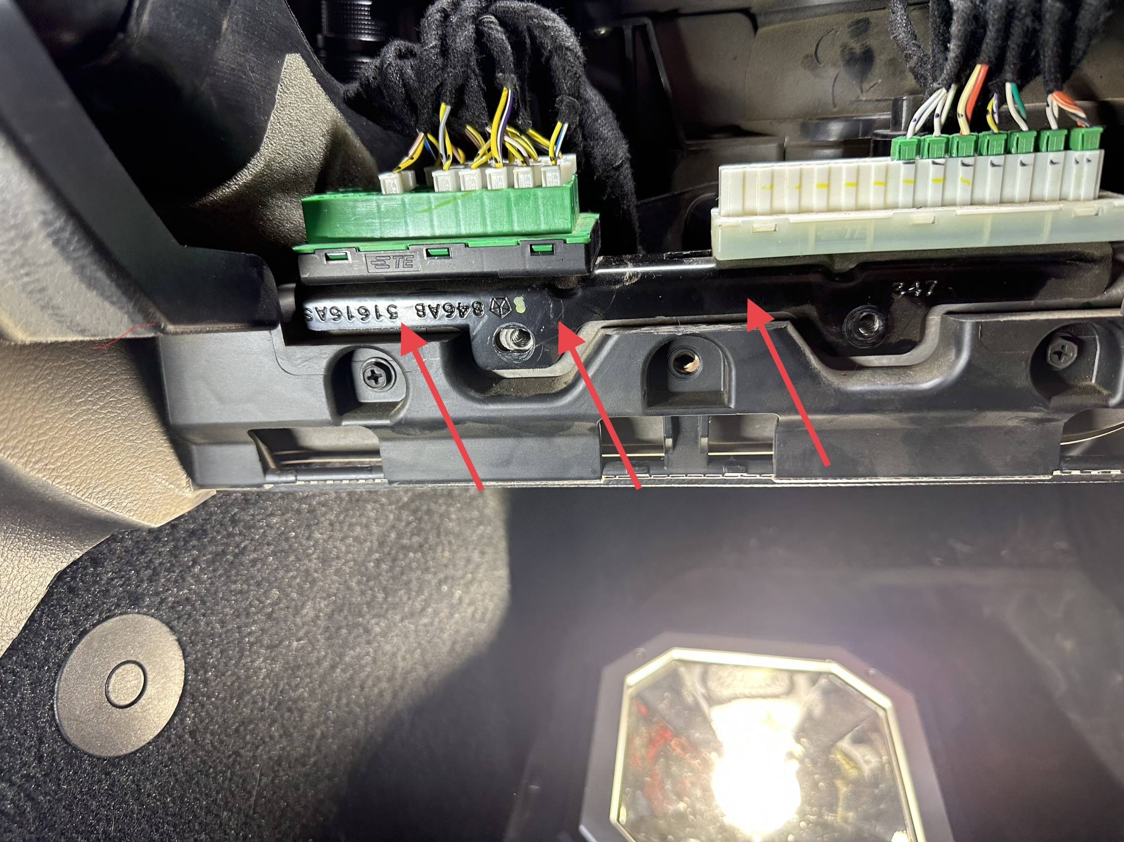

Is there a trick to removing the factory green canbus block? Probably a dumb question but I’m notorious for breaking things and don’t want to just pry something off. I thought I could just unbolt the black metal bracket (that the red arrows are pointing to in my pic) that the canbus blocks are connected to and get access to the little tabs on the bottom of the canbus block, but the bracket isn’t lifting off like I thought it would. Thanks in advance!
If memory serves me right, there's a bolt on the backside of the black metal bracket. Run your finger on the backside to feel for it. After all bolts were removed I had to wiggle mine pretty good to free it up, the black wiring harness held it in pretty tight. Pretty sure the harness is held in by 2 plastic push connectors as well. Loosen those to get the bracket completely free.
It slides out - left or right, I don't remember which. Look at the bottom side of the replacement and you'll see the 2 clips and be able to determine which way it slides out. No need to remove any bracket.
