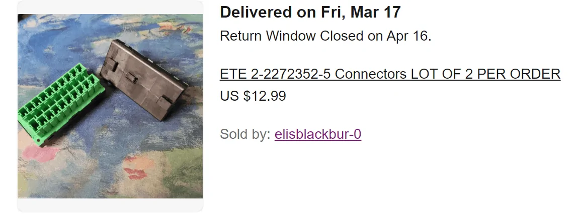

I replaced the green can bus connection block behind the glove box early last week. It was $12 on ebay and 10 minutes to replace. Solved my electrical issues. Jeep has been driven every day and over 700 miles since replacing it. Prior to replacing the green block, we were getting a bunch of warning lights multiple times every time we drove it - as well as loss of power steering.
What did u search for on eBay. My dealer wants $116
Oh wow. I can't find it on eBay anymore. Here's a screenshot from my purchase history that shows the seller and the item desription. Maybe contact that seller to see if he is just out of stock at the moment.
