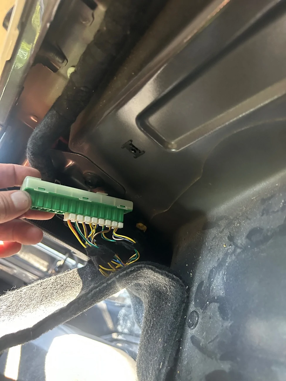

I read quite a bit about the green and white can-bus connectors being a common failure so I got ahold of both the green and white connectors and replaced both, let the jeep sit with the battery disconnected for a while after replacing the can-bus connectors then reconnected the battery and the same issue was still present, no radio display, no climate controls working, still the service 4wd light and now a check engine light.

We had to use the jeep to run some errands and while out after being fine for an entire day the same array of issues resurfaced plus a few more, door locks not functioning properly via button in the jeep or key fob, power limitation message, ess not ready, and the power steering also gave out for a moment luckily it was on our road, I pulled the jeep in the driveway and shut it off, tried to restart it and the gauge cluster would power on but the jeep wouldnt start. So I let it sit for awhile with the battery negative disconnected again to reset everything, after this the jeep still wouldn’t start. I ended up unplugging all of the canbus connectors then re installed them to which everything started working again. At this point im not quite sure what is going on. .
