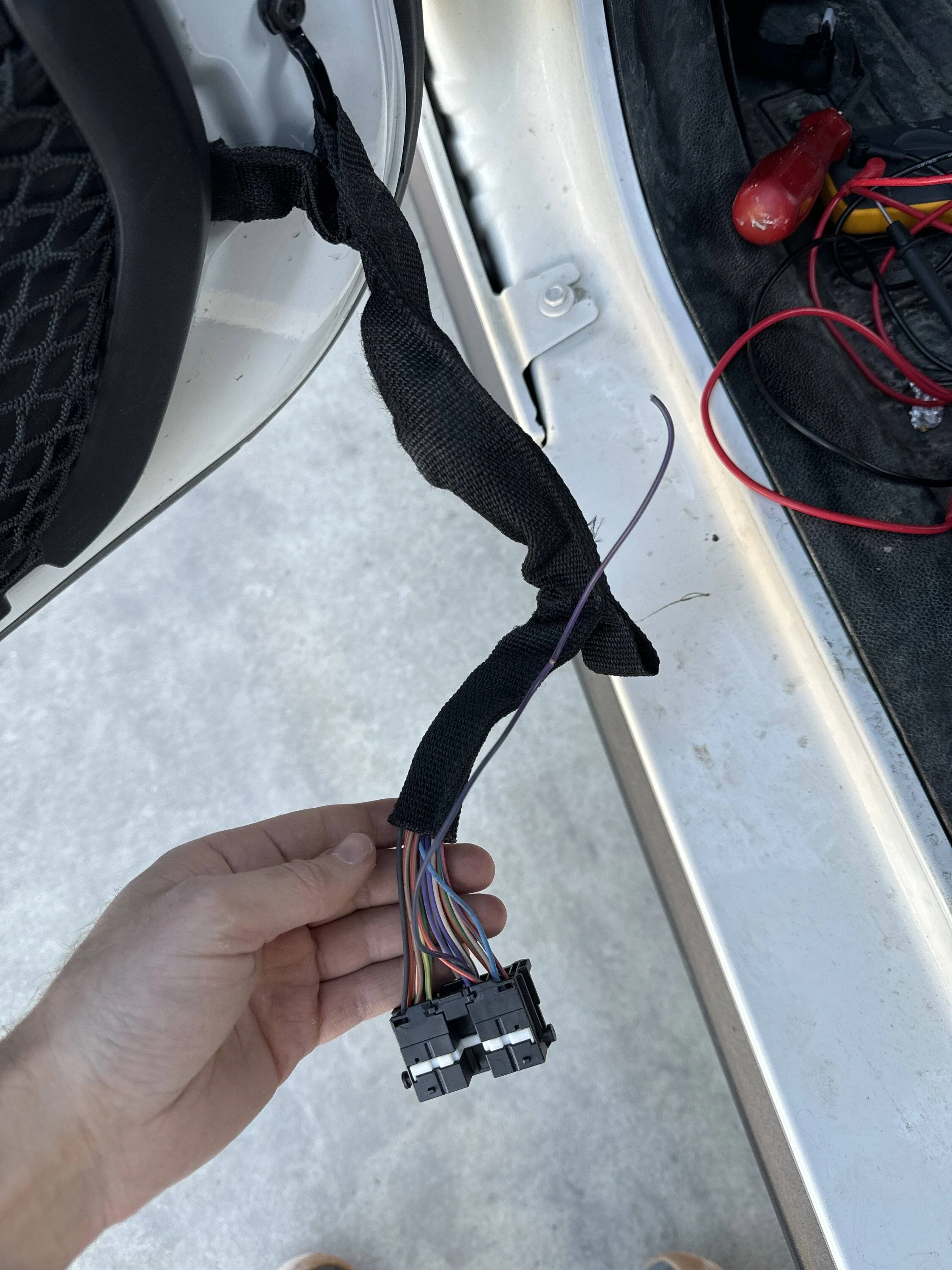

goldenrubicon
Mar 8, 2026
Golden, CO
2020 JLU Rubicon Diesel
I have the exact same problem on my 2020 Rubicon. I have never taken the doors off. We tested the wires from the lock switch and found a continuity issue. I pulled the harness sheath back and found the green/purple wire broken and two other wires with damage to the outer cover. I’ll likely run some new wire and splice else I will buy a new harness since the prices are decent.
