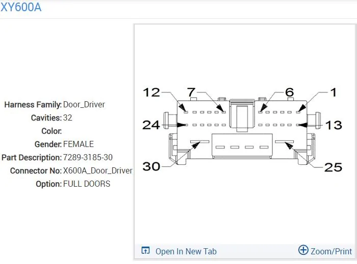

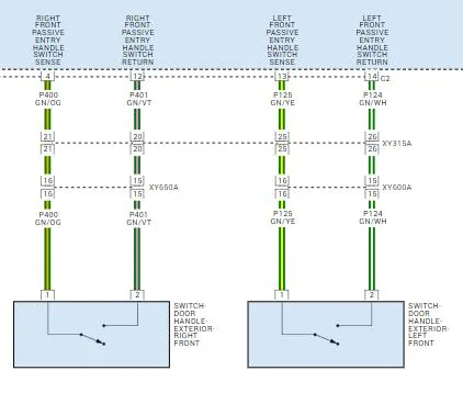

@mwilk012 is alluding to a bent pin in the door harness connector. When the doors are removed, there's a connector you disconnect in the kick panel. When reconnected, that pin could get bent and not make contact. Pin 15/16 below.
Thanks! I’ll check that a little later today. Hopefully that fixes it
