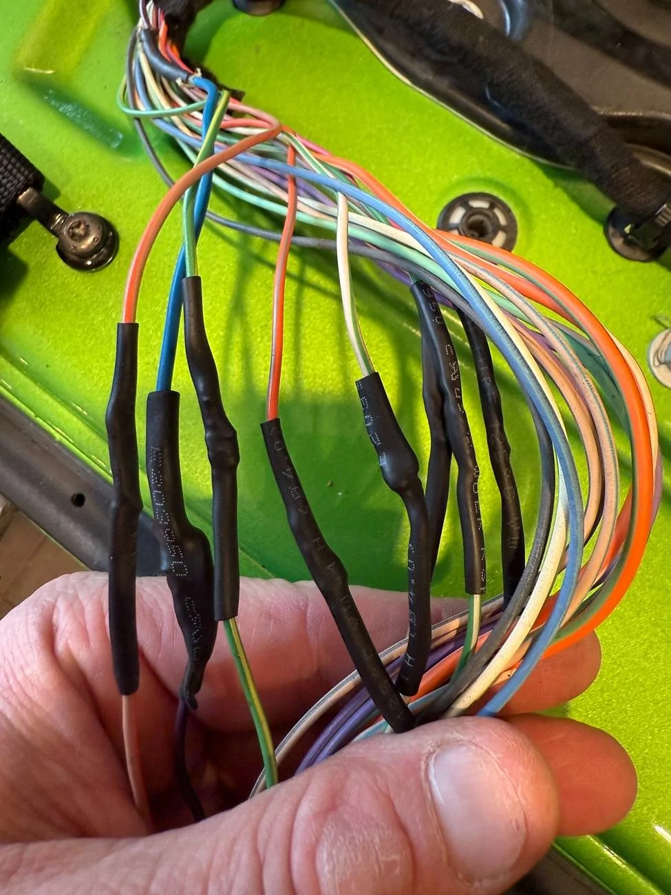

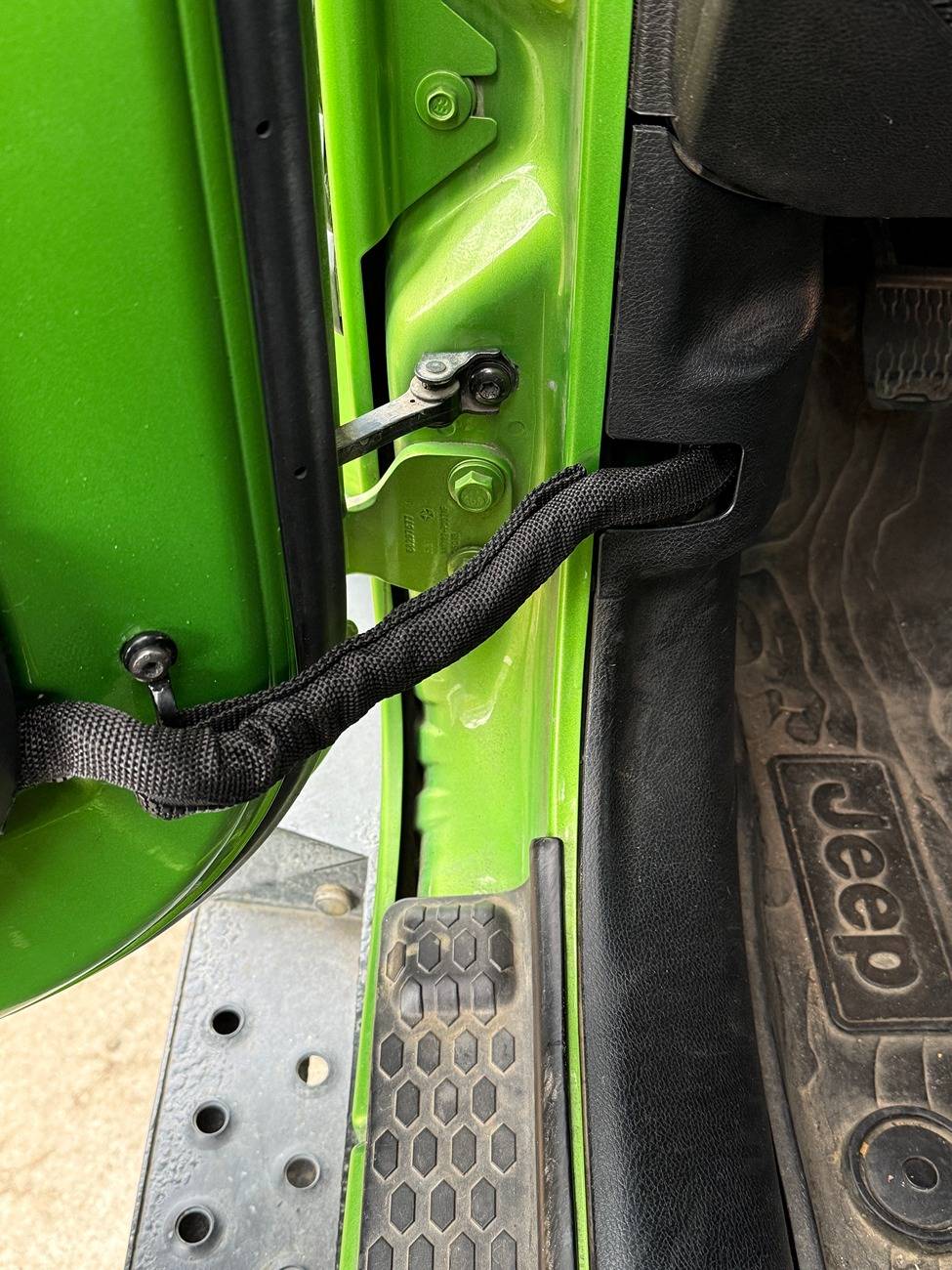

I have been having issues for few months with my power mirrors not working, then all of a sudden the driver door lock/unlock button and proximity stopped working. Passenger and Tailgate were fine and would lock/unlock all doors. I take the doors off frequently and i checked the pins many times and they were all fine. I tried to pull on the wires individually and they all seemed tight. I checked fuses, connectors in the passenger footwell and almost went to the dealer.
Last weekend, I finally cut the wire cover and i had 8 broken or about to break wires. I soldered the wires and put heat shrink around my repairs, put on a new wire cover and good as new. I guess after 6 years and 100k miles that's what happens in a Wrangler... Never had an issue in any other vehicle including my Pontiac with 270k. Hope this helps someone, I spent hours googling and going nuts.

Where'd ya get the new wire cover ?
This break was where the wires bend where the door opens and closes right ?
For a more permanent solution would it be better the splice in like 3" of silicone wire for better repeated flexibility at the bend point ?

I got the cover on Amazon. It has a zipper so you don't have to cut it again. Its slightly thinner than factory. The only issue is the hook that goes to the door to the hook in the footwell is too short so the door barely opens. I'm ok with the footwell hook not attached.
Silicone wire might be a good upgrade, but I'm ok with my fix and see how long it lasts.
