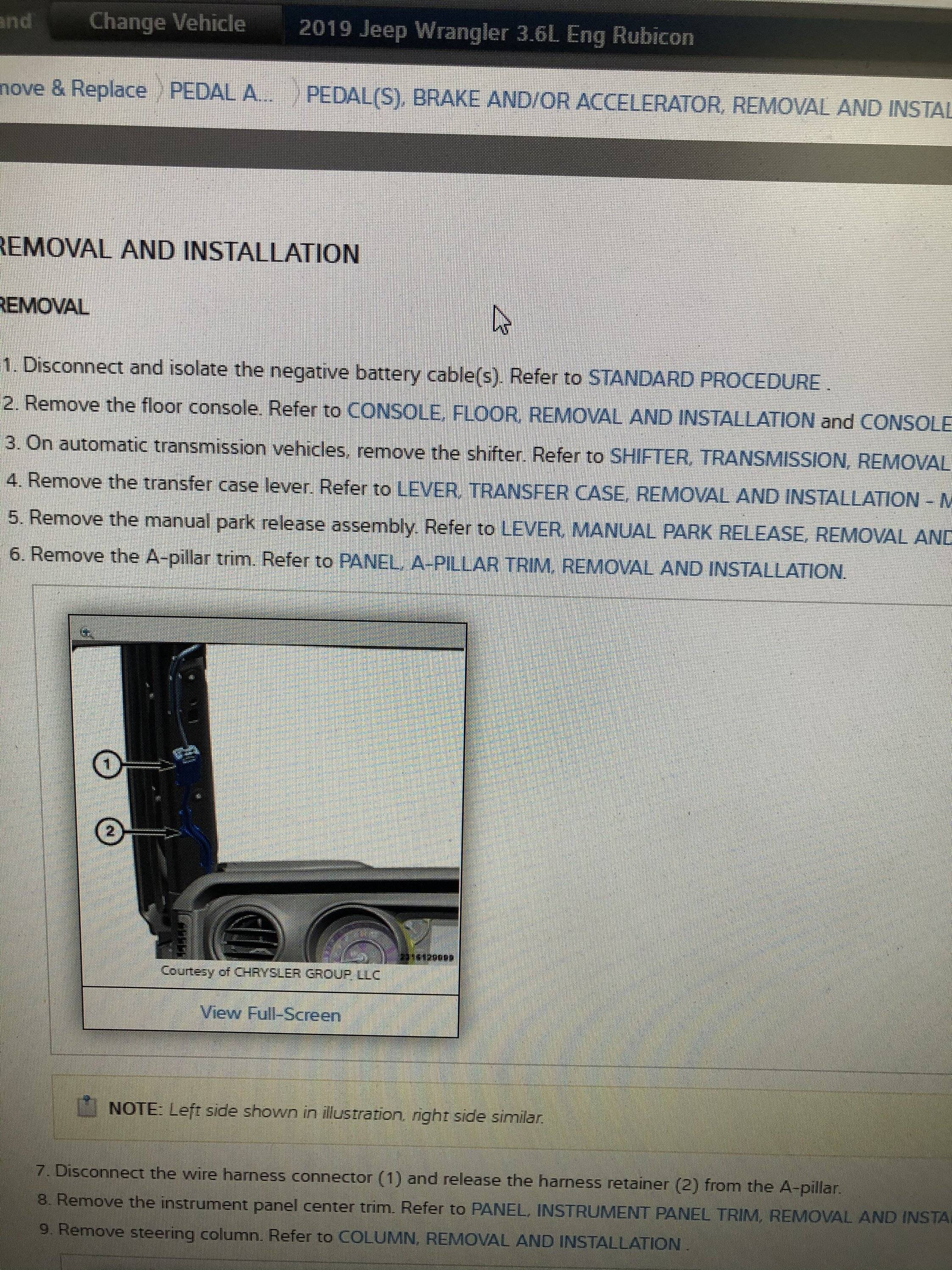

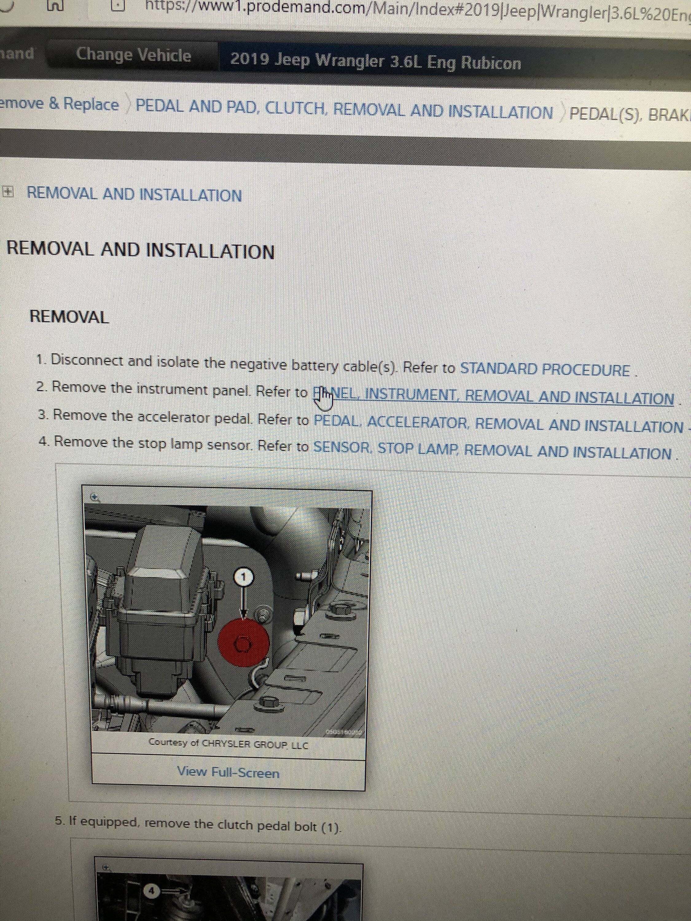

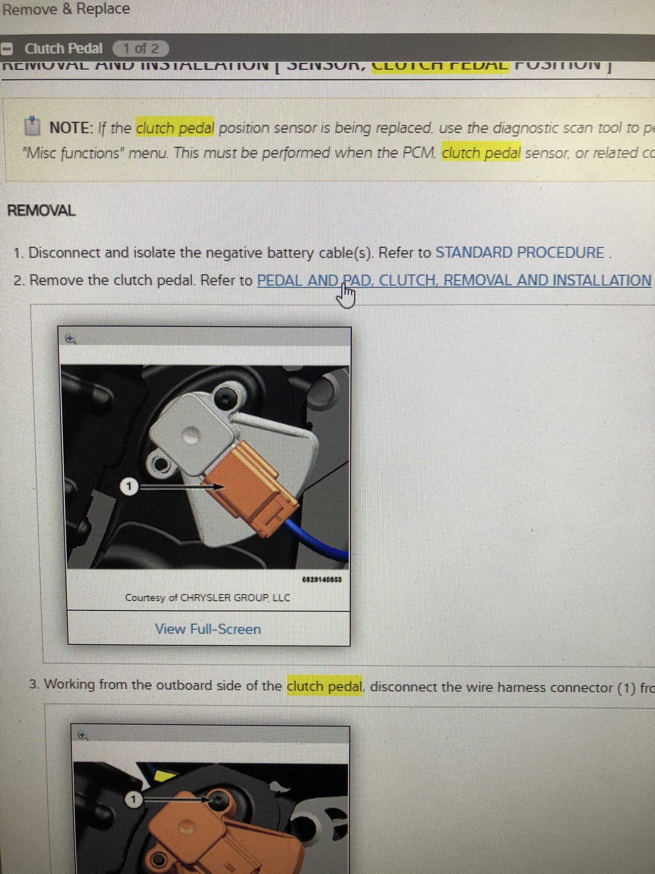

You pull the whole freaking dash out to remove the three pedals as an assembly then disassemble that to get to the sensor.

Oh nooo, don’t say that…. Sounds miserable

To save a little time you could quit reattaching the negative battery cable. That way you wouldn't have to remove it again as the first step of the next disassembly. ;)
