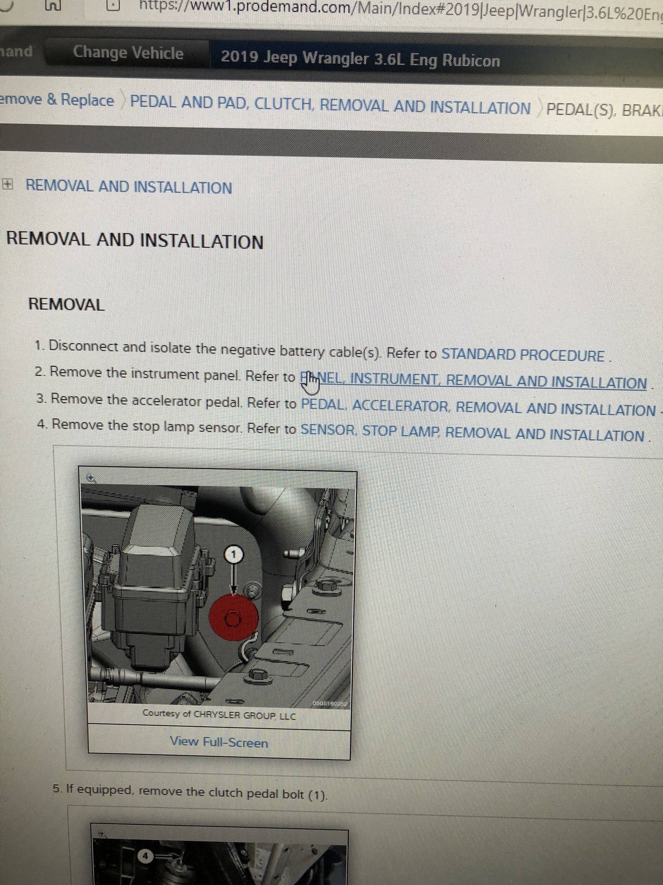

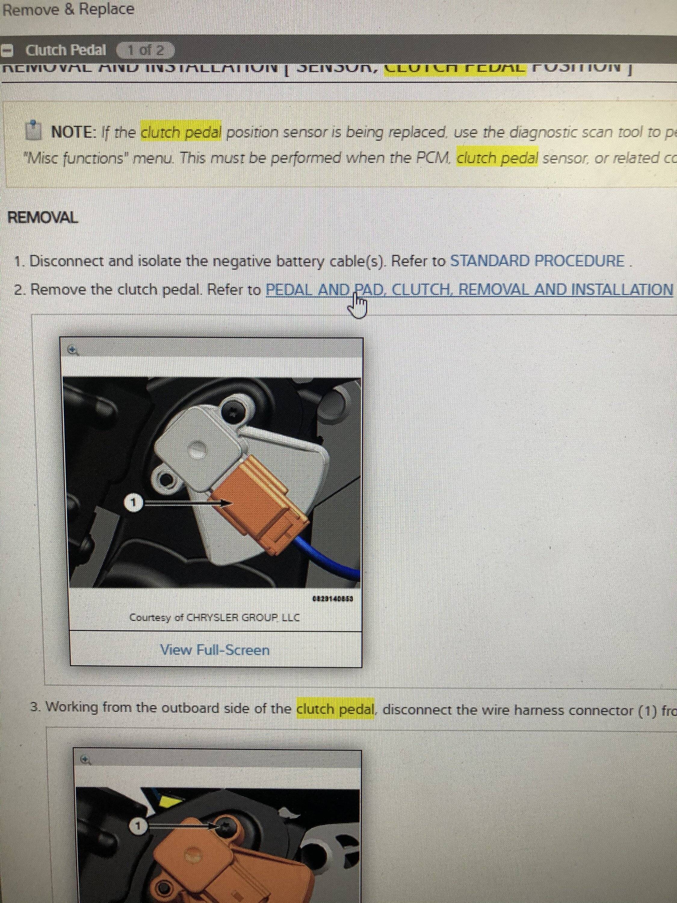

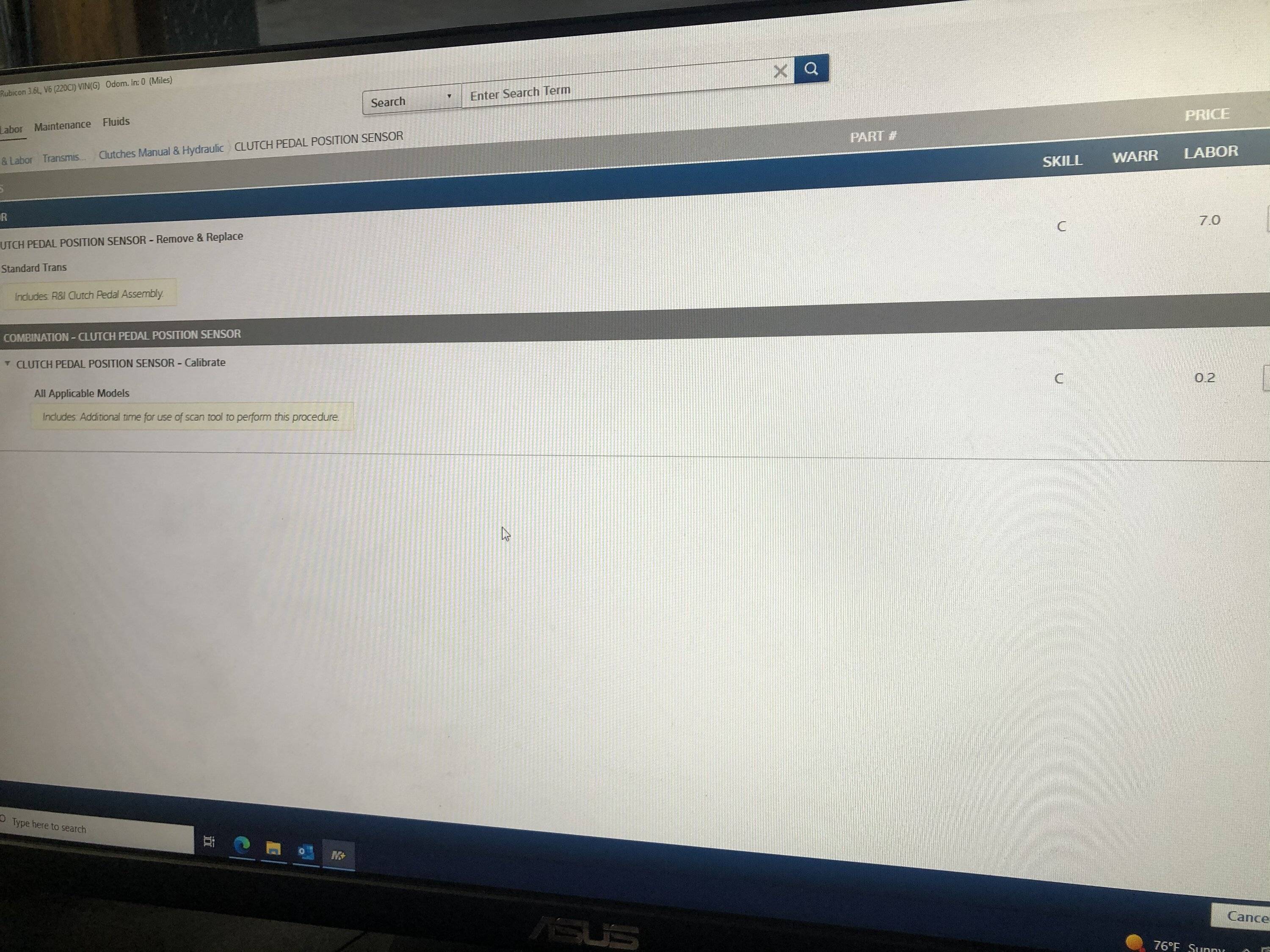

It’s certainly not true that only the dealership can do this level of work, but it is a 7.2 hour job.

Alldata? I did not have or overlooked that screen? I thought I had checked every link associated. At any rate thx mwilko12 that helps JasOn with his discussion.

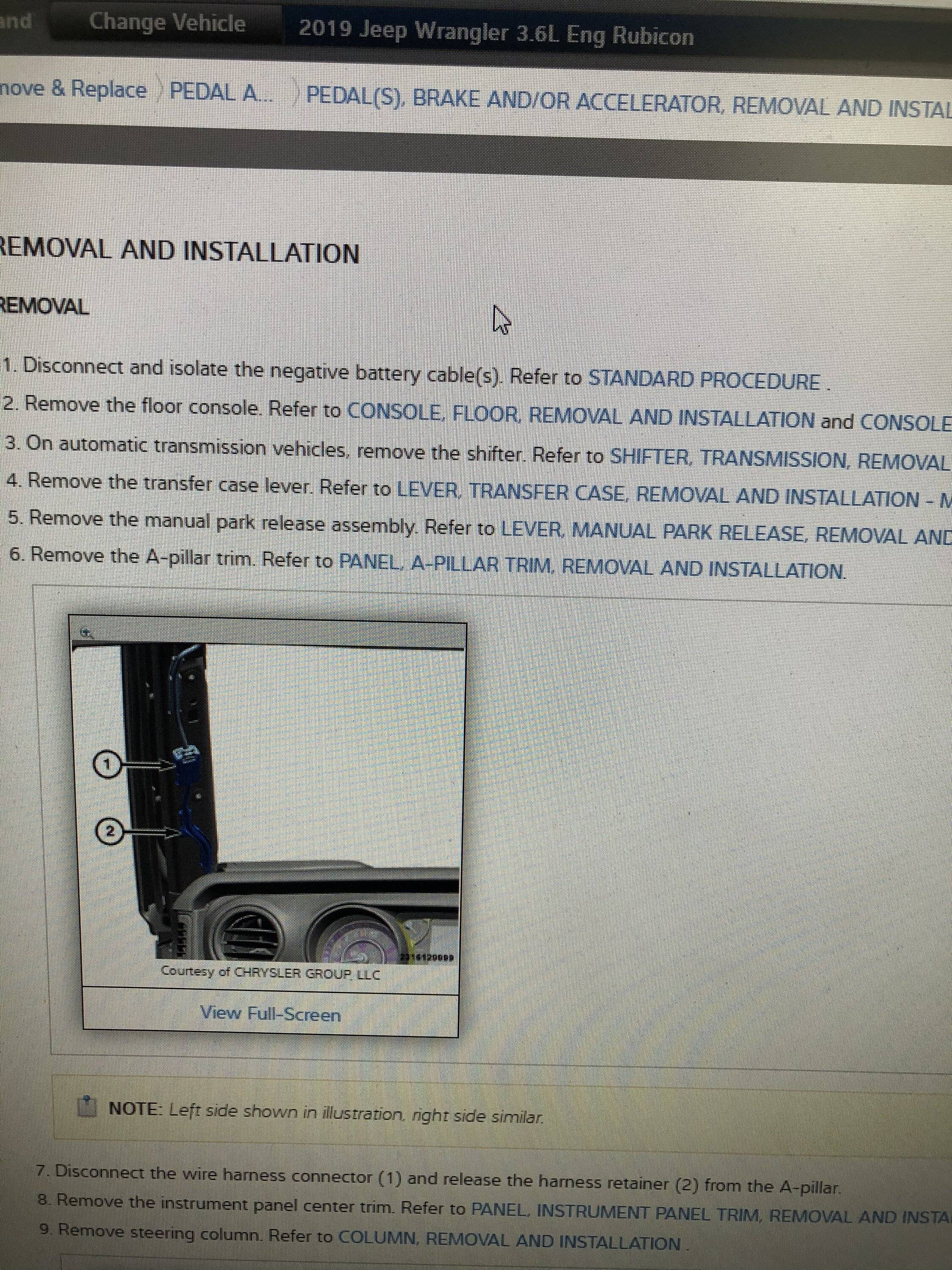

Thank you very much Rico. So what I'm seeing from this is that the tech potentially told me that it takes 8 hours of labor just for them to remove the dash, but according to this tech diagram it is a .5 hr job. I will try and call the dealership and see what they say about this. I really appreciate it and hope this issue finally goes away.
That “clutch switch” is the one on the side of the clutch master cylinder. If you’ll look at the procedure he posted, it pretty much just glosses over step 2, “remove the clutch pedal assembly”, which is a 7 hour job.
