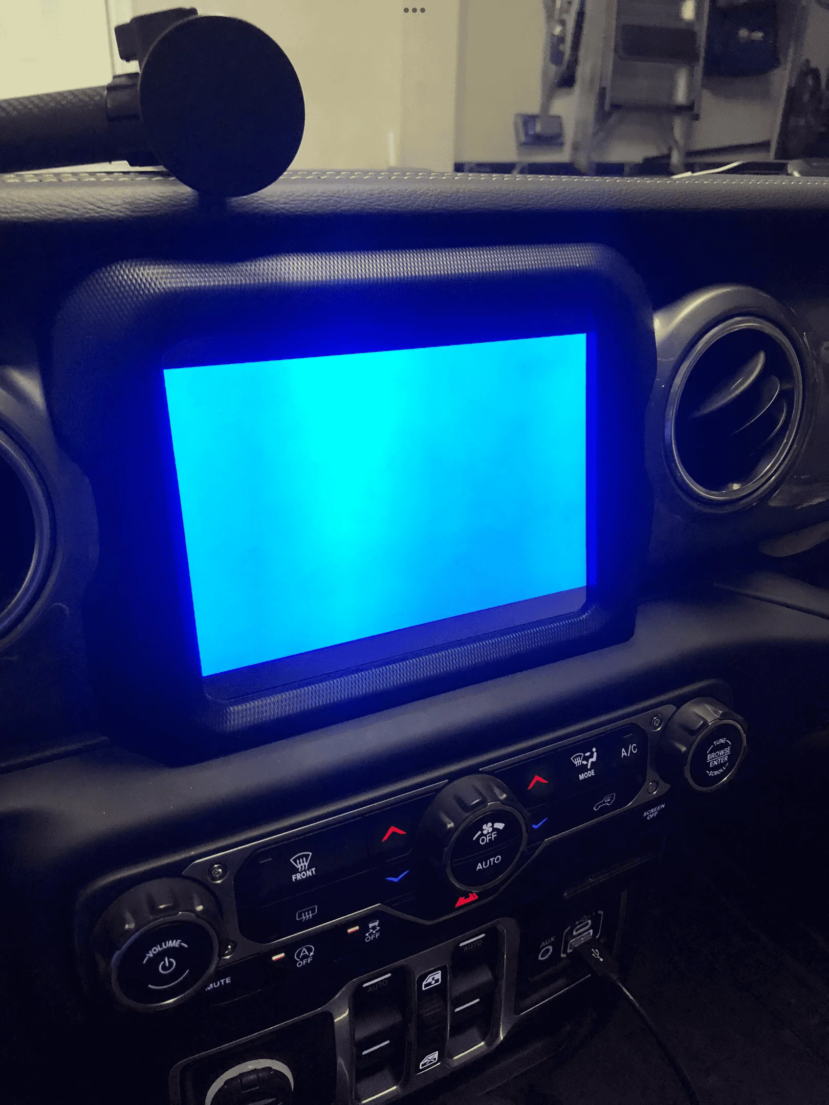

If it resolves this issue, I’m all for it! ?. FWIW, the screen comes in black or green as well.
