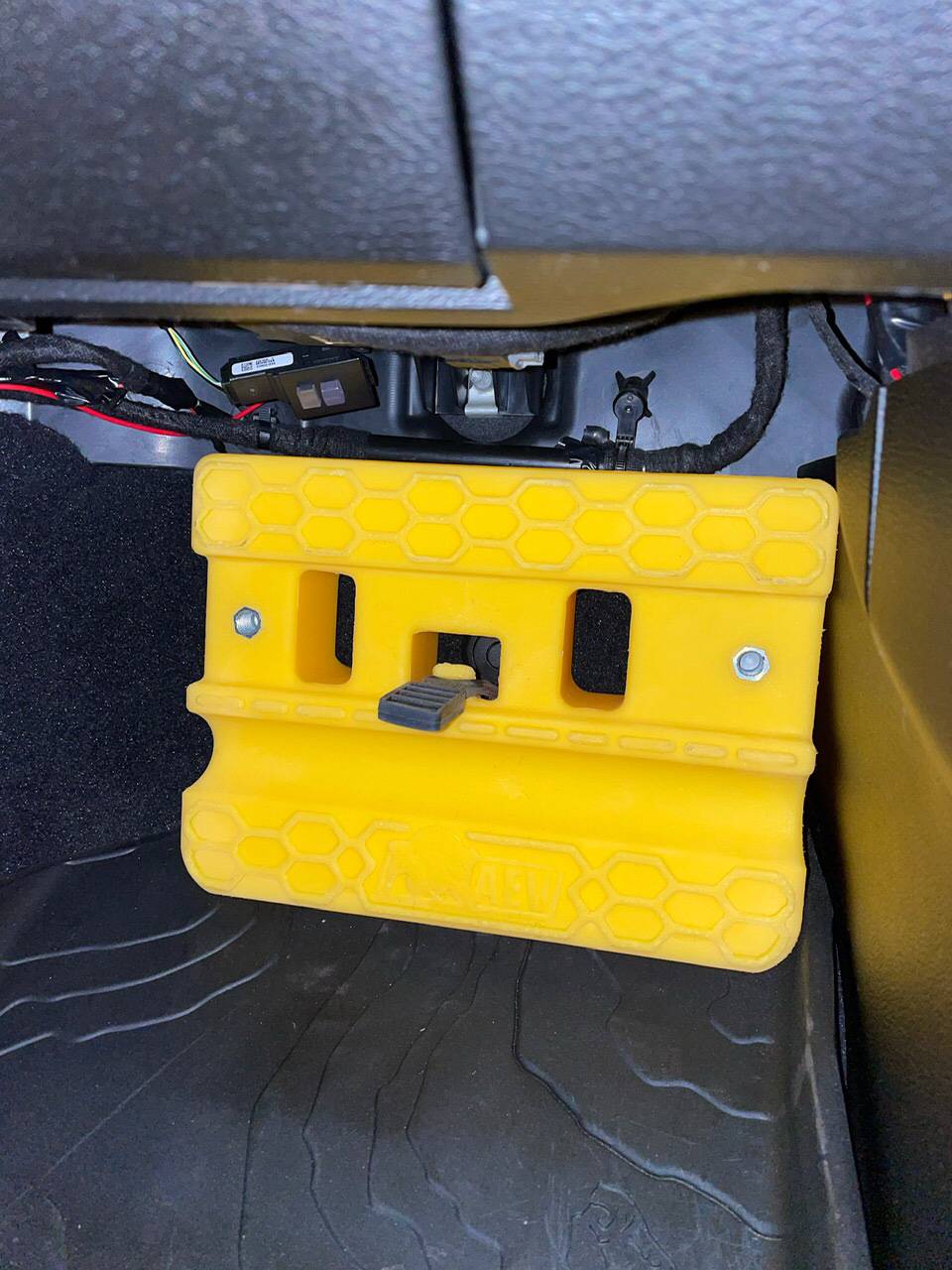

This is what I’m using for tools,recovery gear etc.
Love this- but does it have a way to lock it down (a hook for a cable lock, etc) to keep someone from just walking off with it?
Yes it does. I’m using combination cable locks (the ones for bicycles) on each side. I routed them under the seat real then through the handle on the box. Then I used a bungee around the handle to the latches points on the floor where the rear seat was latched to.

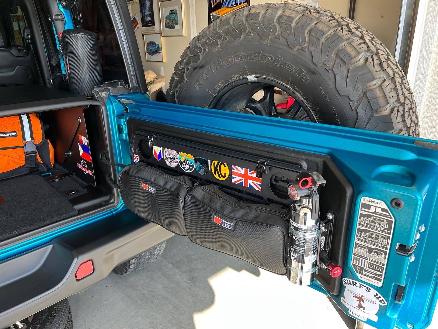

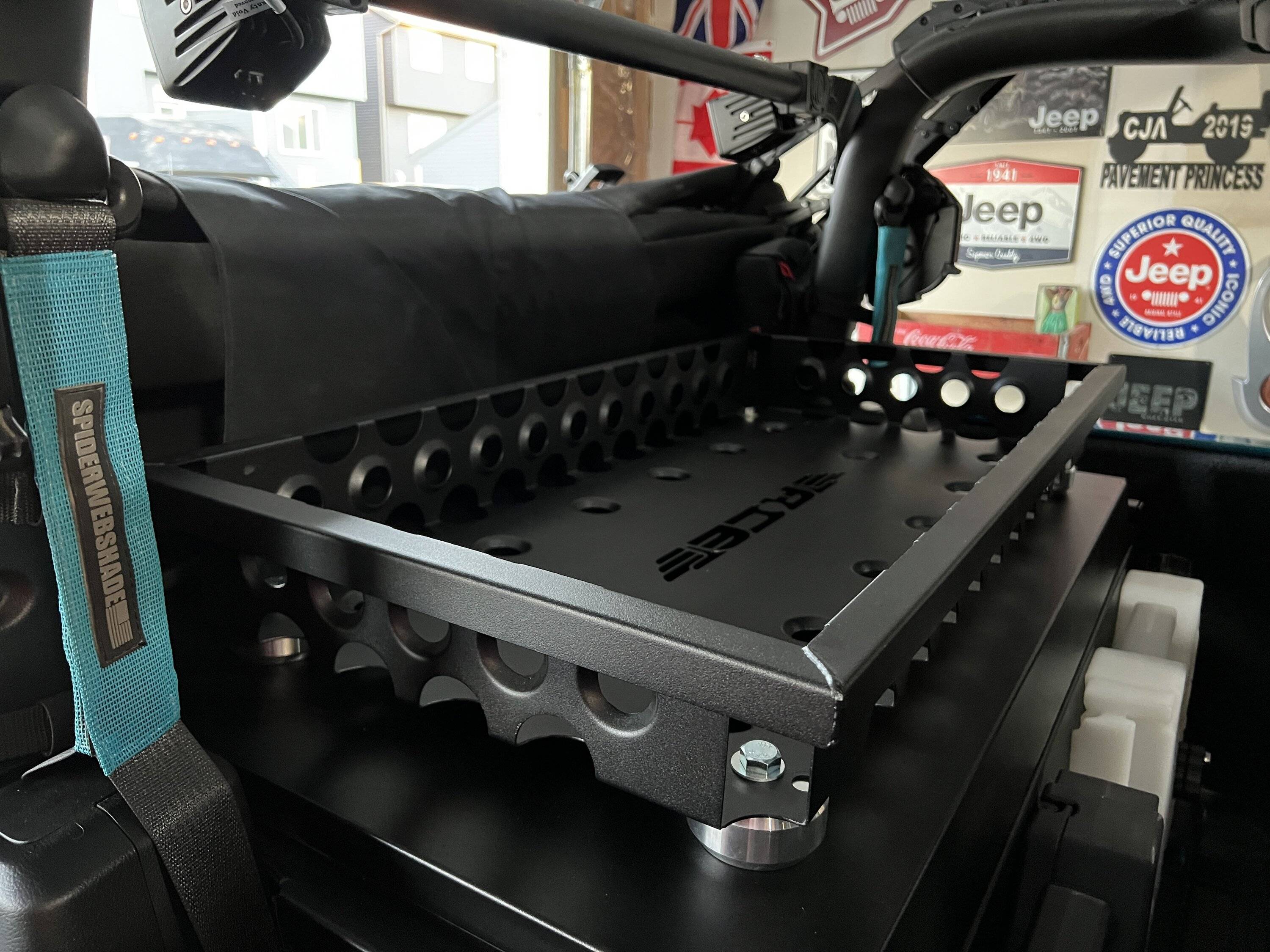

I think I now have my storage pretty much dialled in.
‘Warn epic storage bags on the seat backs, tailgate table and roll bars, Tuffy security enclosure with an Ace Engineering cargo rack on top, Rotopax water container and Rotopax tool container on the front And the AEV jack base in the passenger footwell.

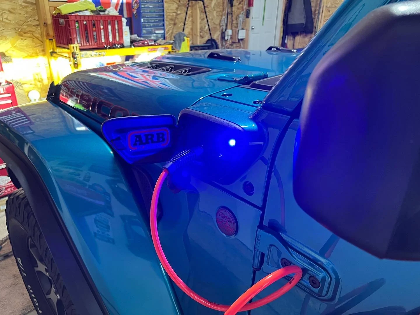

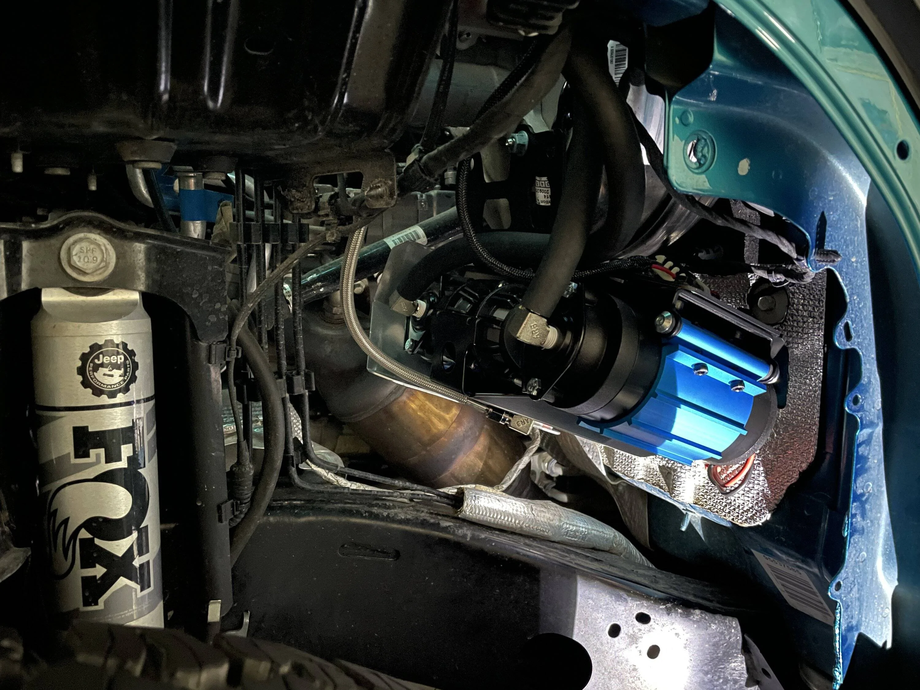

My ARB dual compressor is tucked away behind the fender liner, powered by one of the aux switches and exits behind a 4xE charge port.

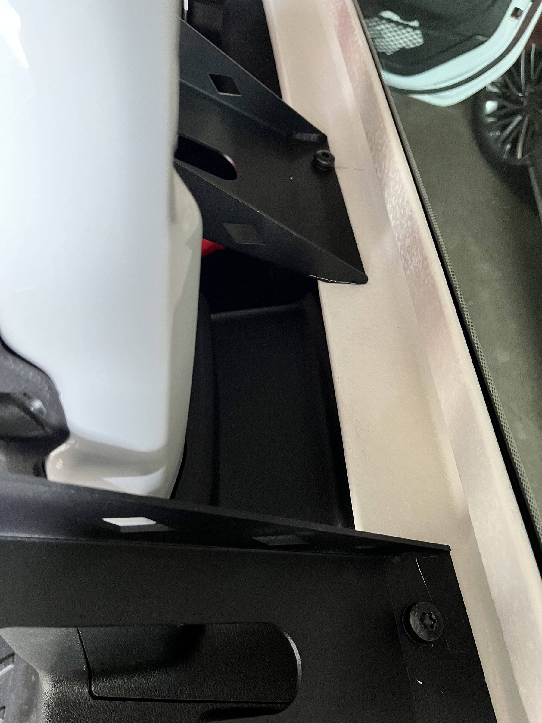

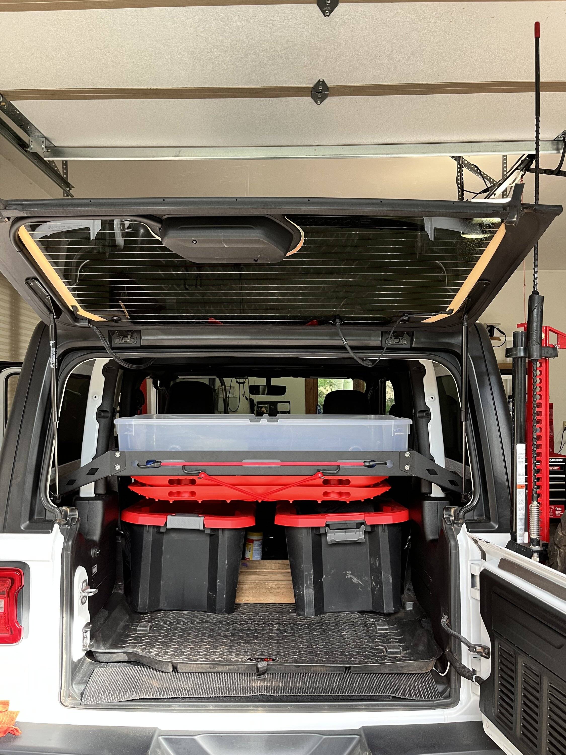

I bought this shelf and attempted to install it like you have written out. I never could get it to work for me. I ended up buying the longer soft top bolts from the dealership, ripping a 2x4 down, drilling holes for the bolts to mount thru them, and screwing the shelf to the 2x4. I also mounted it in front of the roll bar but it could be done the same way in the original position around the roll bar. Works for me.

Nice modified application. Looks like you may have put the wider bracket in the rear instead of toward the front.
By using the skinnier bracket in the rear you can straddle the roll bar.
Yes, you will still need to re-drill the holes in the bracket mounts as I described above but it should fit perfectly when you are done.
My scenario will result in the entire bracket being located less forward than yours. It just depends on which is more suitable to your preference.
Enjoy.
