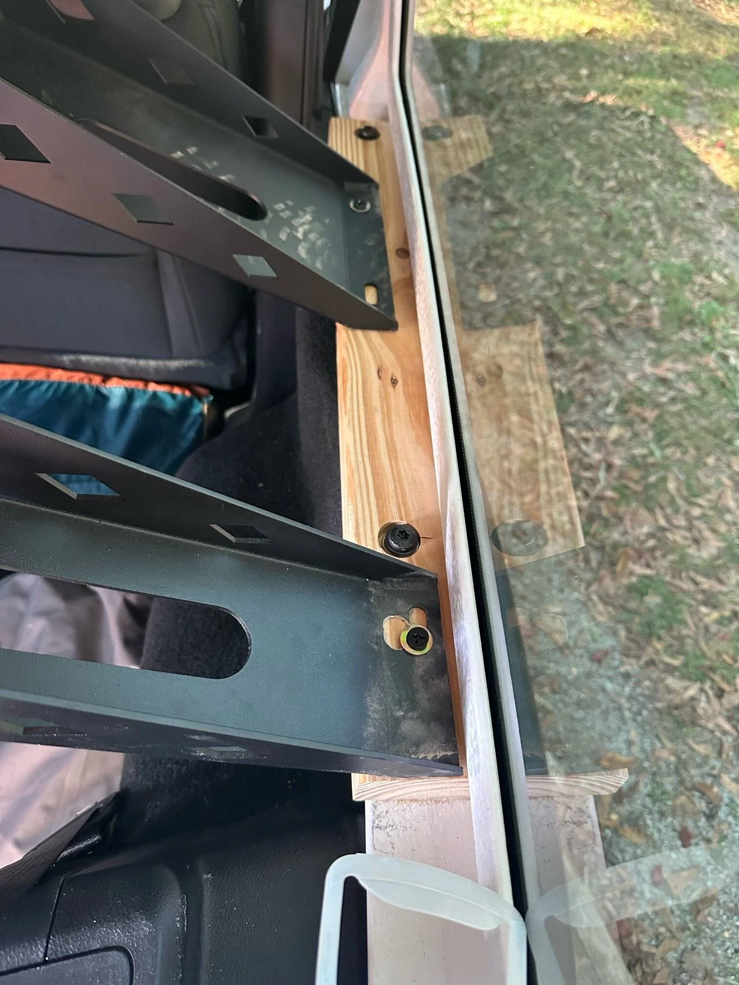

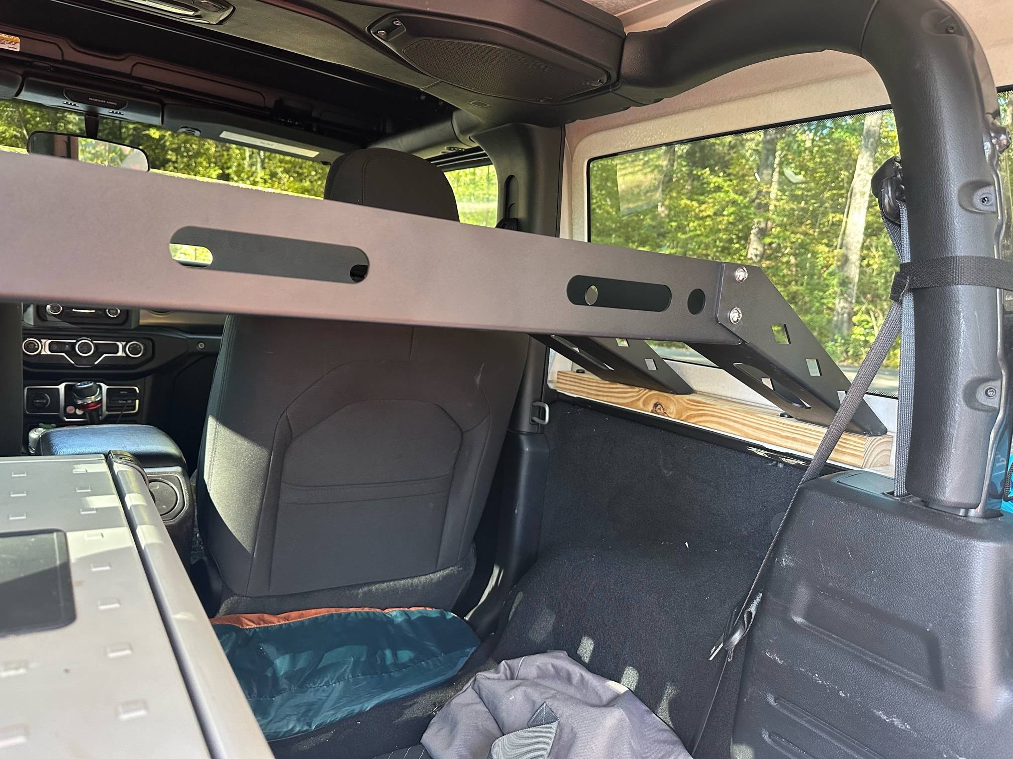

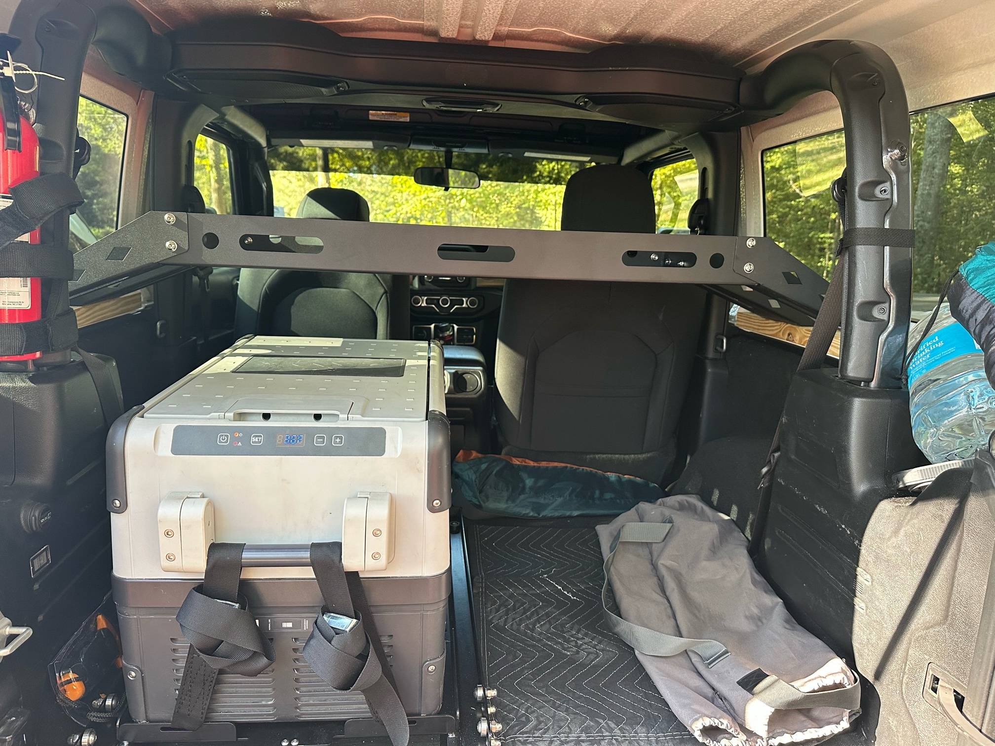

Nice application! Do you have a part number or specific dimensions for the longer soft top bolts you used? The OEM hard op bolts ar M8 x 1.25. I am thinking of ripping a 1x4 down the middle (you indicate you ripped a 2x4). I would then need to use an M8x 2”. I am going to try to call the dealer, but thought I would ask you first.I bought this shelf and attempted to install it like you have written out. I never could get it to work for me. I ended up buying the longer soft top bolts from the dealership, ripping a 2x4 down, drilling holes for the bolts to mount thru them, and screwing the shelf to the 2x4. I also mounted it in front of the roll bar but it could be done the same way in the original position around the roll bar. Works for me.
