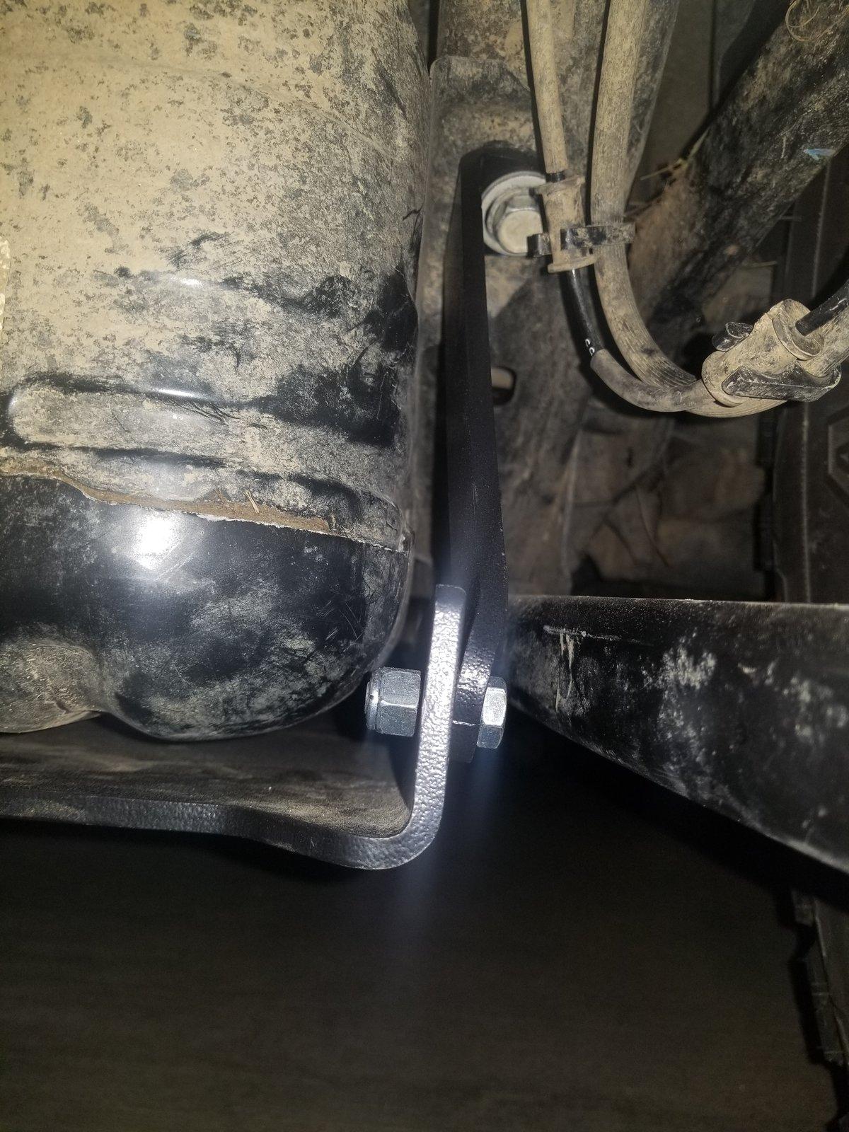

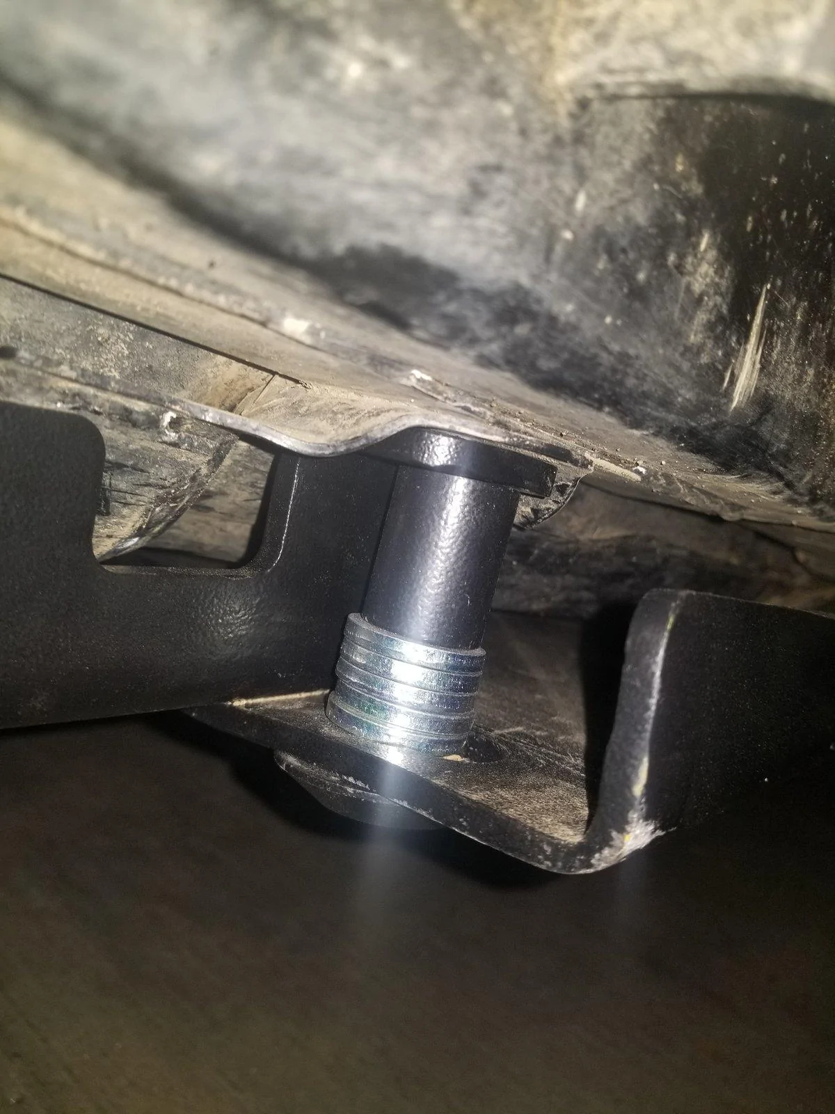

For anyone looking for skids, I can not and will not recommend RockHard 4x4. Here are some pics of my skids and the issues I can easily see after the install. The washers as a spacer speaks for itself and the other pic has the bracket on the outside and the offset bend is wrong. All the upward press on that skid will be transferred to trying to shear the 3/8th bolt instead of the bracket (should be on inside according to instructions) and the plate.

I will have my local machine shop make a proper heavy walled spacer that will fit properly and I will remove the bracket, correct the bed and install it on the inside where it belongs
