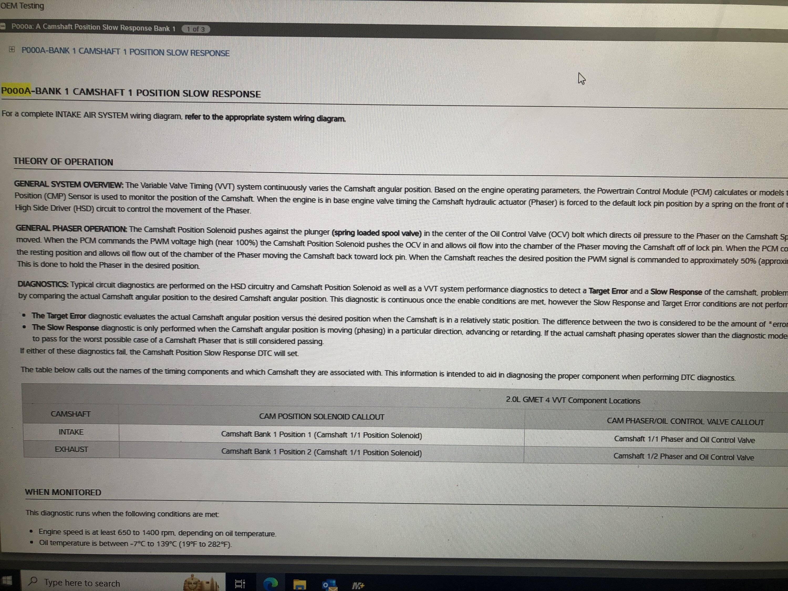

Here’s the theory of operation for the two of them. At least, partially.
as it’s under warranty, it needs to go to the dealer.
