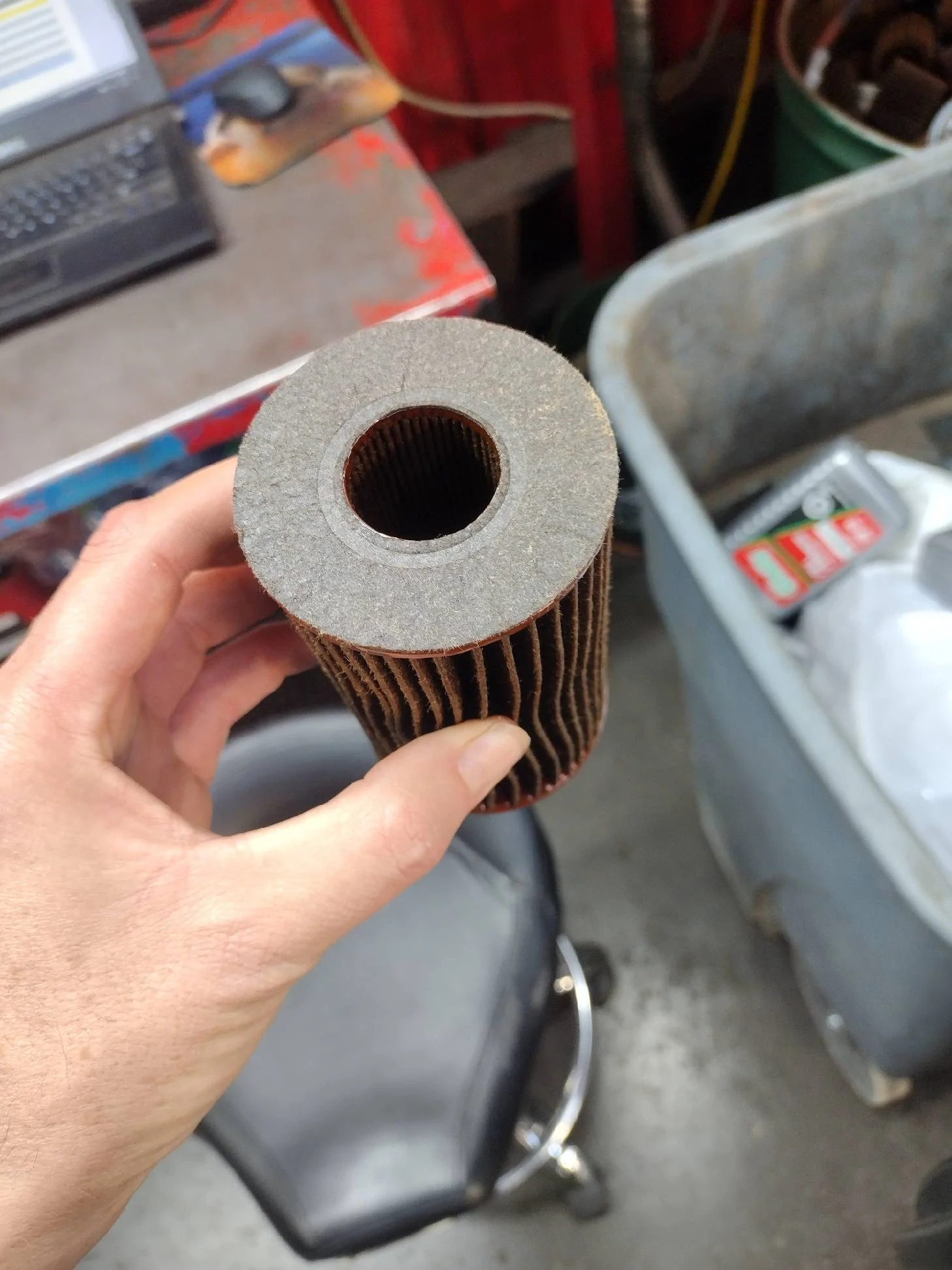

Well, they said it was due to having a WIX brand oil filter on it and denied the claim. So there is that (complete BS).
When I asked for a photo of it, they provided me with this:
Jeep Wrangler JL 2.0T P0017 P000A IMG_20230201_165752630
I countered that it uses a spin-on and not a drop-in, and they said they accidentally sent a photo of the wrong one. They did not have and could not tell me what was on it ("already trashed").

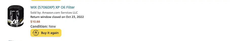

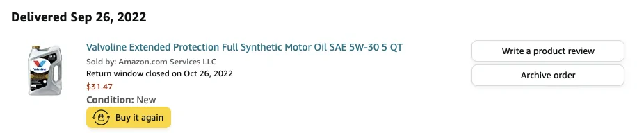

I took it in with a WIX 57060XP, because I have a receipt for when I purchased it back at the end of September along with 5qts of Valvoline Extended Protection 5W-30 full synthetic for the last oil change.

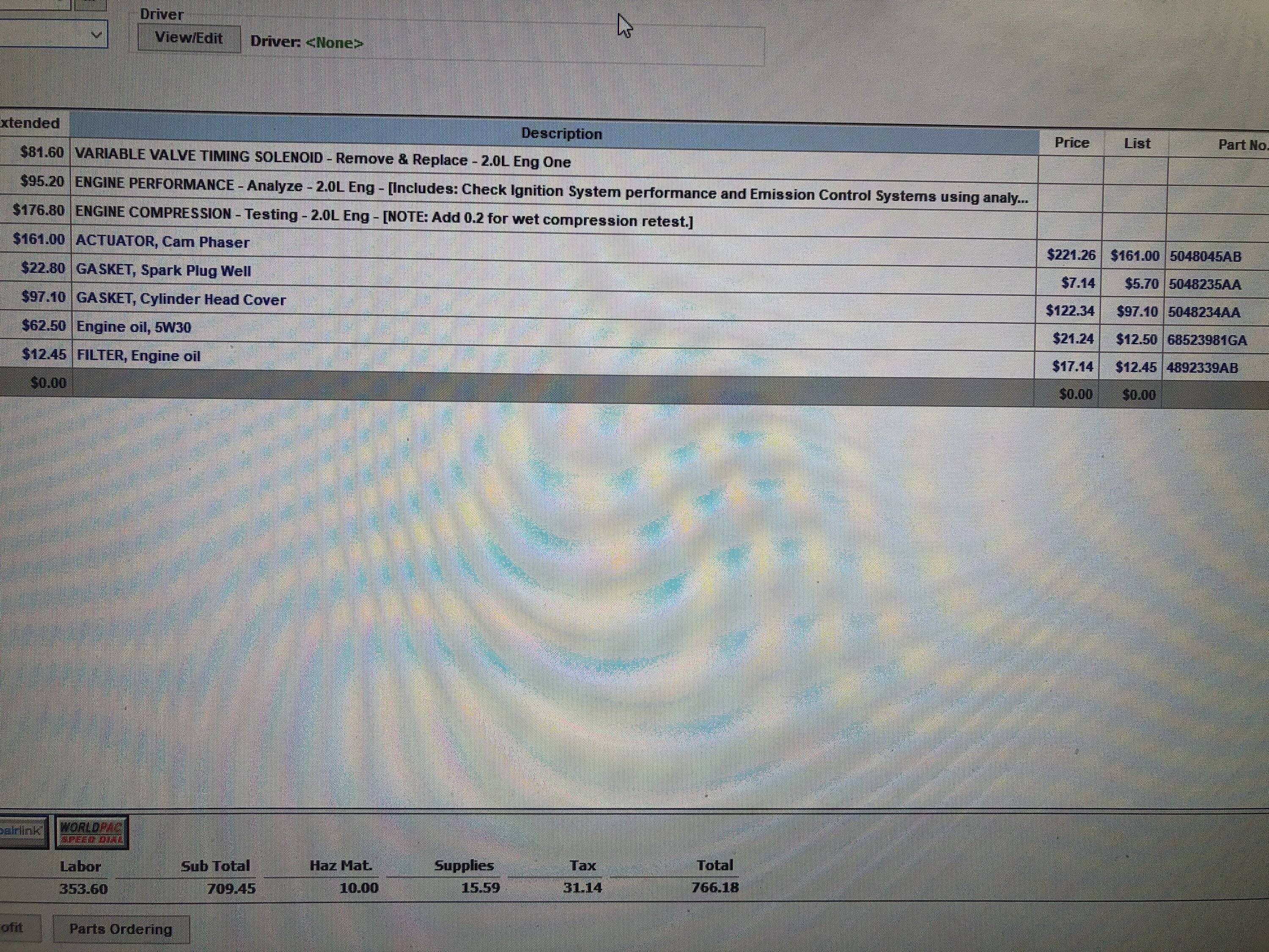

I suspected as much. I'm discussing it with the service advisor, since it's back in the shop.
Jeep Wrangler JL 2.0T P0017 P000A Screen Shot 2023-02-10 at 12.19.38

Oh dude they’re just guessing and throwing parts at it. Why was the bill so much exactly? How did they break down the labor? If you’d rather, you can DM me and I’ll go over it.
