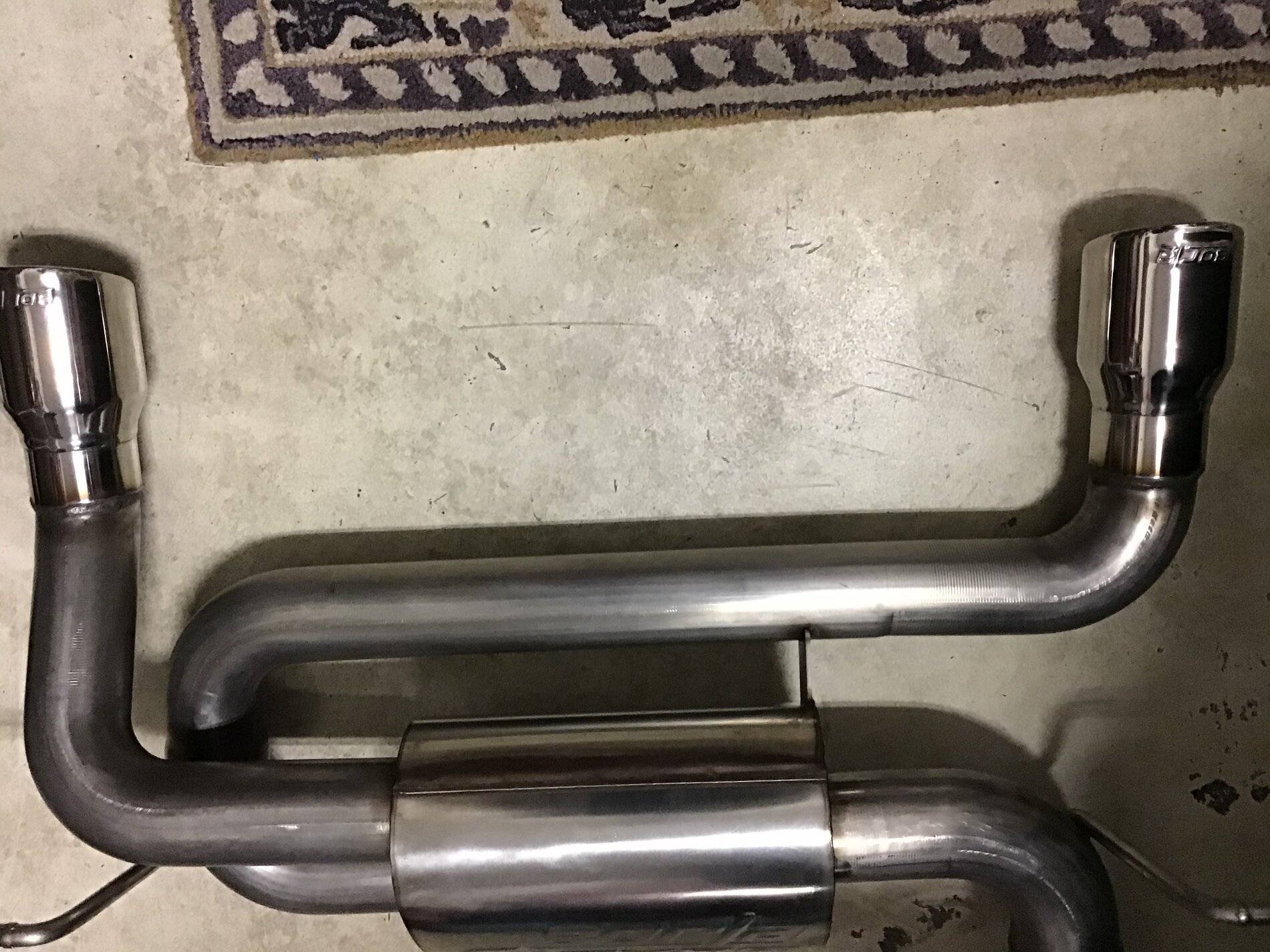

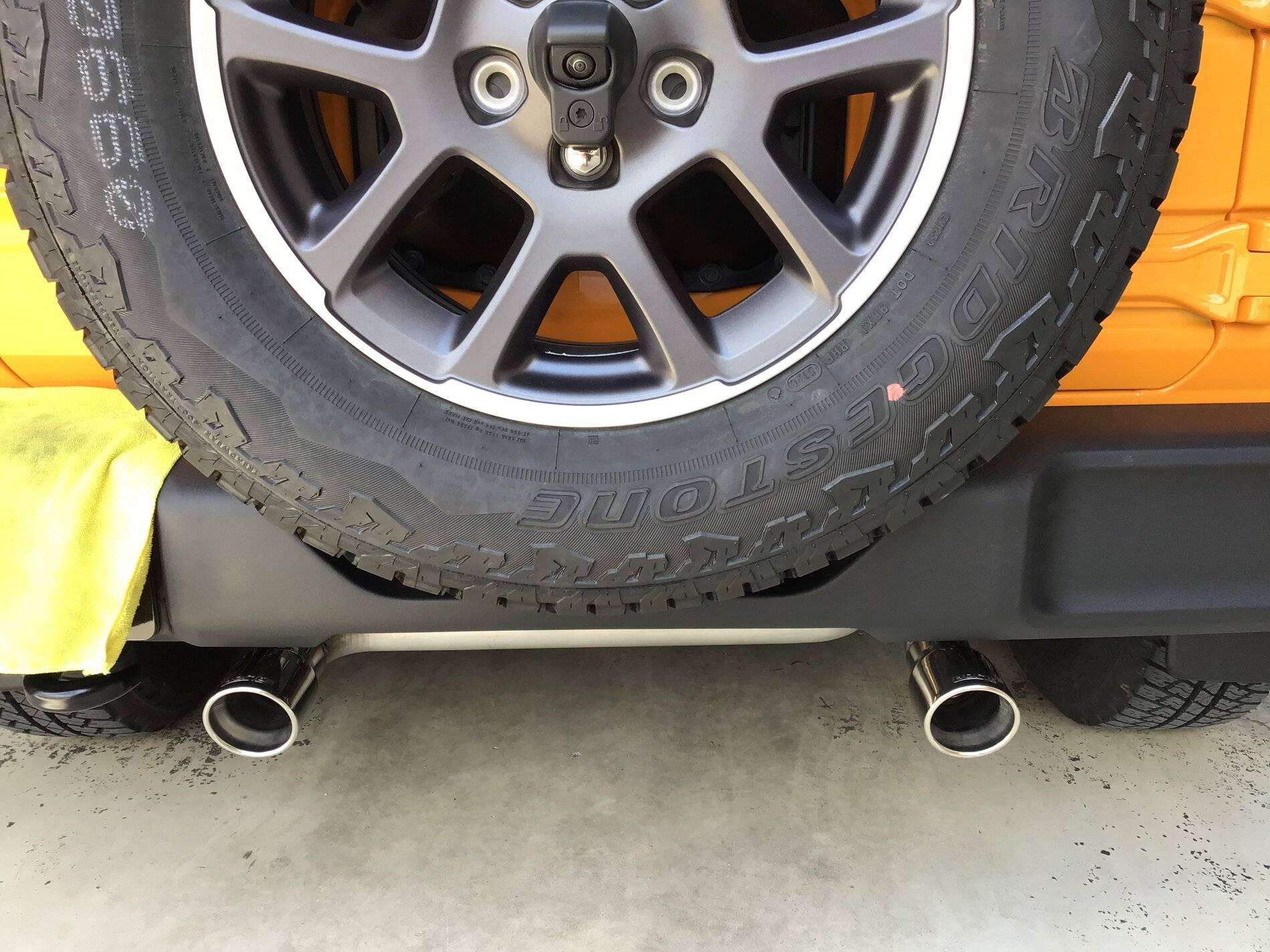

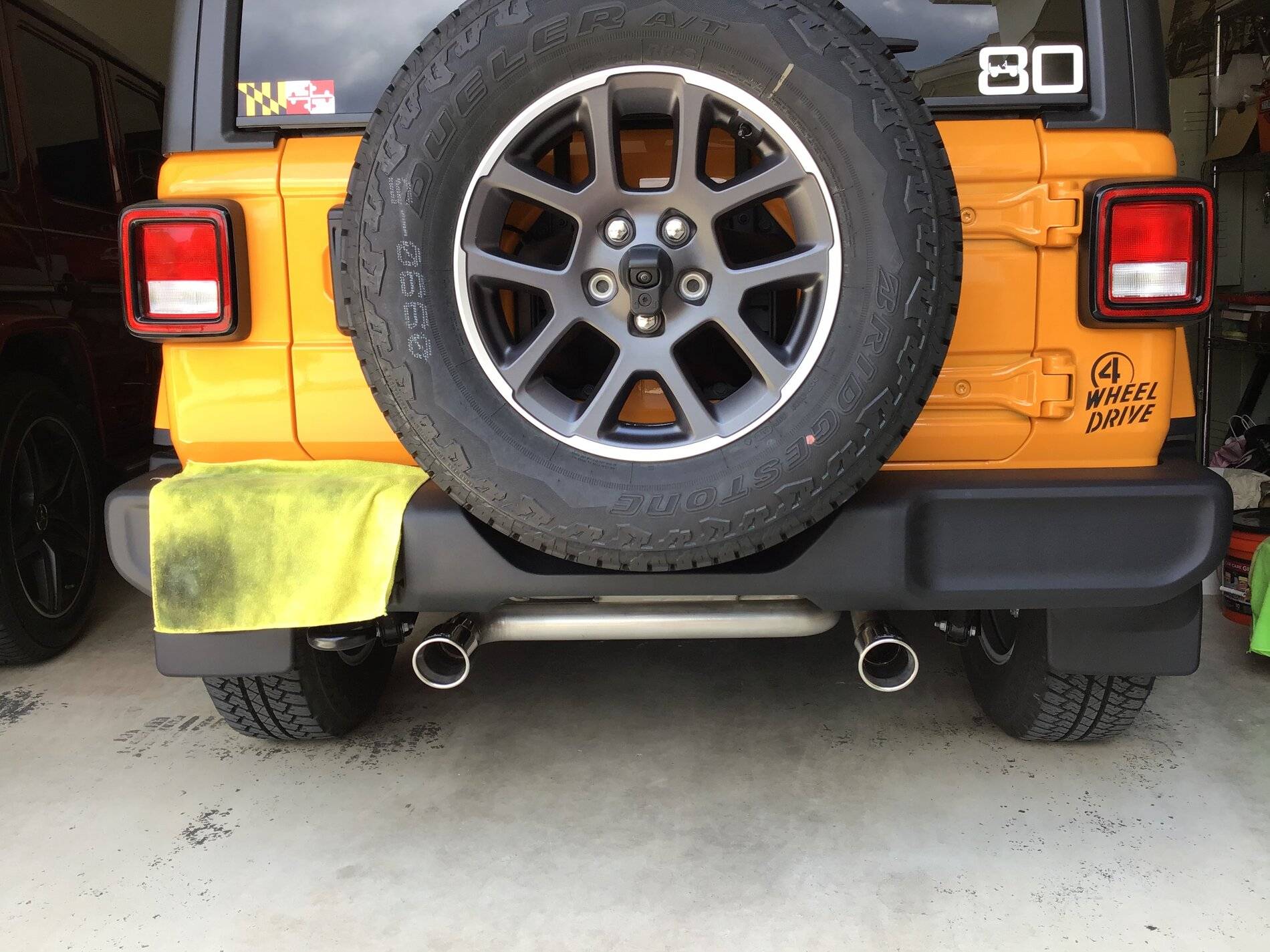

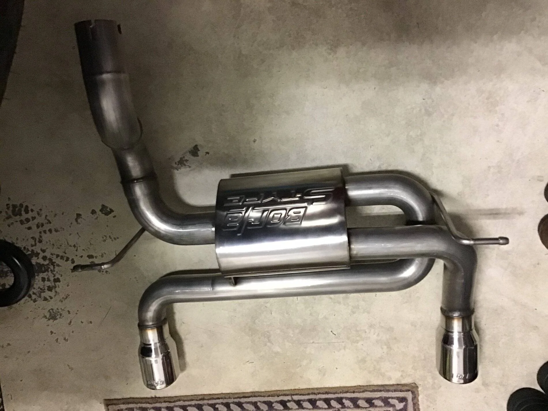

Installed today.
Borla S-Type Axle-Back. Easy install. Outstanding quality.
Sounds great. No stupid tuba under water/flatulent sound.
I can now hear upshifts. Love this axle-back because it’s actually a single exit exhaust (unlike all other dual exit exhausts/tips) with separate dual tips.
The benefit is no loss of torque at low rpms, whereas dual exit exhausts can lose some low rpm torque, but make more power at higher rpms. No concern to me b/c Wranglers aren’t performance machines.
Stock exhaust weighs 25.2 lbs.
Borla S-Type weighs 17.4 lbs

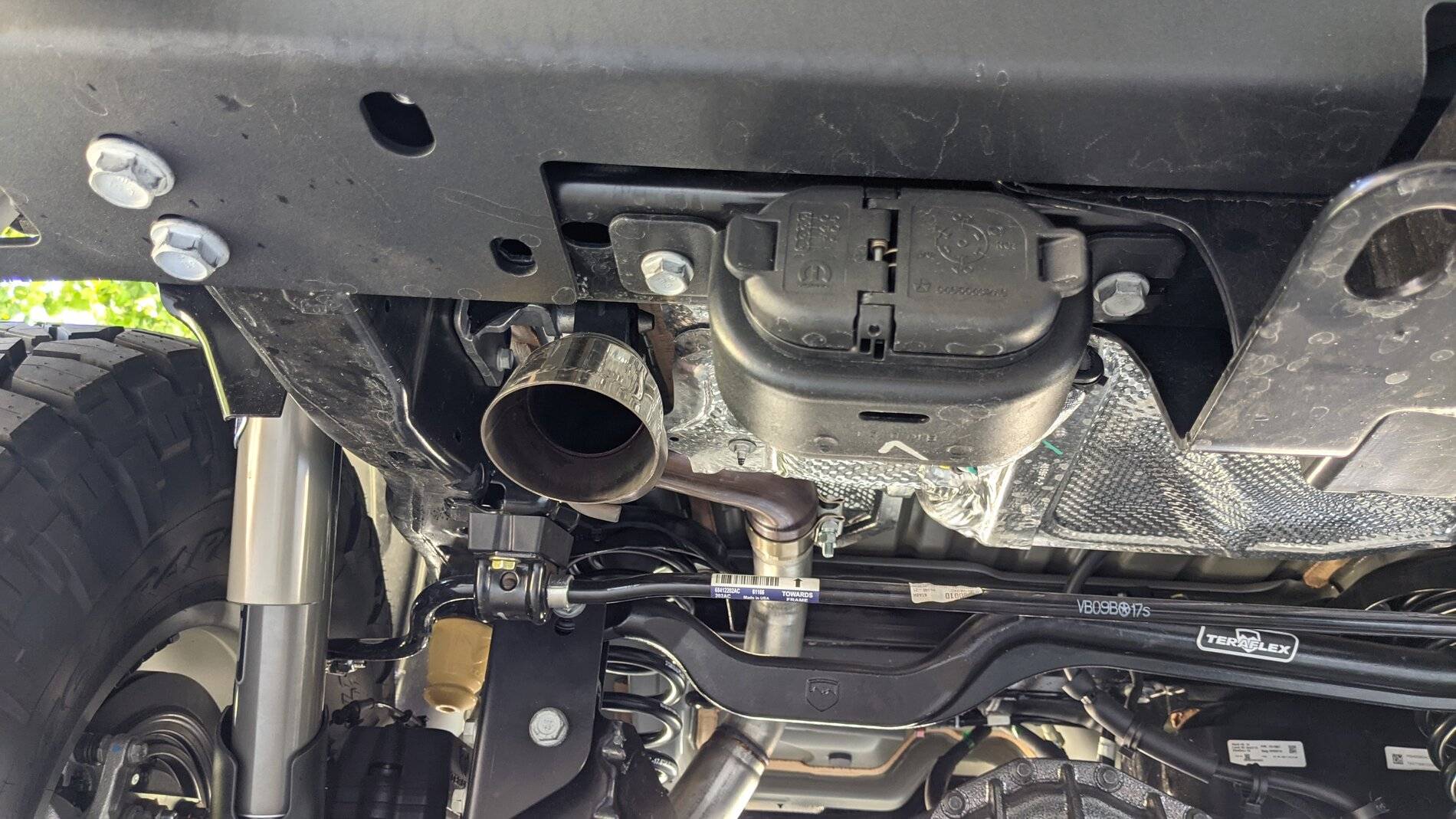

I bought the AFE rock basher for the v6 because it is 3" pipe, short and out of the way. Cut the 2.75 ball flange off the stock exhaust, cut the 2.5" ball flange off the rock basher and welded to 2.75 flange to the 3" pipe. Its pretty quiet, deep tone, way better than the muffler delete, good sound and just enough to know its there

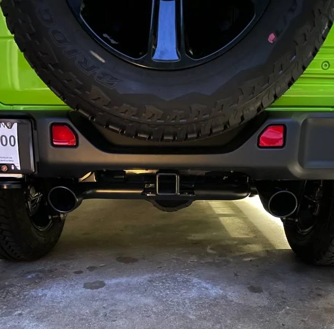

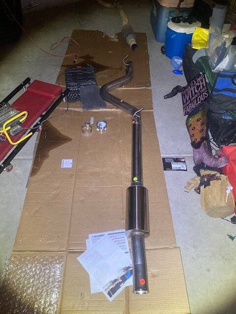

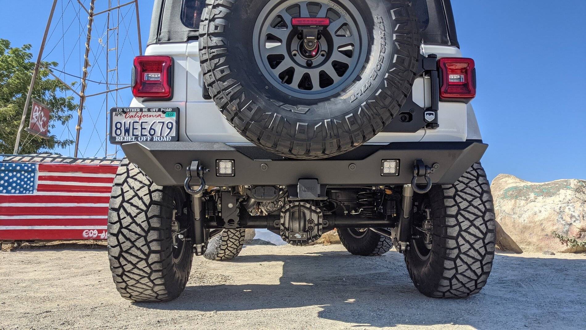

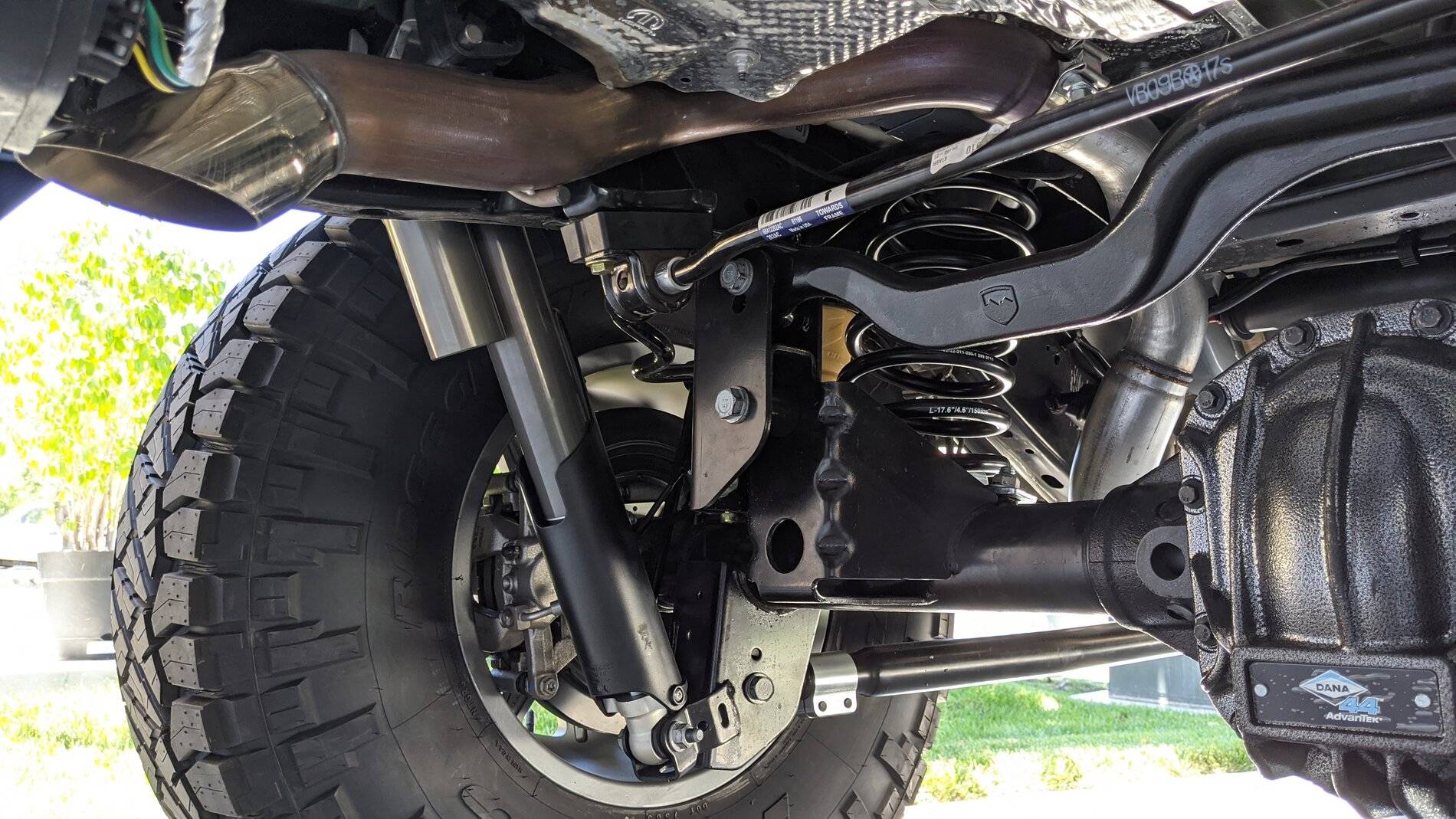

Didn't see anyone in this thread having an AWE Trail Edition yet, so I'll add my impressions of it. This is replacing a Dynomax muffler delete pipe.
My 17 yr. old son installed it by himself last night. Right away, he was impressed by the quality of the welds, fit, and instructions (He takes auto shop and welding in HS). He had no issues with the install, the parts are labeled with color coded stickers for easy assembly. The system cleared everything just fine (another user reported clearance issues at track bar and sway bar, but he's using a rear track bar relocation bracket....I'm not) once it was on the hangers and all adjusted.
Sound wise, he likes it a lot better than the muffler delete pipe. Whether at an idle or accelerating, It's deeper but not as annoying and absolutely no drone (didn't have any with the Dynomax either). He thinks it's a bit quieter too. I wasn't a big fan of the Dynomax muffler delete, I tolerated it since I didn't want to deal with the stock muffler getting beat up on the trails.
The quality of the system is first rate.....you definitely get what you paid for! The price is pretty steep ($599, but got it for $570 through Northridge), but it should last for a very long time.
This system is a great compromise for those not wanting to be dragging a full muffler on the trails vs. the typical muffler delete system.

I wish they would make that in a stubby rock basher turndown before the axle style! Looks like a nice system.

It exits in the same location as a muffler delete pipe. I have very little worry that the tailpipe will get hit.
On my TJ, I had an exhaust which exited in front of the rear axle. Wasn't a big fan of it cause of the noise right under the cab. I much prefer how these muffler delete systems exit out the rear, yet are tucked up high.
