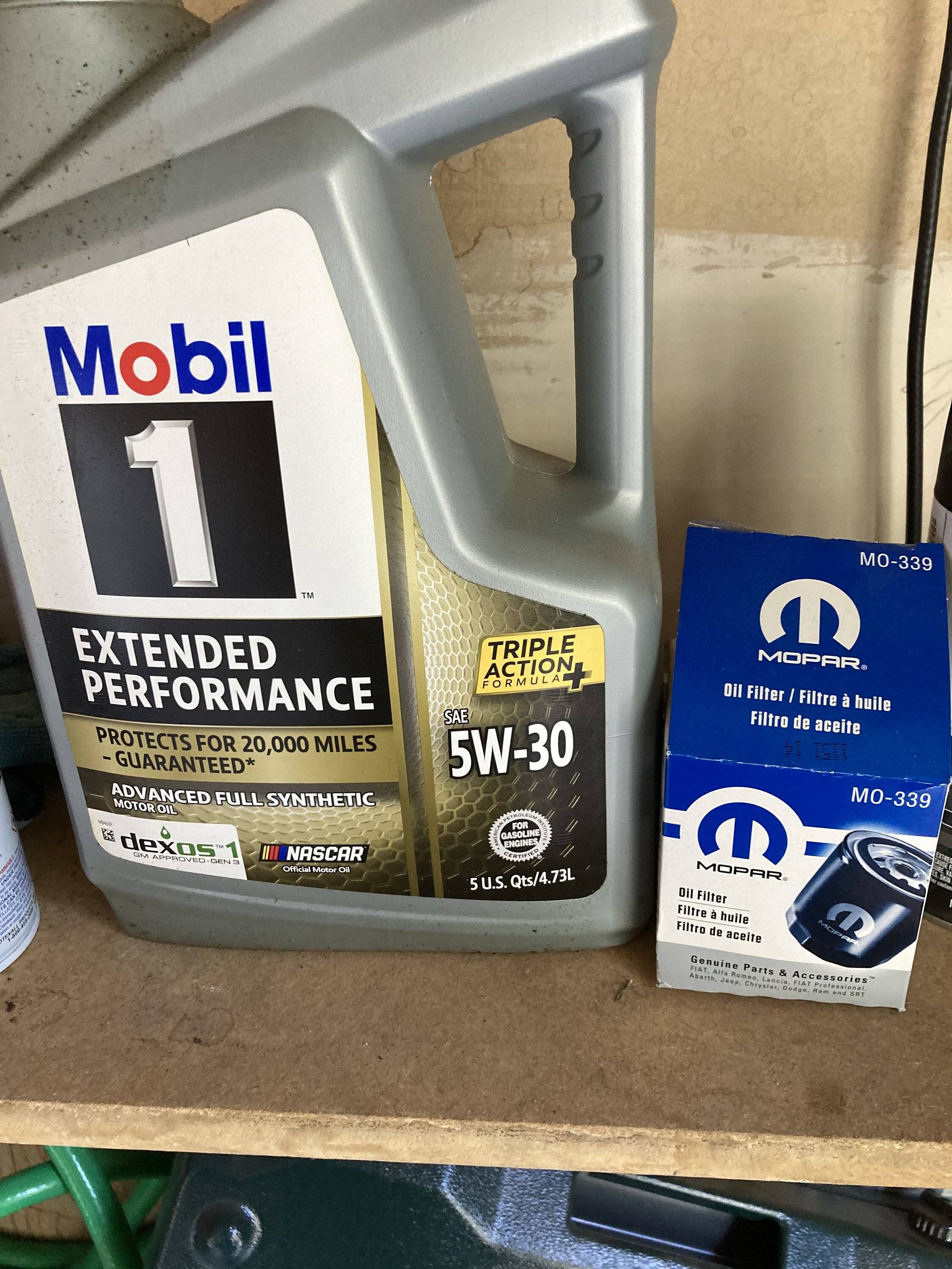

I just hit 25k miles and have been changing the oil every 5k miles. This is the exact oil and filter. It did start after I started using Mobil 1, and before that I was using the free oil change from the dealership. And I did those every 7k miles.
Gotcha, thanks for sharing. I also use the Mopar filters but use Pennzoil Platinum for oil, it also meets the Chrysler spec and I learned here that it's the factory/Mopar oil.
I don't think it makes any sense to go even shorter than 5k intervals, but maybe your use case requires it. Hopefully someone smarter than me will chime in with some insight into your issue.
While correlation does not always mean causation maybe try Pennzoil Platinum on the next couple changes and see if there's a difference. Sounds like the only thing that changed when your noise started was the brand of oil, though it doesn't seem a likely cause.
Good luck either way and keep us posted!
