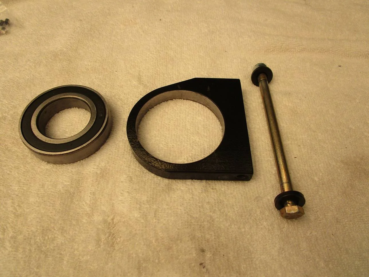

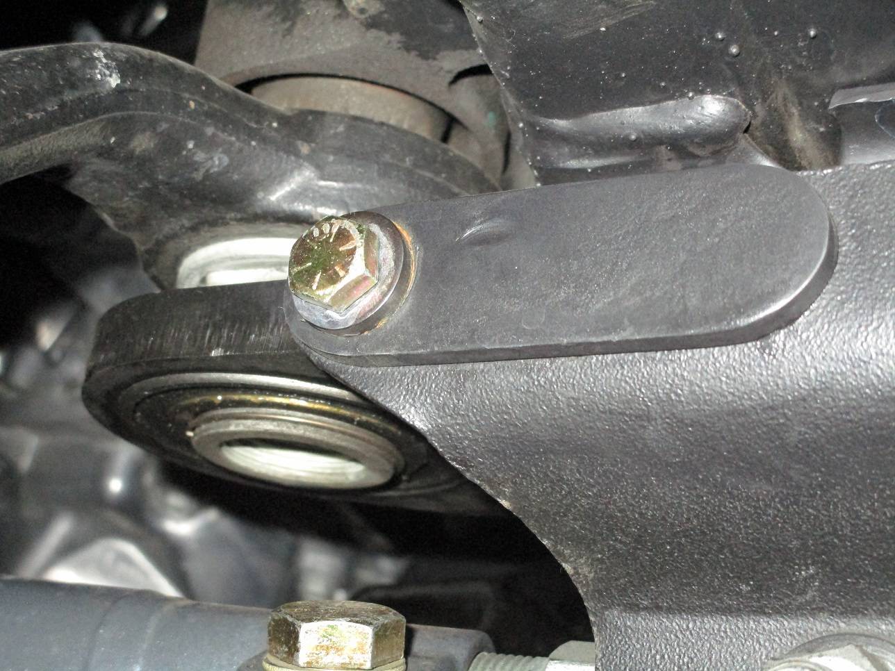

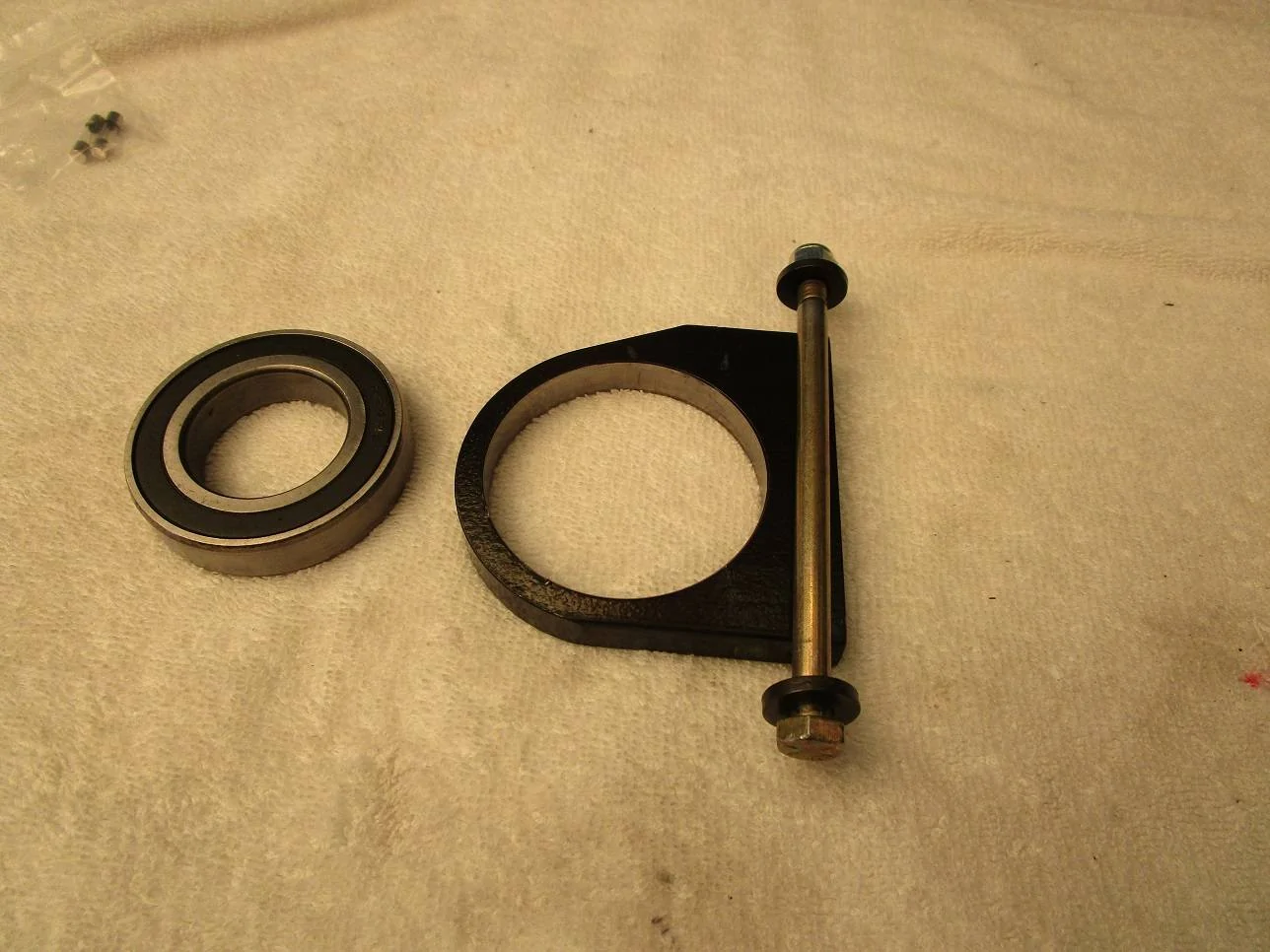

You can do all the mods / track bar/ steering gear box put with out adding a sector shaft brace you will always have play in your steering
I put a steer smart on both my jeeps. Big deference. No more play. Put they all have one flaw
The bolts the hold the bearing housing to the brace will always loosen up no mater how much loctite you use
solution is to throw bolts the bearing housing and adding a 5/16 bolt grade 8 bolt
Then I assembled it on the jeep. Took a 3/16 steel strap with a 5/16 hole and plug welded it to the brace
This eliminates the slot that come on the brace allowing movement
Now it is pinned and can not and will not shift or move
The steering is now super tight and I no longer have to keep checking the two bolts
There are a few different ones available put as far as I know the steer smart is the only one you can throw bolt like I did
The metalcloak looks promising put does not address the weak mounting of the steering box to the frame and I think over time the rivet nuts that they use will loosen up in the frame

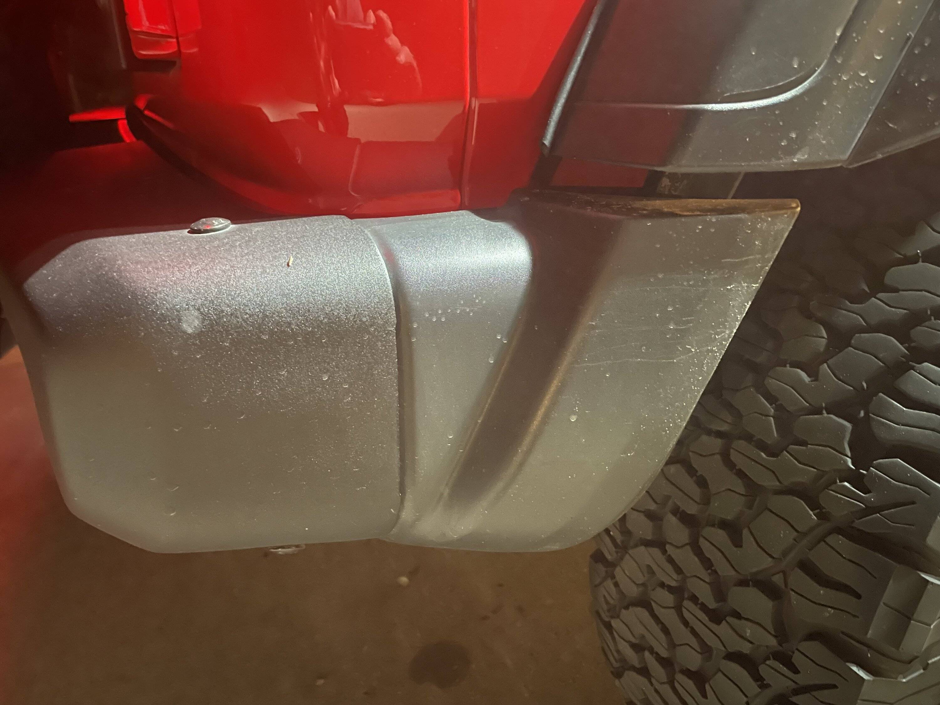

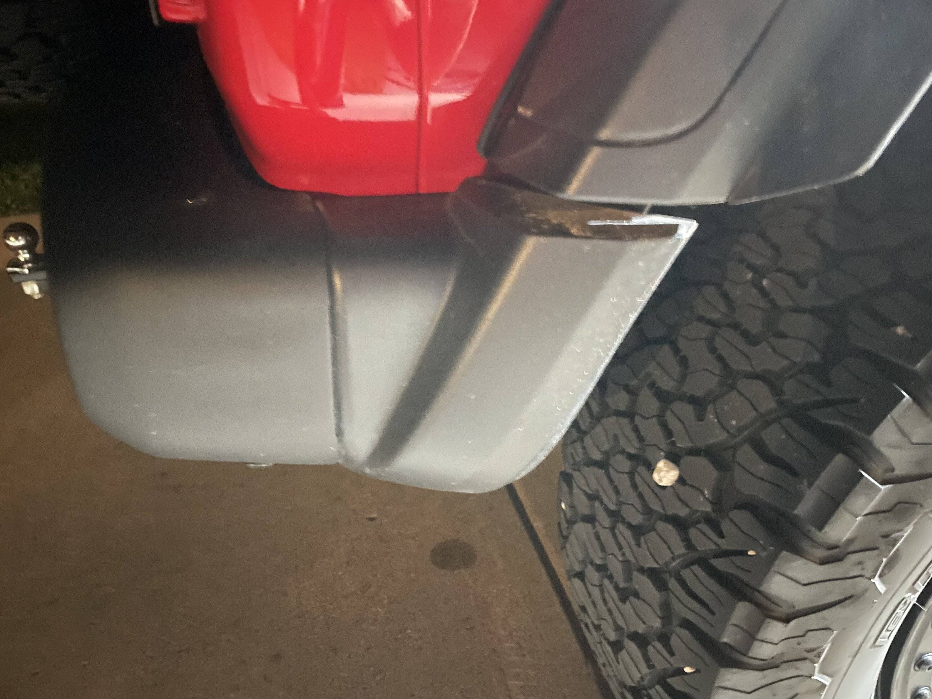

The filler pieces people have referred to are a bumper end cap. Someone has swapped the steel bumpers off a Rubicon onto your Jeep. Not that it can’t be done, but someone didn’t add the bumper end cap to the rear bumper. Maybe because of cost. Maybe because the Rubicon uses a different fender flare so maybe the end cap wouldn’t line up with the fender flare. I like the Moper steel bumpers. I swapped some take off Mopar steel bumpers that I bought from AEV onto my 2012 Rubicon. Then when I ordered my 2022 Rubicon, I ordered it with the steel bumper group (exclusive to a Rubicon). Anyway the part numbers are as follows:
Right End Cap. 68319212AB ($22.05) or 6ZA86TZZAA ($154.00)
Left End Cap. 68319213AB ($22.05) or 6ZA87TZZAA ($154.00)
I don’t know the difference between the two part numbers besides cost. I looked up the info on www.Moparfactoryparts.com then after selecting the year and model, you’ll have to select Rubicon trim to see the steel bumper option.
I included a picture of what the look like on my 2022 Rubicon.
You may want to consult you Jeep dealers parts department or body shop.
Aaaaah. Ok. Now I see what you guys are talking about. Was lost before. Thanks so much for the info!!

I’d bet the original owner had the Rubi end caps and removed them when they saw how misaligned they looked with the shorter narrower Sport flares. There’s no direct fit PN for steel bumper and non-Rubi flares, but 68298822AC and 68298823AC (e.g., Sahara, some/all Sport S?) may align better with some attachment point modifications. Unfortunately, these also require different closeout panels as well.
20 minutes walking a dealer lot will go a long ways to help you visually familiarize yourself with the different bumper options. While they may all appear to be the same, there are subtle differences which create interchangeability issues. Switching over to longer/wider Rubi flares is probably a better option than investing $ in parts to match your current Sport flares. Good luck ?.
