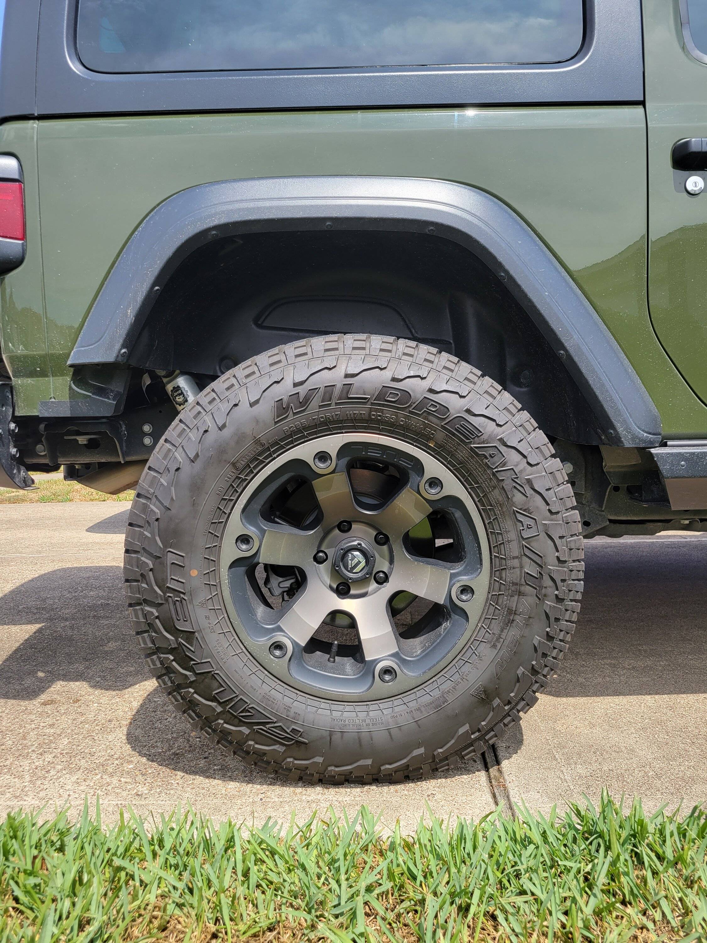

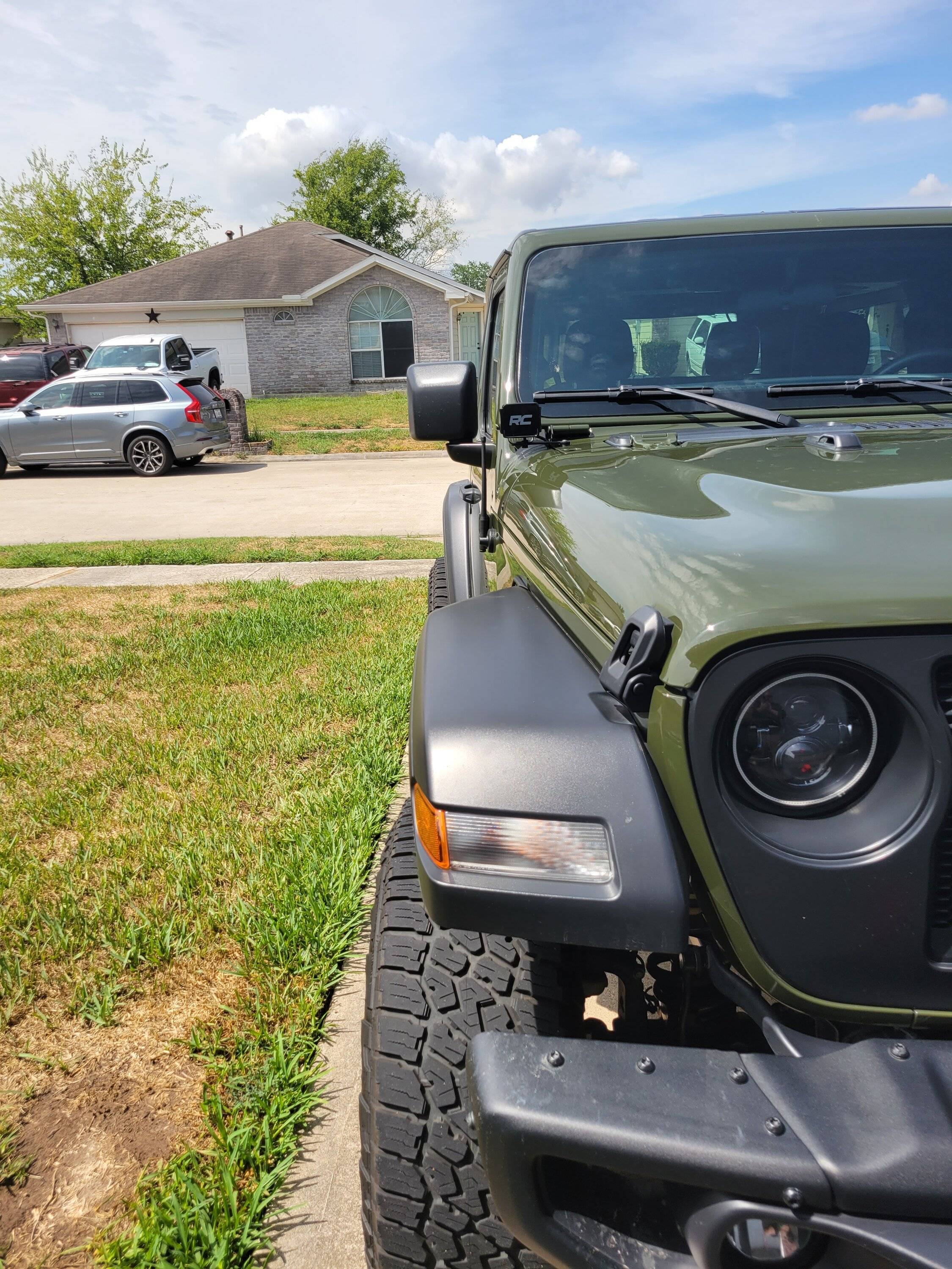

Greetings! 1st time posting on any forum, so please forgive any breaches of decorum. I just got my 1st Wrangler. 2020 JL Sport 2 door, 3.6l auto. 10k miles on odometer. Previous owner did several mods. 33" AT tires on 17" wheels and Mopar lift with Fox shocks being a couple. My plan for this Wrangler is to use it as a daily driver with the occasional beach trip or camping trip. Possibly some light trails. That being said, I have noticed that the vehicle has quite a bit of wander on the highway. I have also noticed that the axles are not centered under the frame (about 1/2" off). I would guess that the Mopar lift is giving me well over 2" (looks more like 3-3.5, but im not sure how to tell, as i dont have stock ride height measurements). My question: Should I just get adjustable track bars and control arms to correct the geometry/alignment on Mopar lift, or would it be worth it to just invest in a more comprehensive kit? Thanks in advance!!

It's likely a Mopar 2", that will give about 3-3.5" on a Sport. You will adjustable front and rear track bars and the Mopar longer lower control arms. Adjustable lower control arms would be better.
I'm not sure if those Fuel Beast wheels are hubcentric. A hubcentric wheel uses the axle hub itself to center the wheel and carry the weight, vs relying on the lug nuts. Lug centric wheels need to have a little extra attention to detail when mounting, to make sure all of the lugs are evenly seated before tightening. Many tire shops just hammer them on with impacts. Double check the torque on all of the lugnuts.
Also, those wheels have an aggressive offset, so after the adjustable suspension components are added, make sure that you take it to a competent alignment shop.
Finally, check the PSI in the tires, just because the sidewall says 65 or 80 PSI max does not mean that you run that much air. For your Jeep, 35 PSI will be fine.
Looks like the guy before you also added the steel bumpers front and rear. You will need to get the proper end caps for the bumper so it blends with you fenders. The Rubicon end caps don't blend with the Sport fenders.
Are there any end caps you recommend? Is this a requirement?
I don't know the part numbers. Not required, just cleans up the flow between the bumper and the rear fenders.
