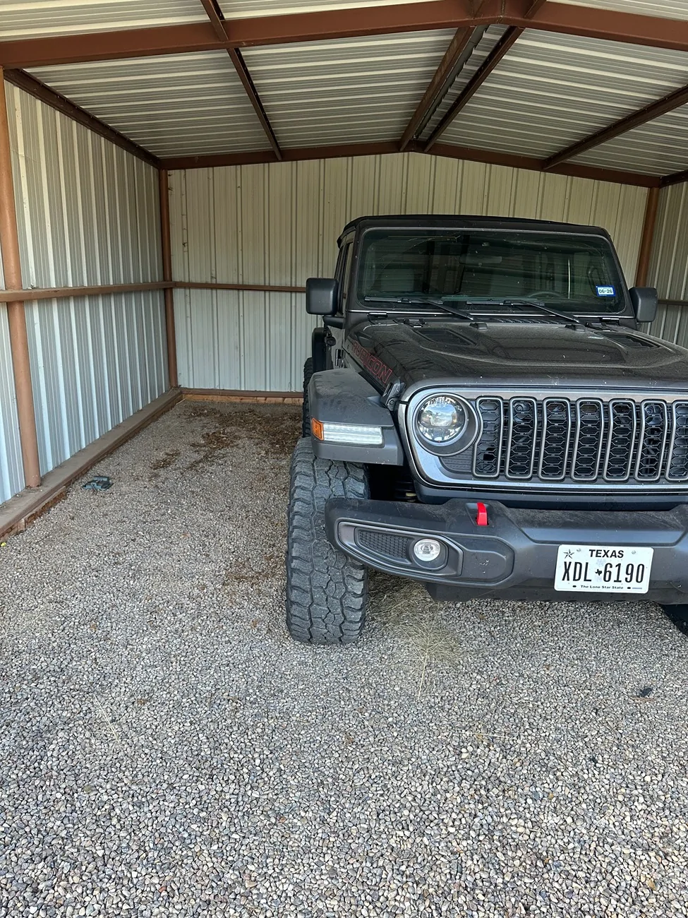

To throw another wrench in your plans, here’s what a 17x9 with 0 offset looks like on a Rubicon.
It’s for a sport so the axles are narrower.
Looks great! Yeah sport has narrower axles so wouldn't poke as much?
Correct. It wouldn’t poke as much. I figured if you saw what the 0 offset looks like with the wider axles it might take some concern away for anyone else considering these with the narrow axles.
