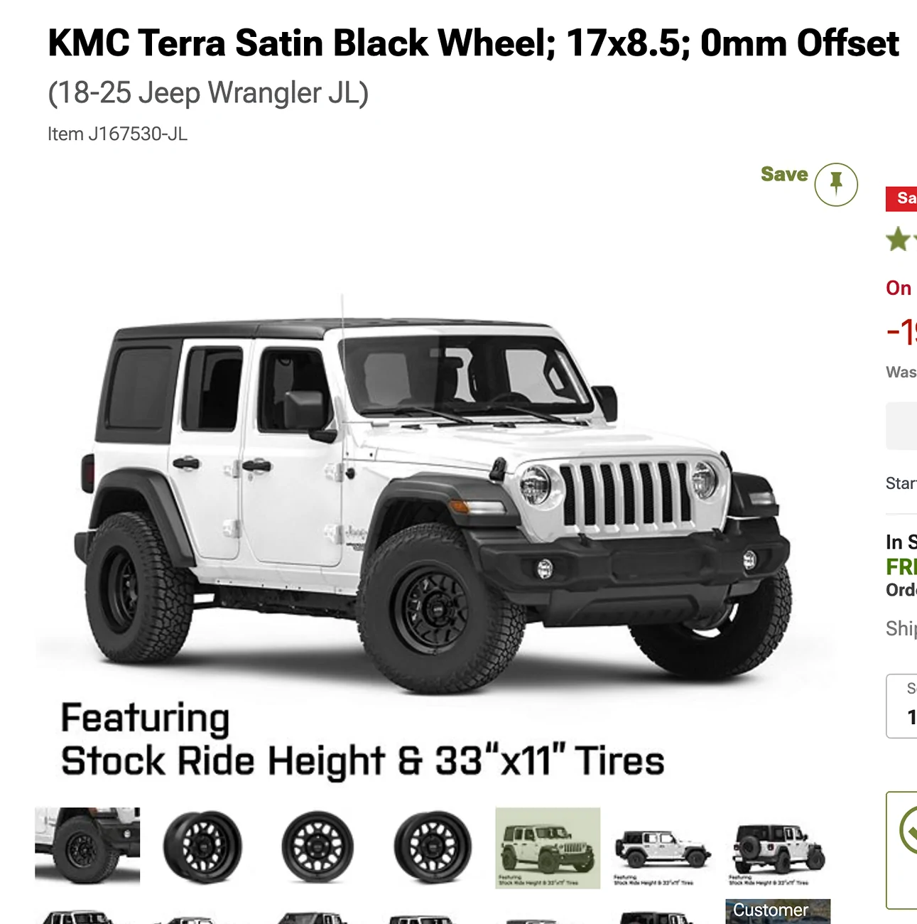

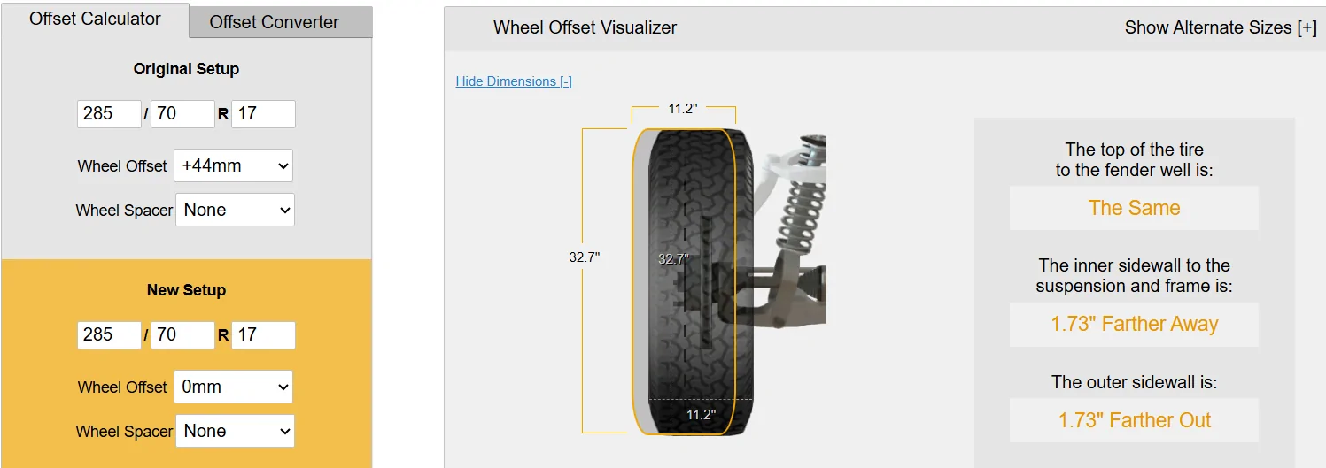

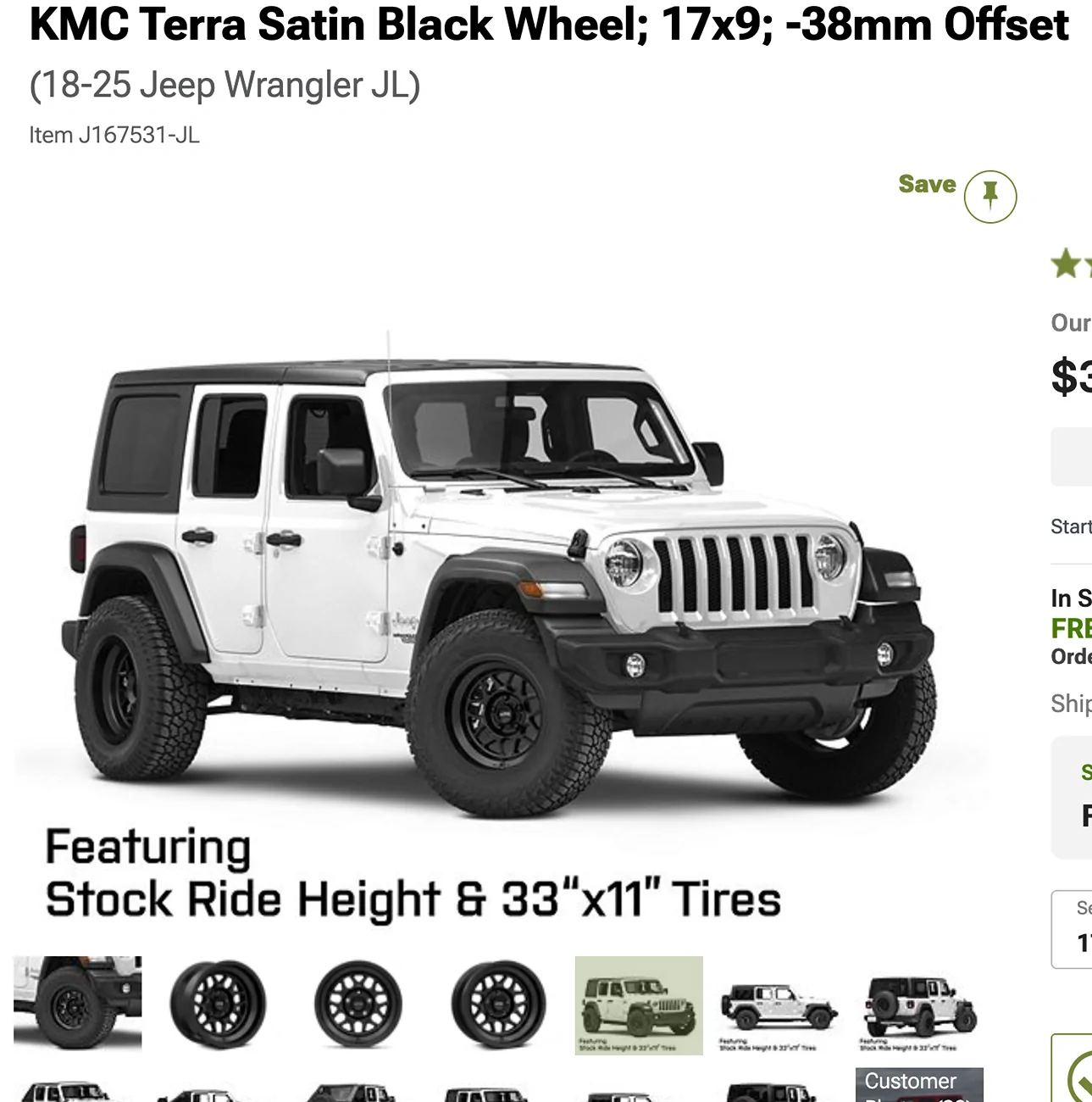

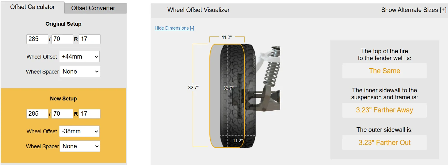

Sorry if this is a dumb question, still learning all this stuff
Should I do a 17x9 wheel or 17x8.5 wheel if I want to upgrade to 285/70/17 tires?
I saw that 17x9 is the most popular size but then read some stuff that 17x8.5 is more rounded and better protection...
It shows that both sizes fit my JL so I guess the only difference will be how much poke there is?
For a 2021 2 door sport with stock suspension, will eventually get rubi springs
Mostly daily driving use and light trails
Jeep Wrangler JL 17x9 vs 17x8.5 wheels Screenshot 2025-09-03 at 8.49.10 PM
Jeep Wrangler JL 17x9 vs 17x8.5 wheels Screenshot 2025-09-03 at 8.48.55 PM

-38 is a lot of offset for that small of a tire, hard for me to envision on the narrow axles, but make sure you see one before ordering.
0 offset vs stock:

-38 offset vs stock:

8.5" vs 9", not really going to notice a difference. 0mm vs -38mm, that is going to be noticeable. Given the two choices, I'd pick the 8.5".
