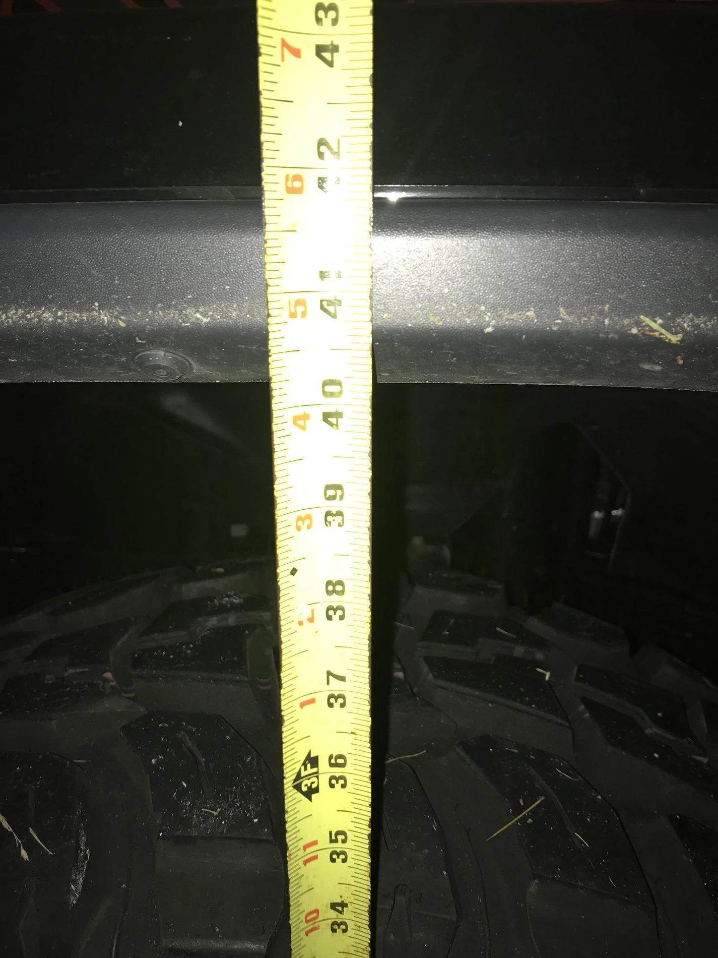

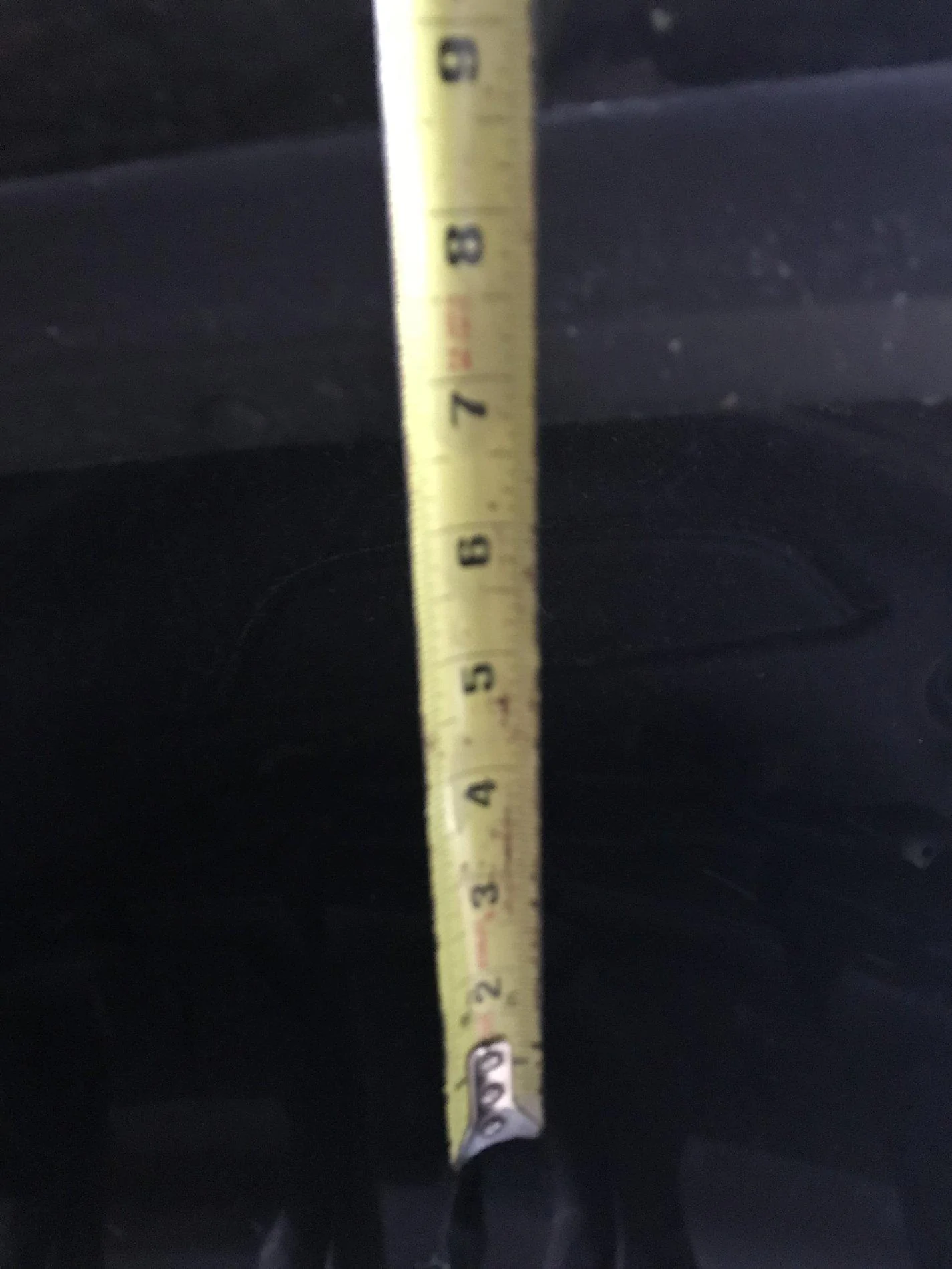

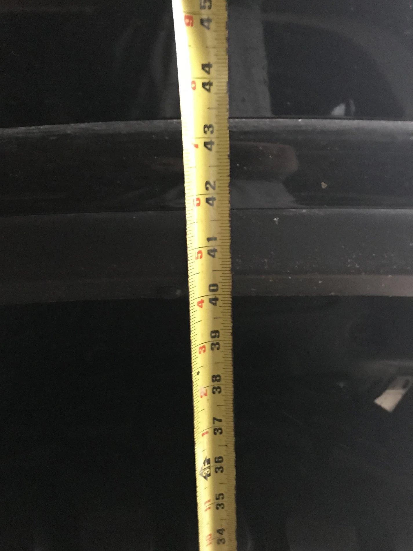

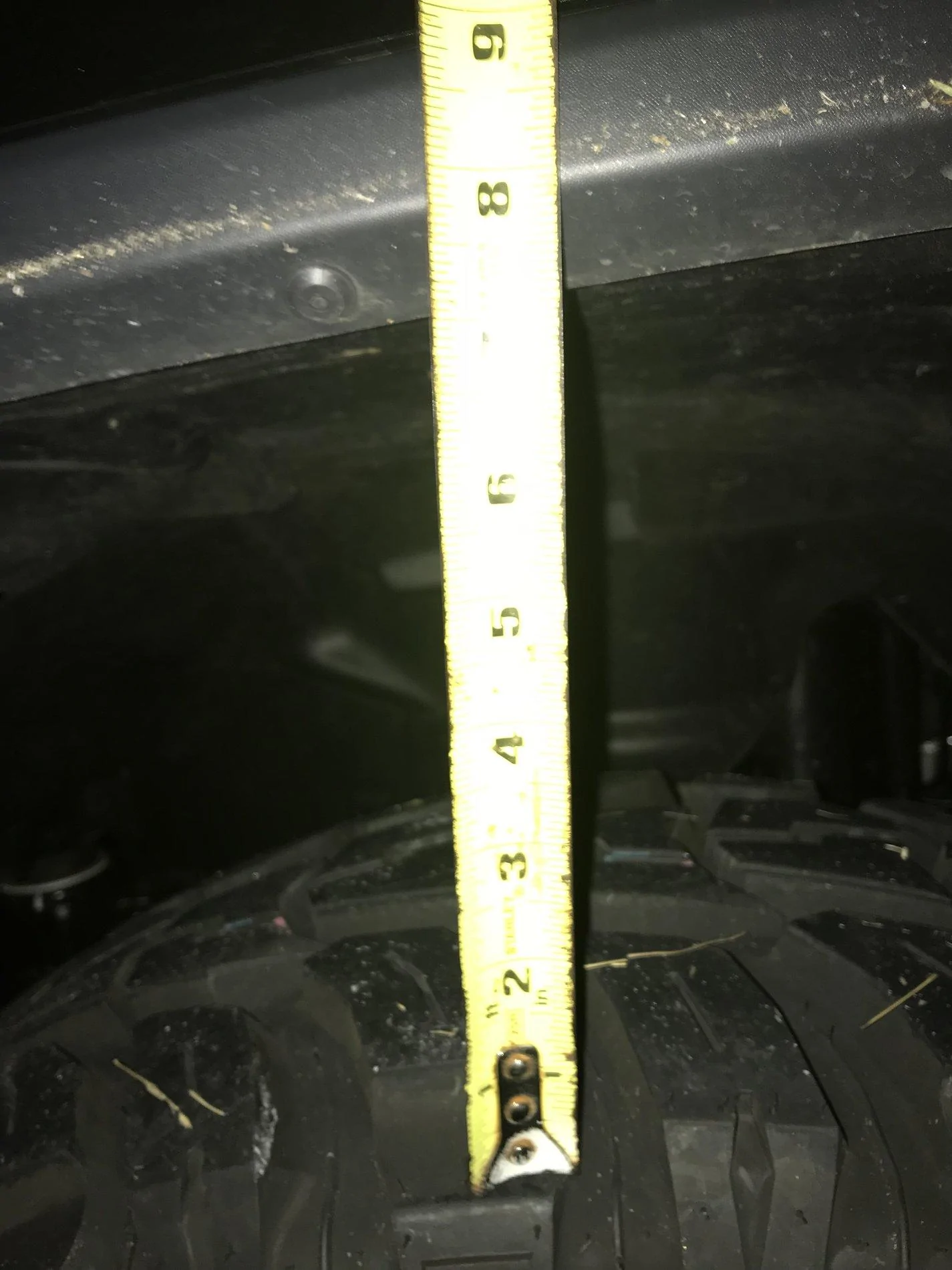

Here are my measurements as of now. Stock suspension with stock wheels and 35 inch Khumo MTKL71s
I measured from the ground and straight up the center of the wheel/tire until I hit the flare. the "opening" is the space between the top of the tire and bottom of the flare.
Front ground to fender - 40.75 inches
Front tire to fender "opening" - 8 inches
Rear ground to fender - 40.25 inches
Rear tire to fender "opening" - 7.50 inches
Looks like I have 1/2 inch of rake so the 1.5/1 should be perfect.
Delivery is supposed to be tomorrow. I will measure the spacers and then measure the lift height once I get it on (I assume the lift height will be the spacer height but you never know)
As I mentioned, I will figure out how to post pictures when it's done. Hopefully the wife will help me LOL
