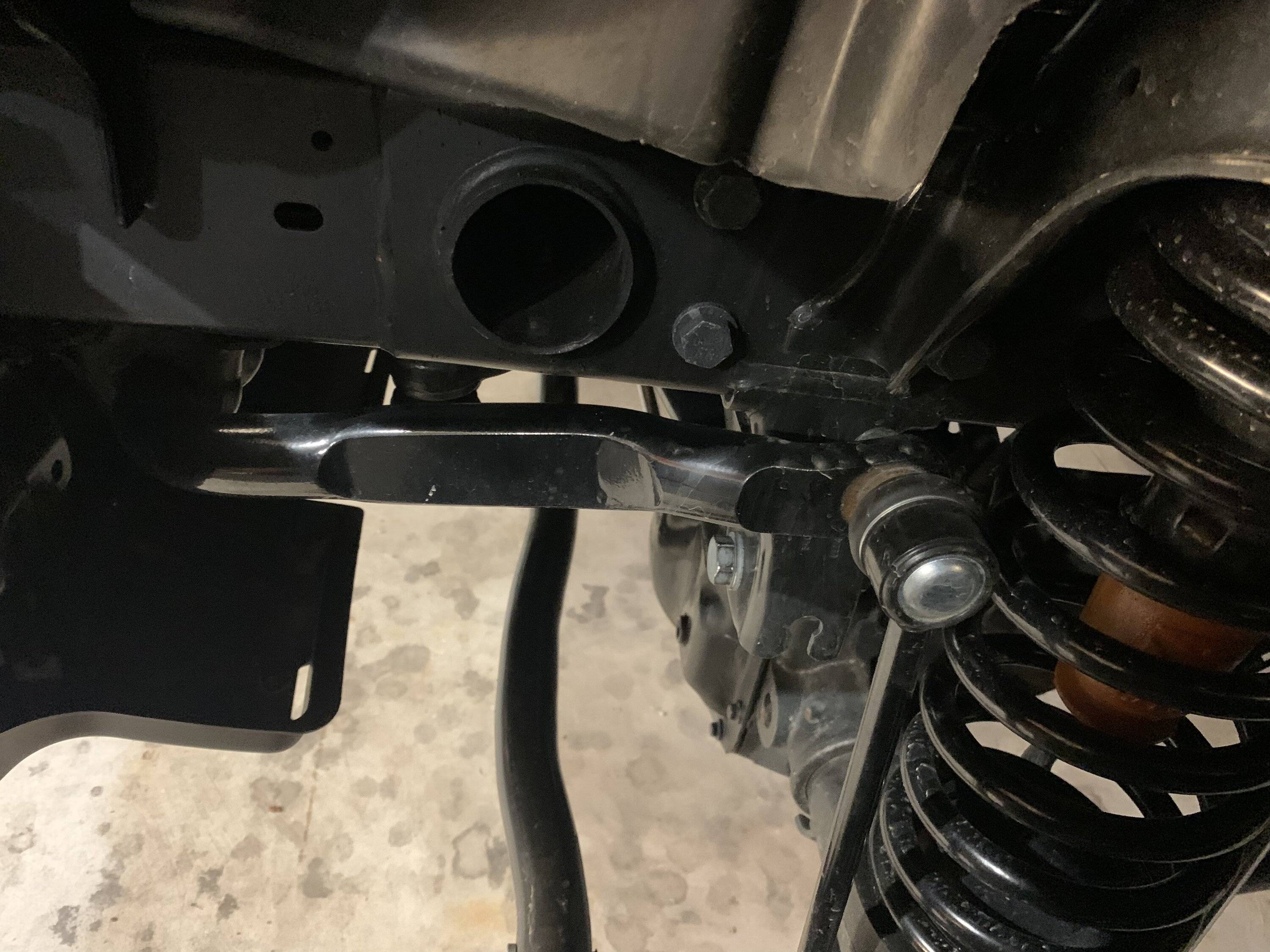

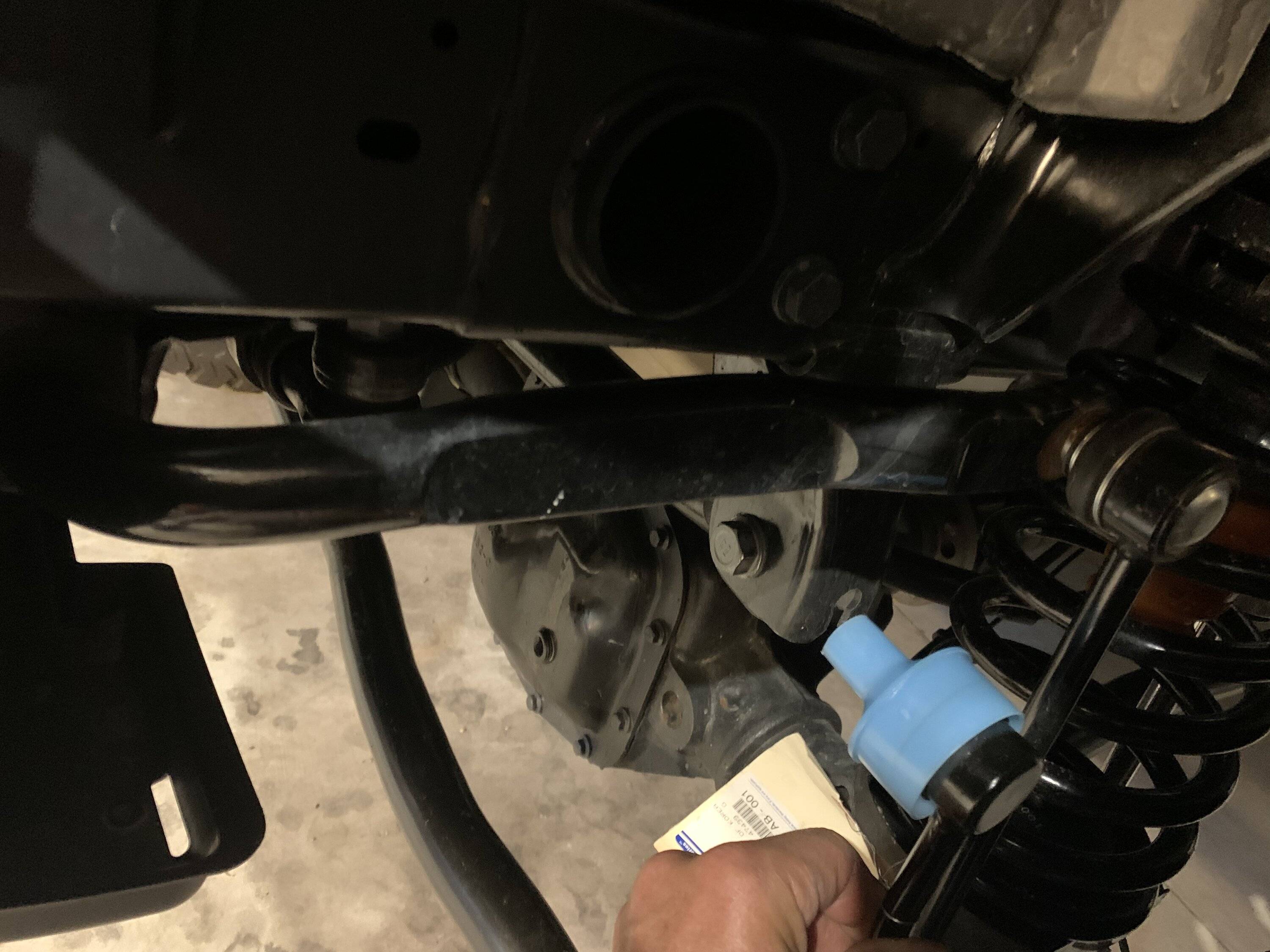

So here’s my dilemma, when I took off my Teraflex 2.5” spacer lift and replaced with RC 2.5” lift springs I kept the end links from Teraflex on, so I ordered mopar 2” lift end links to replace them but they are 3” shorter,
Hopefully this doesn’t make a difference, here’s a photo of the sway bar with the 10.5” on and the 7.5 mopars next to it and you can see the angle of the sway bar.
Can the sway bar come down a couple inches or not?

IMHO. Leave the TeraFlex ones on. Longer is better. You dont want your sway bar to invert when flexed out.

You want the bar parallel to the frame. Whatever gets you closest to that without going down.

Its on the up side, but pretty close to parallel now, the mopar 7.5” will definitely bring it down to far.
