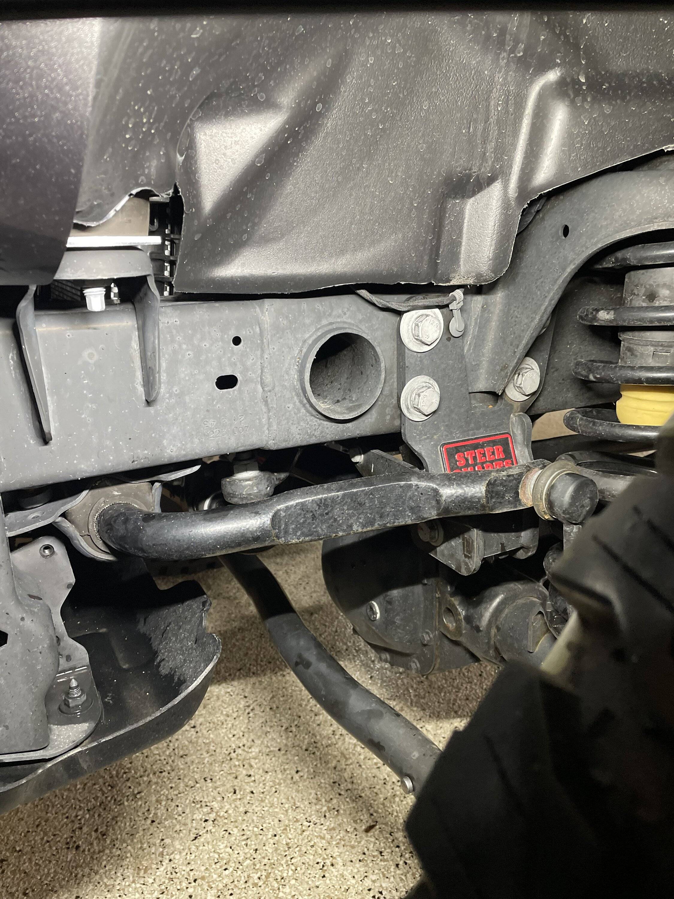

Hello all! I have a 2021 JLUR with a OEM 2.5” lift. My Swaybar is hitting my Steer Smarts sector brace. I mail them some pictures and they said my front end links are too short. Does anyone know what length I need for a 2.5” lift?

Got pic of how it sits now ? And what length are they ?

Steer Smarts recommended 9”+ (sorry I forgot to add that) but I’m just double checking. Links are 7.5” now.

With the Rubi electronic disconnect where you leave the sway bar end links connected when you disconnect the sway bar, you want to angle your sway bar up 10 ish degrees. Just get some adjustable end links then you can adjust them to the height you need….
