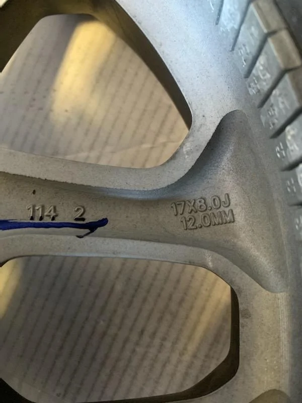

Just wanted to document this for anyone going with a slightly bigger tire and going for the XR wheels and no lift
392 XR 17x8 Wheels
+12mm offset
Tire: K02 315/70/17

Wanted to capture different angels up close and far because that is what usually helps me determine the wheel purchase
