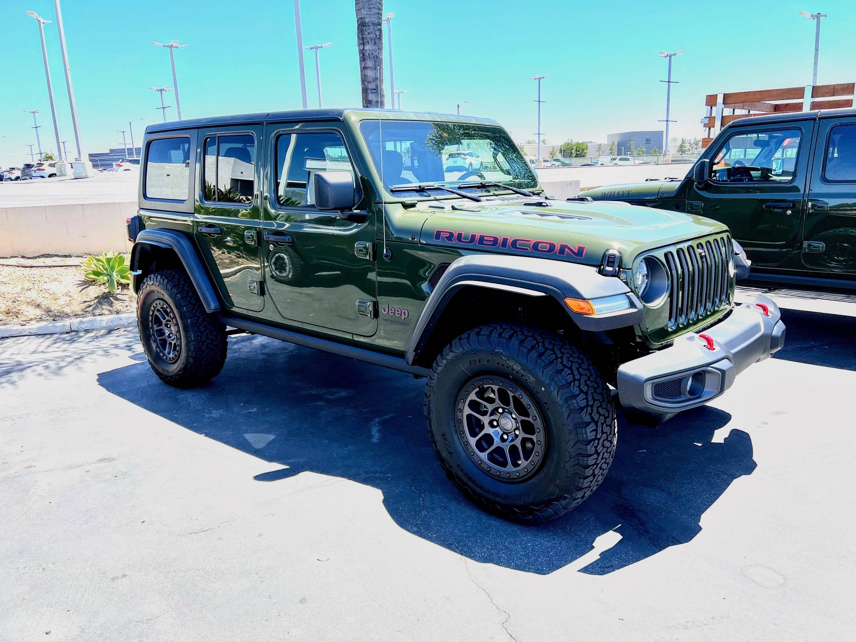

I am. Running 37s - usually run 10 psi offroad but I like the option to go lower.
Pros - seem pretty strong - OEM quality.
Cons - heavy, bolt heads not recessed so get banged up.

You're pic shows more than the 10 bolts on the ring that I have seen, did you have extra bolt holes machined in the wheels?
10 bolt is beauty ring only. When swap to beadlock, there is actually 25. Holes already there under beauty ring.

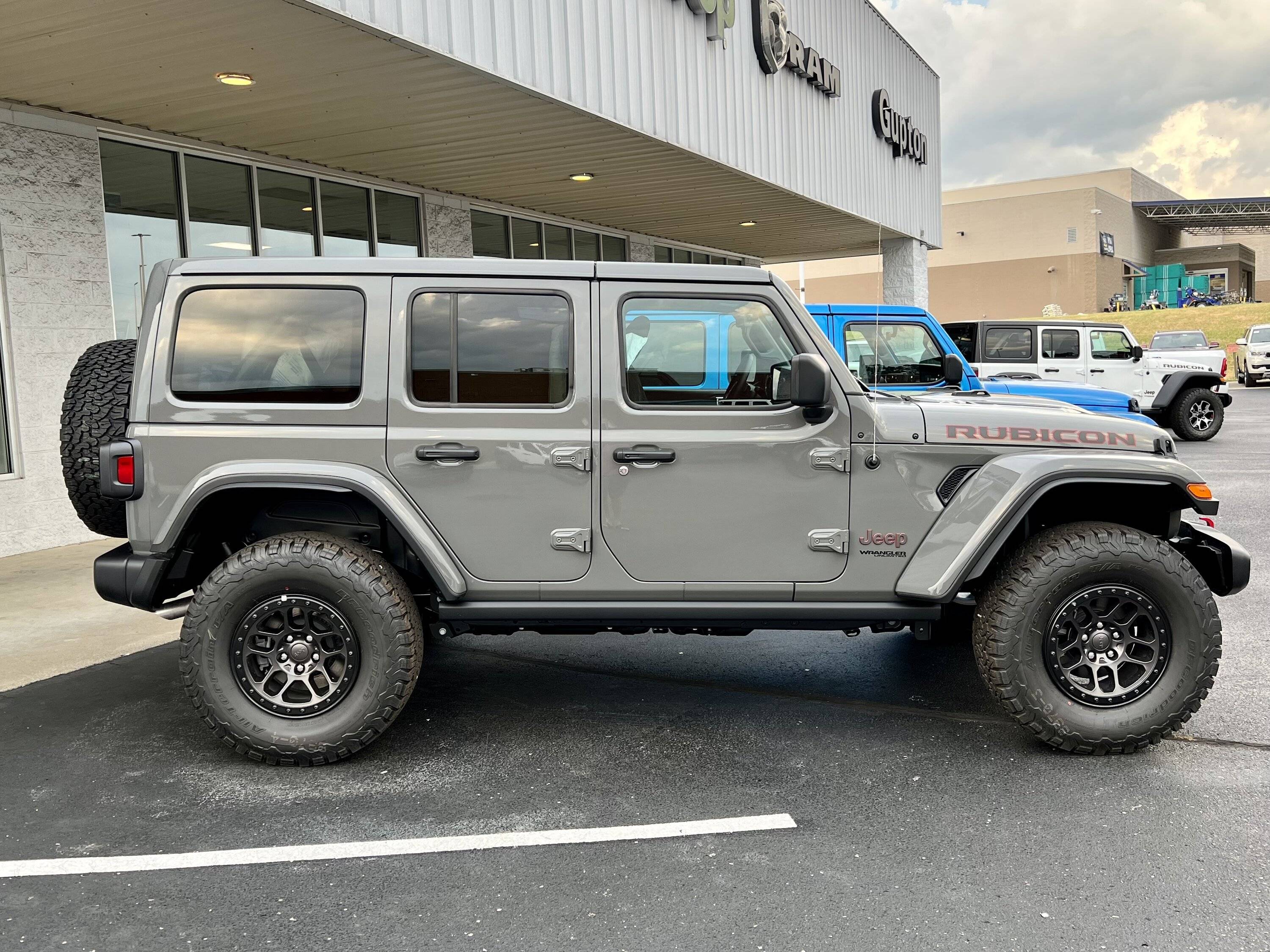

They all do. The beauty rings don’t have all the holes, but the rim underneath does.
my 2021 XR beauty rings have 25holes each, I think it was just the 2023’s that came with 10 bolts in the beauty ring.

For the 2022 MY the beauty rings had all 25
That would be correct, I was guessing he was referencing the newer ones. MY22 had same as yours when ordered.

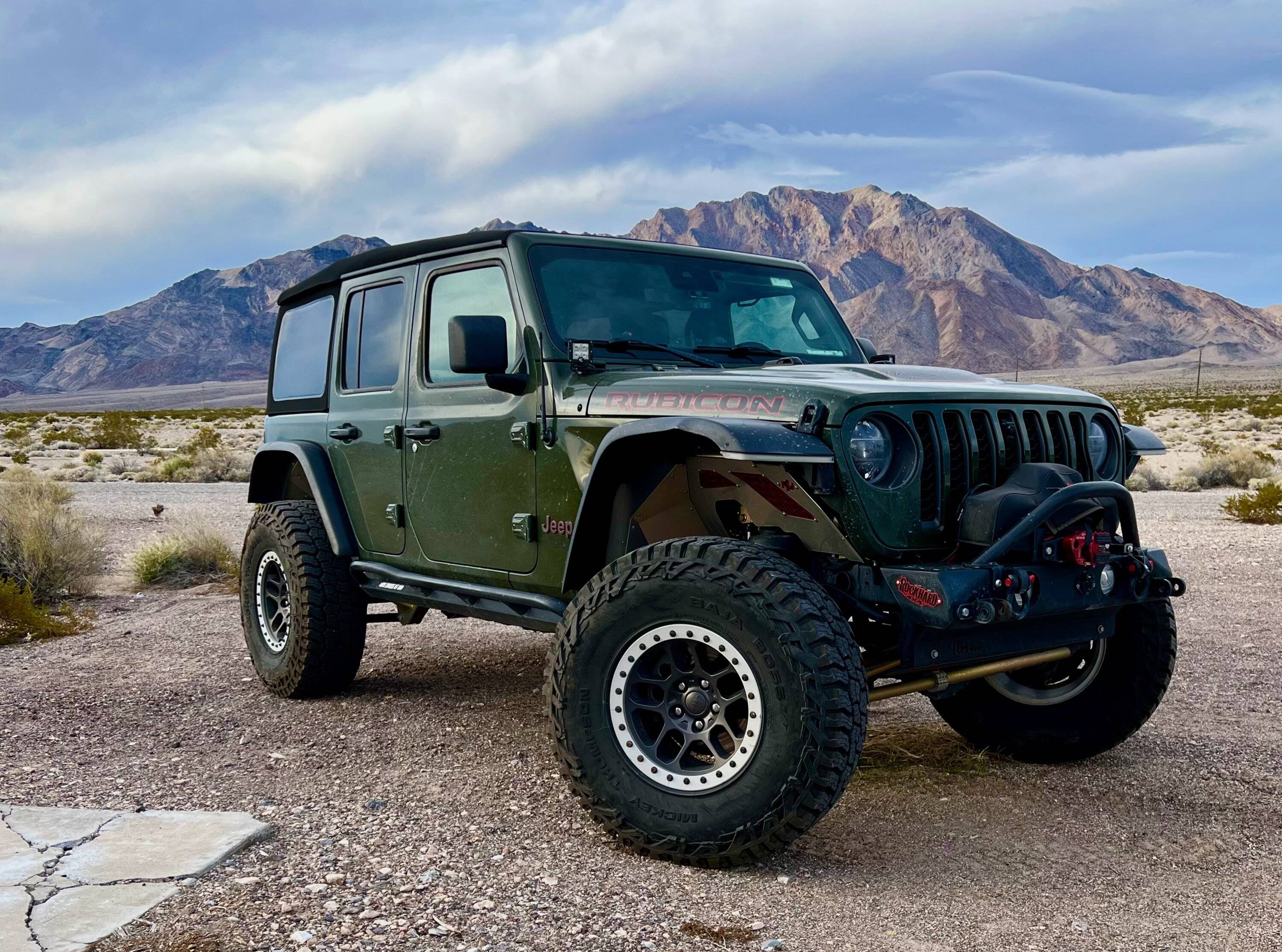

Having run many brands of beadlocks for the past 20 years, I would't use the XR wheels as a beadlock. The threads are cut into the aluminum wheel, which over time will cross thread and lead to deteriorated threads because of the soft metal. My first set of beadlocks were that way. When I took the beauty rings off my XR wheels I was very disappointed.
If you want to make them last, make sure you clean the bolts and the threads in the wheels every time you pull them out. The manufacturer of the wheels I had recommended anti-seize, but I didn't clean them very well when I changed tires and the threads got damaged over time, leading to broken bolts.
I prefer beadlocks with threaded inserts. Currently running KMCs on both my JLs, Racelines on my TJ.
