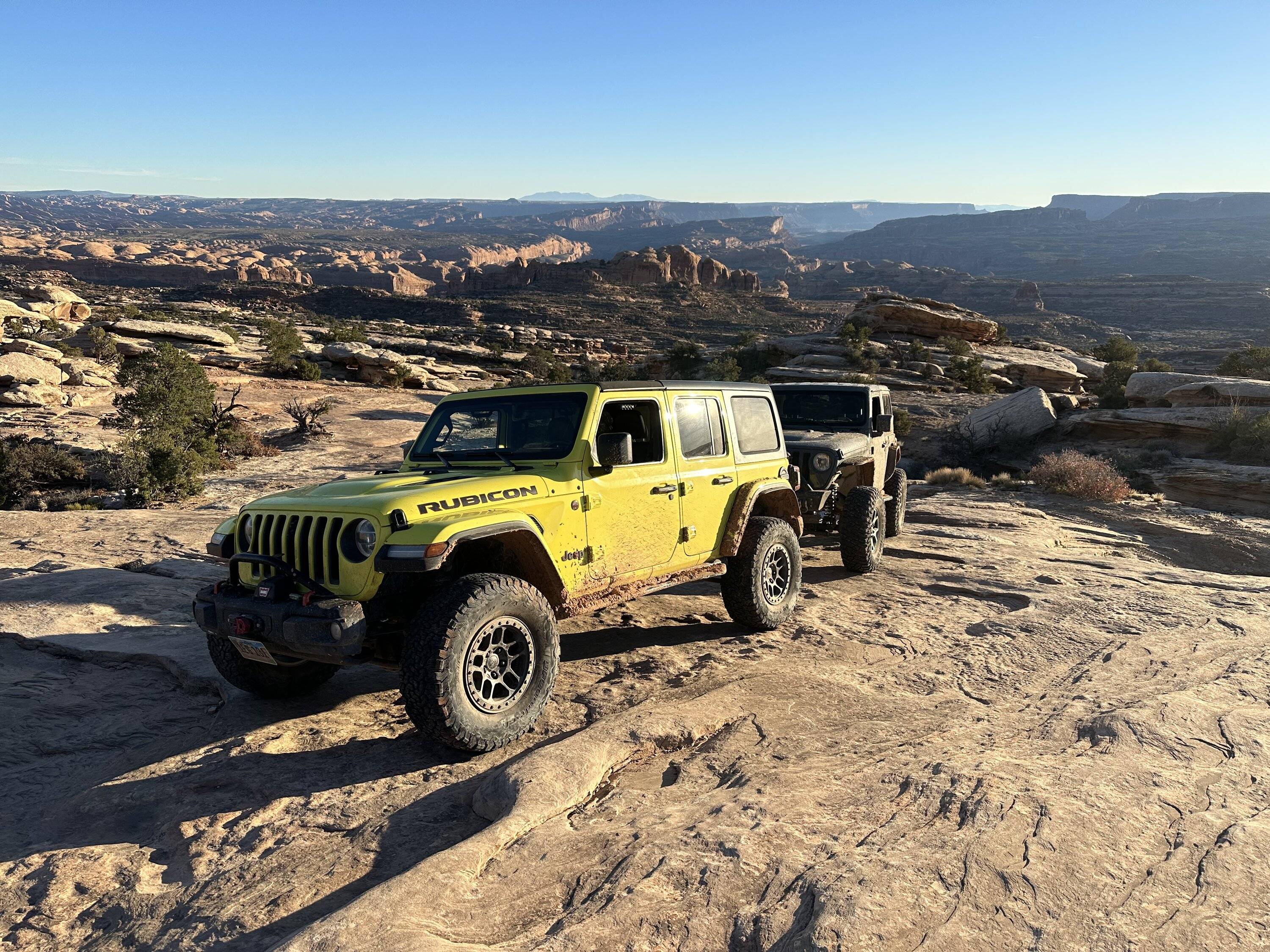

Went with a 3/4” spacer and still have some rake.

Hmm, that looks good, about how much rake would you say you have? Ideally i’d still have a little bit of rake for when I load the jeep so i don’t blind everyone more than i already do at night.
Just measured the fender lips. Still have 1” of rake with the 3/4” front spacers.
