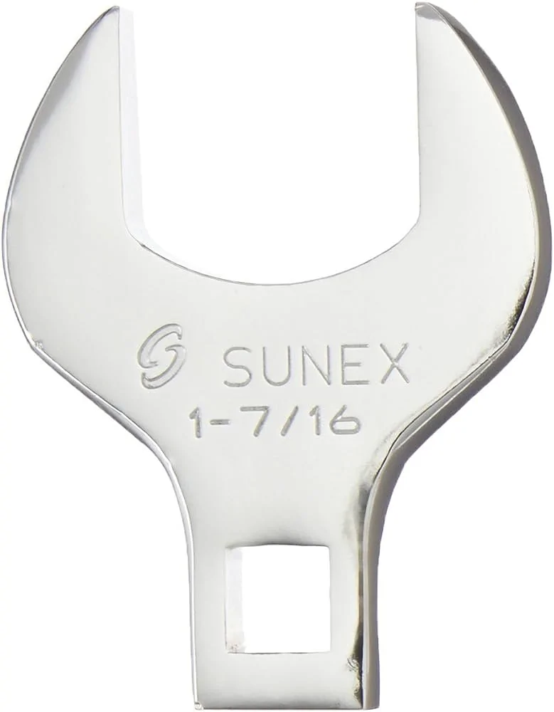

Your best bet is a quality set of crows feet. Even those will slip if you’re not careful. Metalcloak makes some that wrap more than 2 sides. Not sure if they’re the right size for you but there are others out there as well.
1/2-Inch Drive Deluex Metric... https://www.amazon.com/dp/B076KYCDLH?ref=ppx_pop_mob_ap_share

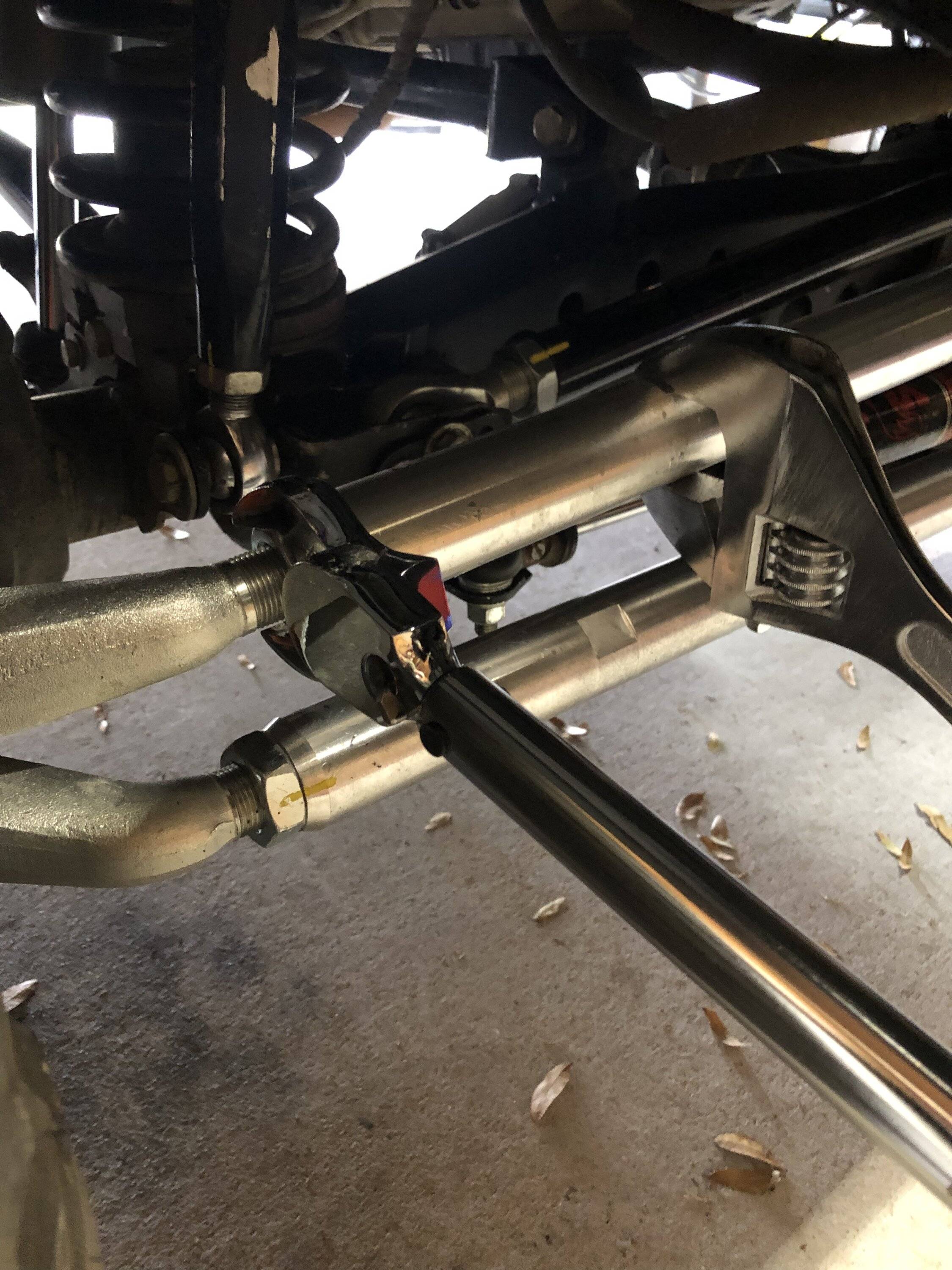

You can use a HF crescent wrench, just use it on the flats of the bar and use a crow foot on torque wrench for the nut…….then use your LoD bumper to hold the crescent while you jump up and down on the torque wrench to get it to 250 ftlbs … ?

I'll keep that in mind, except I don't have a LoD bumper to hold it for me! I'll have to improvise that part, lol.
