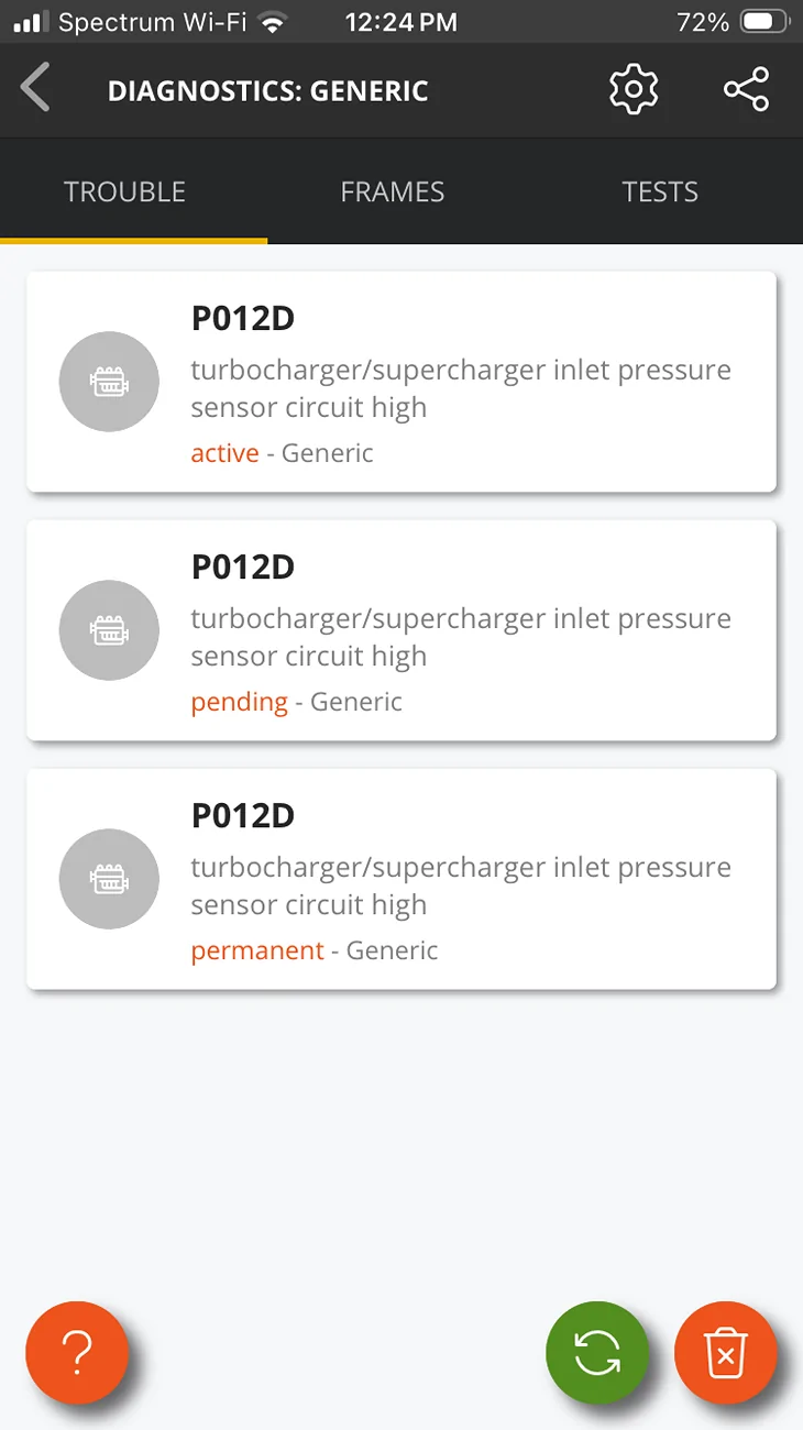

those codes are indeed low voltage related, and the 'P' does stand for pending, which means it's triggered recently. I'd recommend erasing the codes with your OBDII scanner and see if they come up again after a test drive or two. If they do, it's likely a sign of a more serious issue like a bad alternator or wiring problem.
I’ve had codes with P be active, pending or permanent, so don’t rely on the P.
