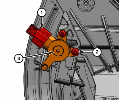

Great point.
I looked on all data, and it looks like the current brake switch is more of a rheostat than the old plunger style. (I'm assuming the "brake light switch" performs the interlock task).

Make sure the screws are tight and the brake pedal sensor is not loose. If it's still not reliable, I'd just replace the sensor.
