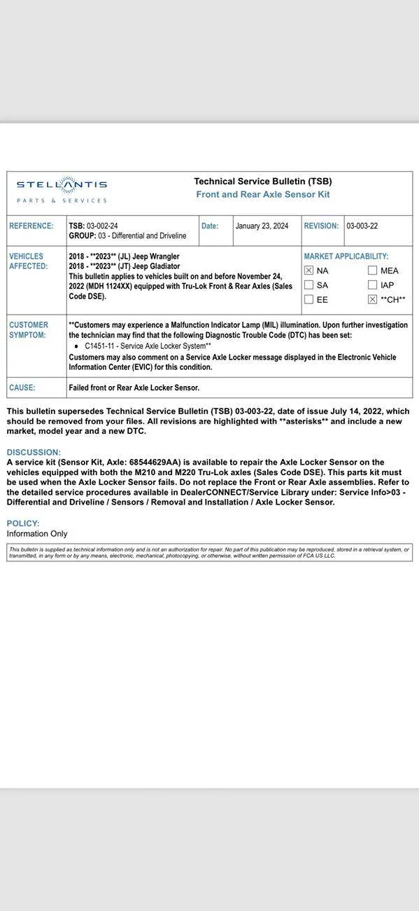

Thanks for replaying
My jeep is 2020 jl
The dealer sayes no recall on it
it's not a recall, it's a Technical Service Bulletin and it applies to all 2018 to 2023 Wranglers and Gladiators built on or before 11/24 of 2022 that have tru-lok axles
