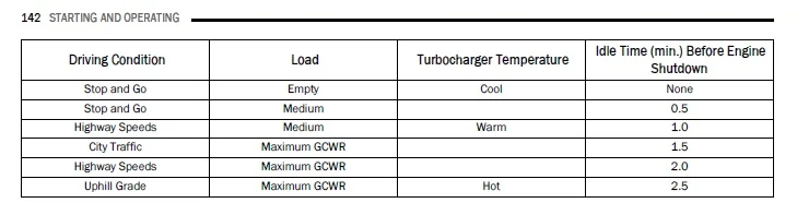

No need to cool the turbo down.
After prolonged heavy loads, sure its good practice but its not necessary.
The Owner's Manual does indeed instruct the owner to provide a cool-down period for the turbocharger, in the form of suggested post-drive idle times.
Jeep Wrangler JL Wrangler 2.0 or 3.6 Turbo idle 1
Jeep Wrangler JL Wrangler 2.0 or 3.6 Turbo idle 2

Does the water pump run after shutdown on these engines?
I can't find this idling information in my 2025 Owner's Manual.

No it does not.
The owner's manual for my 2025 Jeep is more full of warnings that are common sense and has the worst user usefull/necessary info and some tiny pictures of any manual I've ever read! Here, scan the QR code....mkay just print it here. LOL

That is nowhere to be found in 2025 manual. I think its good practice, but lets face it, how many people that buy a jeep would like to have to sit there for 2 minutes waiting for the car to cool off? not many. This would be a turn off for many buyers, so Jeep and other manufacturers had to find a way to get around this. I know jeep has a secondary coolant electric pump so maybe that pump runs as needed to cool the turbo? No idea.
Edit: according to this thread, aux pump runs for 10 minutes after engine shut down to cool the turbo. (17) Looking for information on MOPAR vs. after-market Auxilliary Coolant Pump | Jeep Wrangler Forums (JL / JLU) -- Rubicon, 4xe, 392, Sahara, Sport - JLwranglerforums.com

I had no idea about this. It must just run under extreme conditions because I can't recall ever hearing it running after I shut the Jeep off. Or is it rather quiet when running? This is on a '25 Willys 2L turbo...

They took that cooldown portion out of the manual starting on the 24s. I already went thru that search. I do let mine run for 30-60 seconds after shifting into park. Good, bad, i dunno

That is what I thought. No need to sit and idle.

Because you drive it like a grandma.....lol. Step on it! and also it is electric and very quiet.
