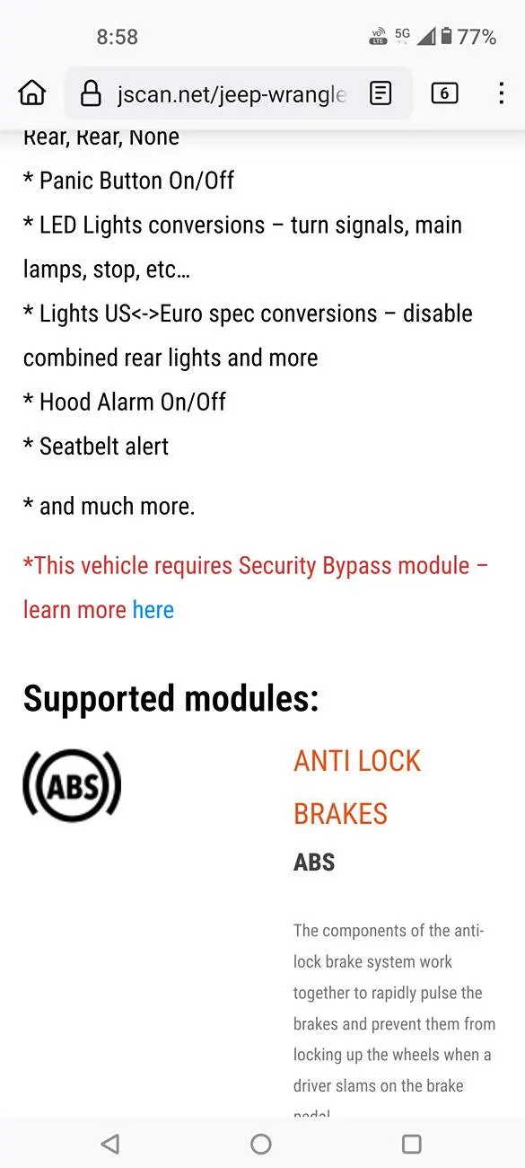

Many recommended JSCAN.
Would you provide me some insight to whats the best OBD adapter?
Additional question; for a 2021 Rubi 4DR 3.7 do I need a harness to bypass the security gateway?
Thanks!

Hi Larry,
You'll need the harness to bypass the security gateway, and I recommend some extension cables since it's kind of a PITA to get in there every time you need to connect the Bluetooth adapter to make changes. I just went through this because I put 35's on my JL Sport and needed to correct the speedo, and my son added paddle shifters to his JLUR so we needed to activate them.
I downloaded Jscan and bought 3 vehicle licenses since we have 3 JLs. I believe a single vehicle is $20.
I bought the VLinker MC+ Bluetooth adapter for ~$50 - https://www.amazon.com/dp/B0C2GT4KR3
The SGW Bypass cable for ~$15 - https://www.amazon.com/dp/B08ZL4LRVK
And SGW Extension cables for ~$15 - https://www.amazon.com/dp/B0D7Z8LG16
You are right, the cost at the dealership is crazy, considering you can DIY all-in for around $100 and have the ability to scan for codes and make many more changes in the future for no extra cash outlay.
Hope this helps!

I use a OBD Link MX+. You also need the Chrysler 12+8 cables

I second the recommendation to get the extension cables along with the bypass cable. Either Amazon or zAutomotive. I think zAutomotive had a video for doing the installation; it’s a bit of a pain to get to the connectors.
