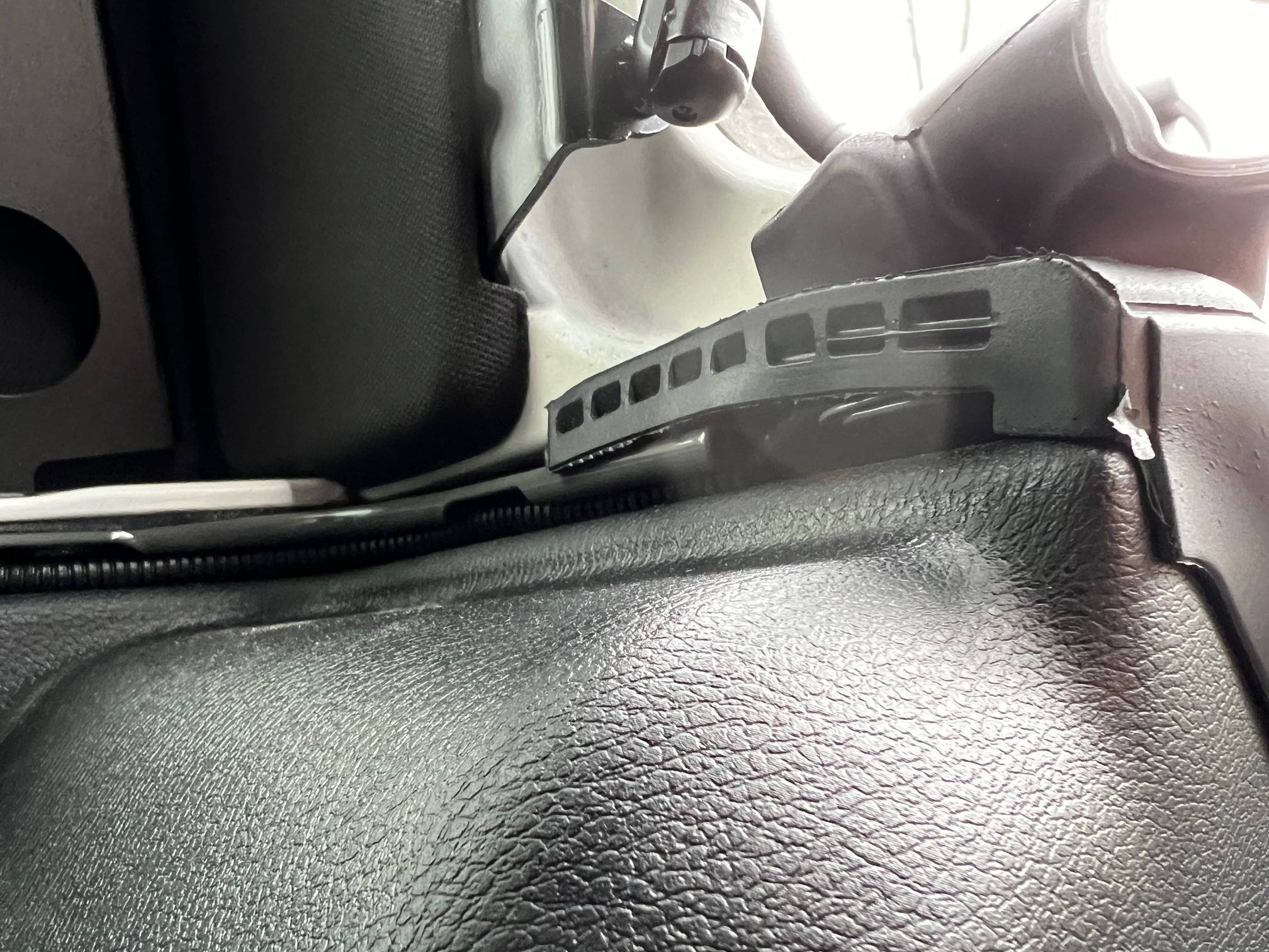

Here is what I had done. Once you get the wires to the interior with this method you can get into the engine bay (see other folks posts about getting wires through the firewall). I connected it to the interior aux wires so no need to go to the engine bay on my set up. Originally I want to go to the engine bay to get to the external aux wires but no clean way to do it.

Here are close ups. It goes under the rubber (plenty of space) and then between the top and the body (but there are other routing options - I don't plan to take the top off).
Jeep Wrangler JL Wiring roofrack lights to engine? IMG_9656
Jeep Wrangler JL Wiring roofrack lights to engine? IMG_9657
