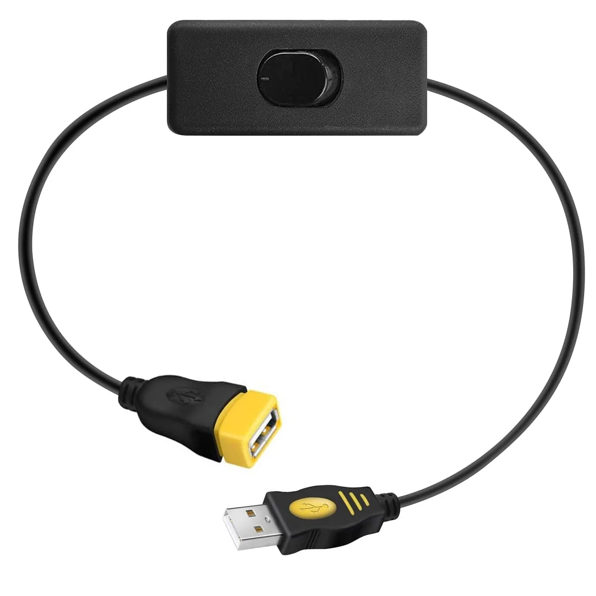

The problem with the wireless CarPlay adapters is the Jeep keeps the USB plugs on when you turn it off. The connection reconnects when I walk around my house near the garage and my calls get transferred to CarPlay.

Yes, with ignition off, all the JL's, USB ports remain powered on for approx. 60-70 mins..
An option would be to install and use a Power and Data ... Male to Female USB Cable Adapter with an On/Off Switch inline with your CarPlay dongle.
Jeep Wrangler JL Wireless Carplay adapter 51mhIsFNpkL._SL1200_
You would flip the switch on the inline switch to off, when you enter your JL, just prior to start-up when you do want to use your wireless Carplay dongle . When getting out of the JL after using your wireless CarPlay dongle, you flip the switch to off.
Or take the switch apart and replace it with a relay and tie that into ignition. Then you'll not have to fiddle with it.

I have a MA-1 and an android. I just spent six bucks on the switched cable. Done. Thanks for the idea.
