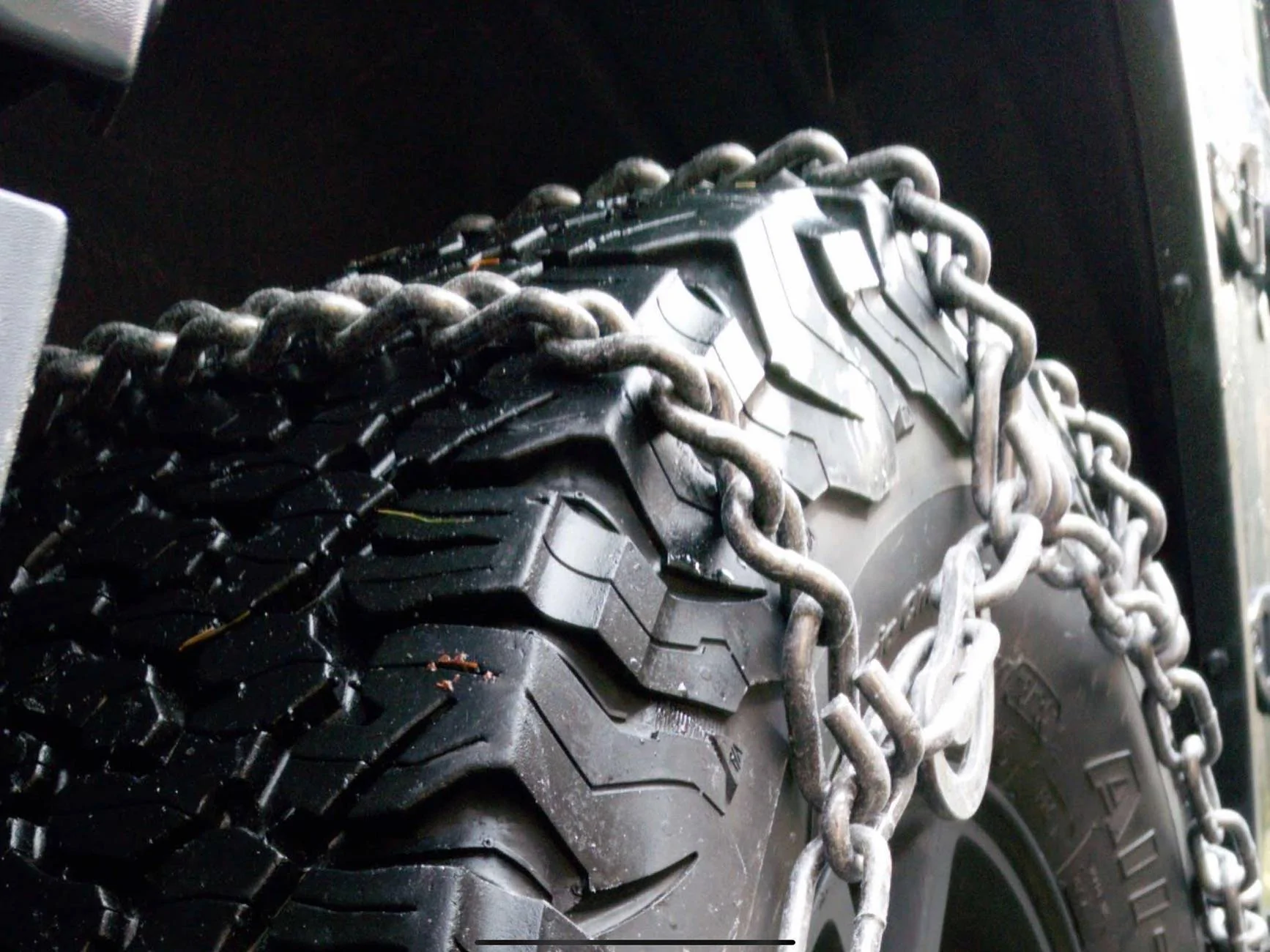

This sounds like a valid post and from someone who has actually used chains. Smart and knowledgable. As my hands-on conclusions are pretty much the same.
For those unfamiliar or guessing or speculating - chains are a must on very slippery wet black ice on an incline or decline. Snow and ice dedicated tires will not give you much grip. Studs will give you some grip but not a lot. Cables will give you more grip. Chains will generally give you enough grip. V-Bar will give you maximum ice and off-road grip.
We have regular chains cam locked shown in the pic below and they are fine when conditions warrant. But for extreme conditions get V-bar and put them on all 4 wheels. You can see in this video - regular chains grip perfectly fine on compacted snow turned into ice. We also experience this from time to time.
Those that never have needed to use chains - just have not been out enough in adverse conditions is all. Otherwise they would know that chains are mandatory. When they are mandatory.
As noted many times before - the Jeep in 2H with shitty half worn KO2s that many despise - is fine to get up and down lightly snow packed unplowed roads to ski mountains. While punching just into 4H gives way more traction. Most times this is enough. But in tough going - have used 4L and lockers and boards to get out of a foot of soft spring slush with a layer of ice under. Took us about 45 min of inching along with 4 wheels locked churning away trying to get grip - which was an enticingly close 2 feet away.
Chains are left to more adverse situations like shown in the vid. Nothing spectacular with wheels spinning wildly - just mundane slow crawling where the wimpy V6 that many think is shit - is in its power zone. Haha!
Jeep Wrangler JL Winter wheeling - chains, cables, nothing, a sled? ECEB3B73-CA11-45C0-94A3-9D17C01C4912

Yeah, I have a “bit” of experience with cam locks, generally putting 6 chains on at time.
Your video shows nicely, how they should be installed, with the flat side of the connecting clamp against the sidewall.
In your video, you have plenty of snow/ice depth to make use of Ice Bar chains, without tearing them up
I also noticed that you have some of the best chains, your outside end link are a sort of cam themselves, rather than just an open fixed hook, like on the inside chain rail, those will take up some slack connecting them rather than putting an inch or so of slack like the fixed hooks. I don’t know what the proper name is for those, I have always referred to them as “Long Arm Cams”. Whenever I have a choice I grab those for my own tractor. I have also picked them up from the side of the road, if I find them while chaining or unchaining, I have set those aside for myself, and just used some Sunday to cut down for my Son in Law’s pickup. I have the tool to open and close the side rail clamps, to remove/replace broken cross chains. My previous company was more than happy to buy me a bag of replacement cross chains, rather than buying full sets of new chains all the time.

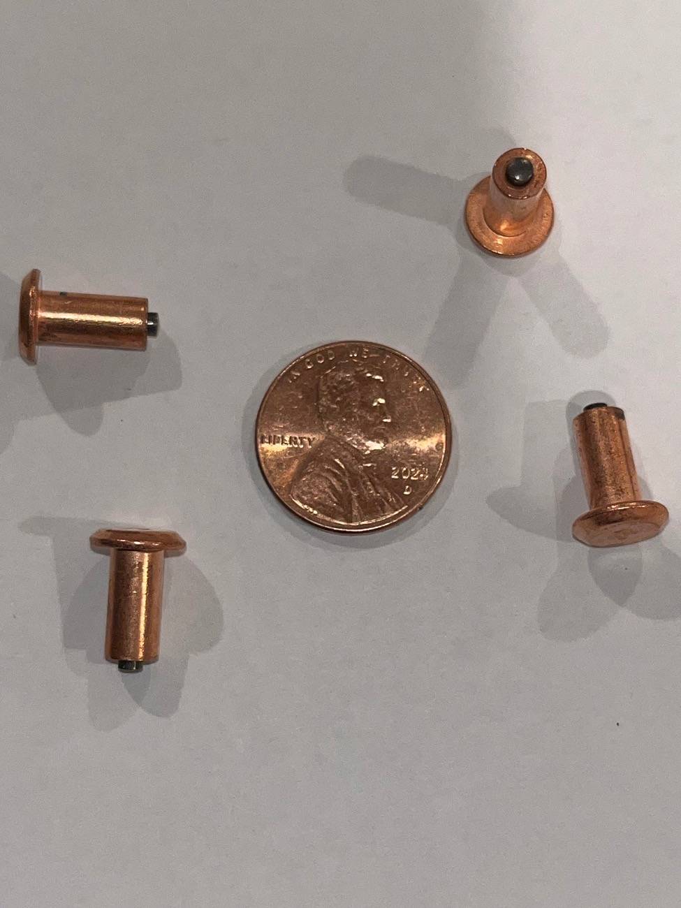

Arnie, to give you an idea of what studs look like, here are some pics to help you understand the design of them
Jeep Wrangler JL Winter wheeling - chains, cables, nothing, a sled? IMG_2809
This should give you several view aspects, with a common penny for scale

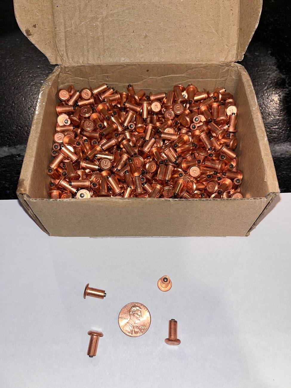

Jeep Wrangler JL Winter wheeling - chains, cables, nothing, a sled? IMG_2807
A box of a Thousand studs

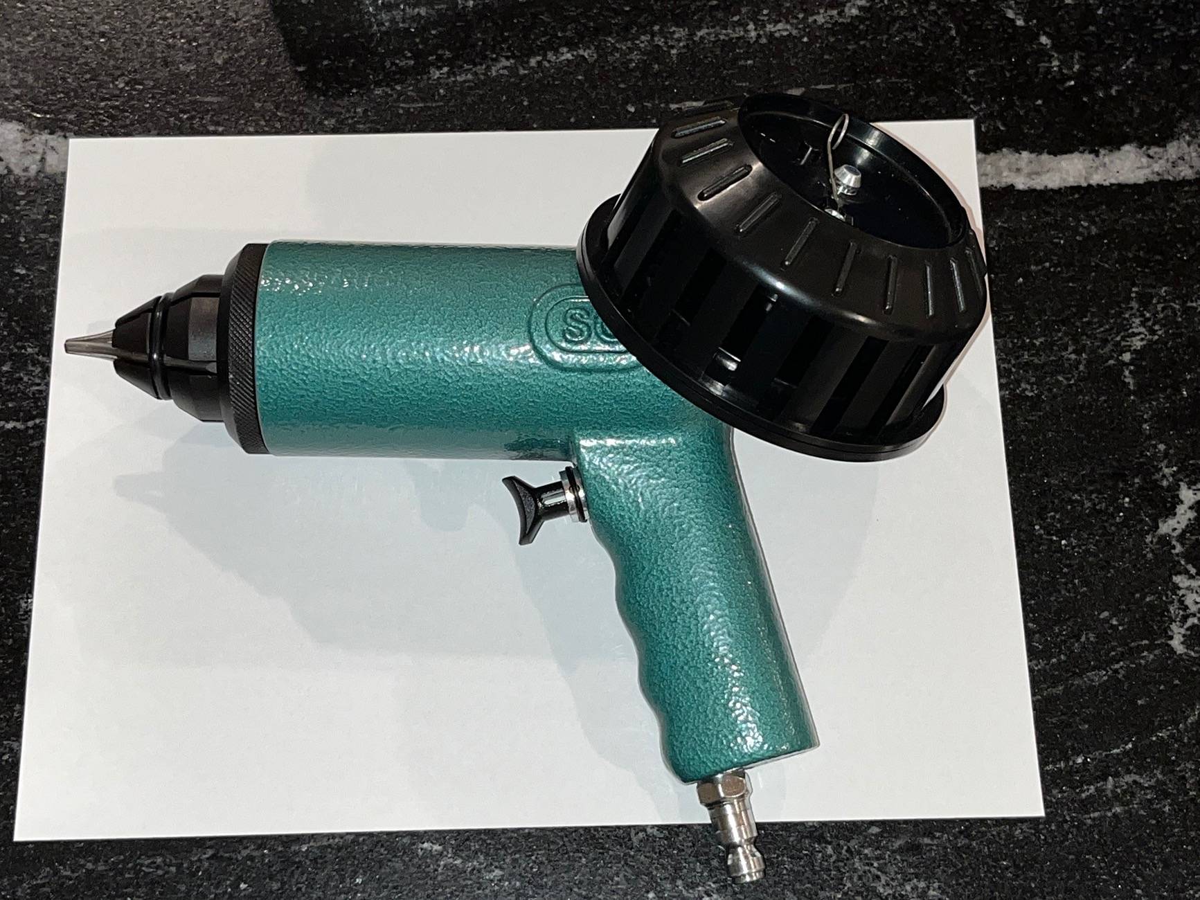

Jeep Wrangler JL Winter wheeling - chains, cables, nothing, a sled? IMG_2811
A pneumatic stud gun with a feed hopper

As you can see the Tungsten “Tooth” doesn’t protrude very far from the body of the stud, and the shoulder of the stud which the tooth protrudes from is intended to be flush with the tread of the tire, and the stud body is designed to wear with the tire tread, with just the tungsten tooth protruding beyond the tread
These are a “#15 stud” which is the length recommended for the 35x12.50R/17 Maxxus Buckshot II’s I have for winter tires on my Jeep
There are different lengths for tires with different tread depths
