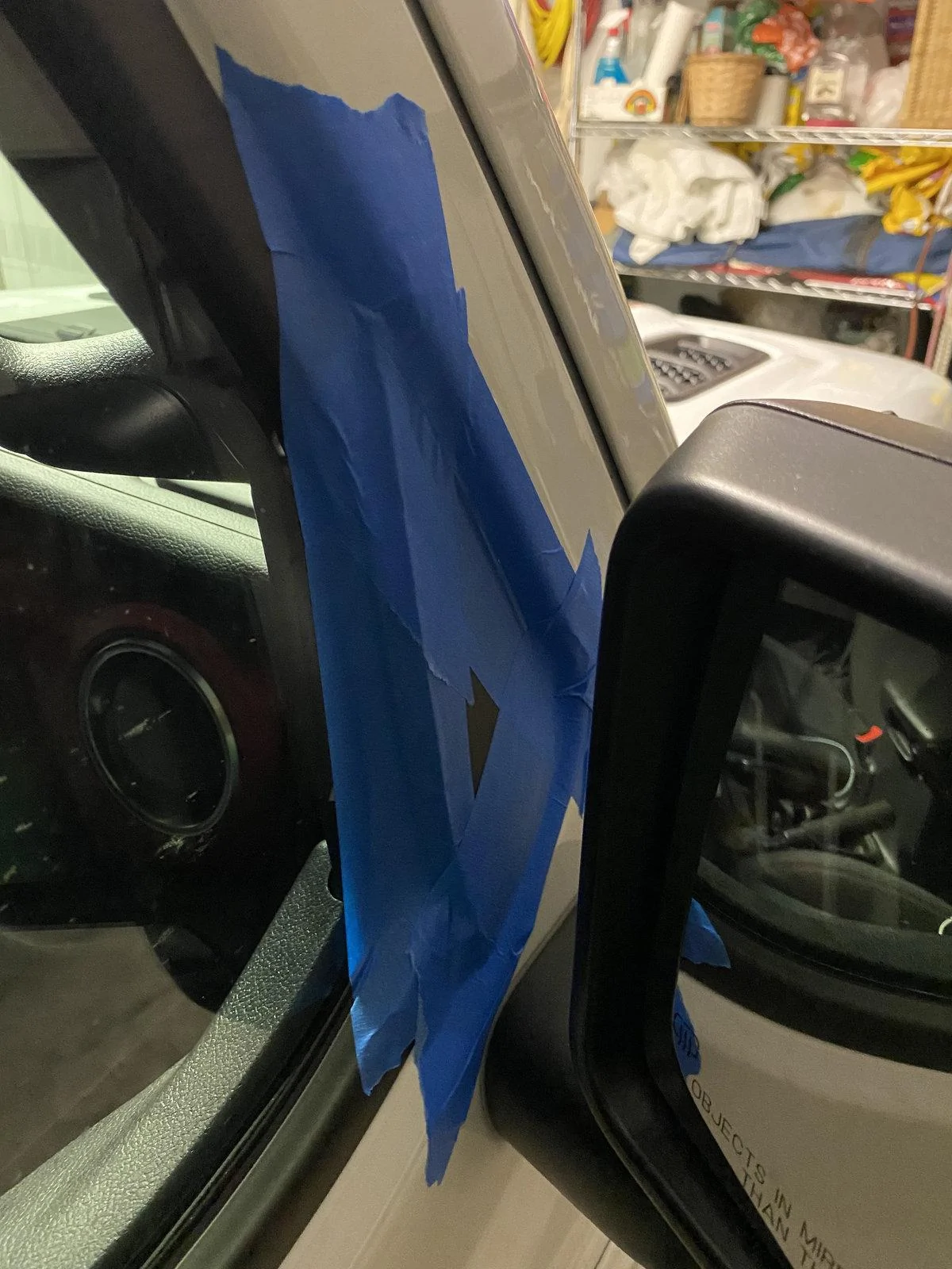

Start using painters tape on gaps and seals to isolate the problem. That is how they figured out I had a bad door seal and replaced it. Figure it out for them and they will have no choice but to fix.

So has there been any definitive fix for this or have folks had door seal, window seal, windshield seals all create this? I also have a 2019 JLU and have the wind noise issue on the passenger side with both soft top and hard top on starting about 40mph. Get up to highway speeds and you have to yell to talk over it. I came from a 2dr JK so am familiar with the fact that you are driving a brick, but to have one side that much noisier than the other is unacceptable.

Thanks Alex. Have done some testing and seemingly this is the only way I can drive without a ton of noise so this is my prep for my 400 mile trip tomorrow! Will take it into the dealership and let you know what they say.
