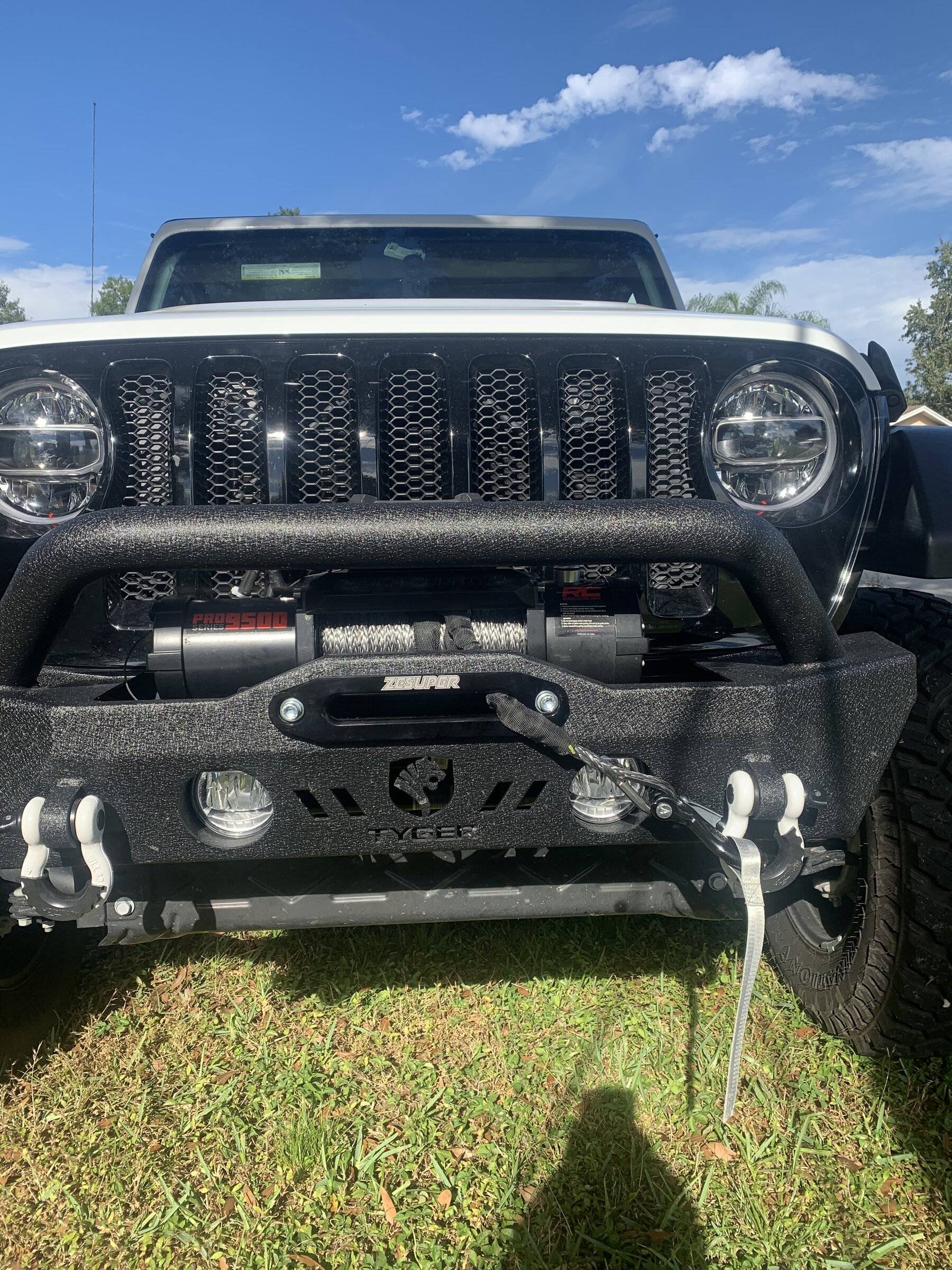

I've had both over the years & I have no real issues. My current is more inside and it had fitment issues on my Fishbone bumper. The Warn VR winch didn't fit well inside & I had to do a lot of cutting & grinding on the bumper to get it down in. Overall, I think I like the top mounts the best. Looks more rugged.

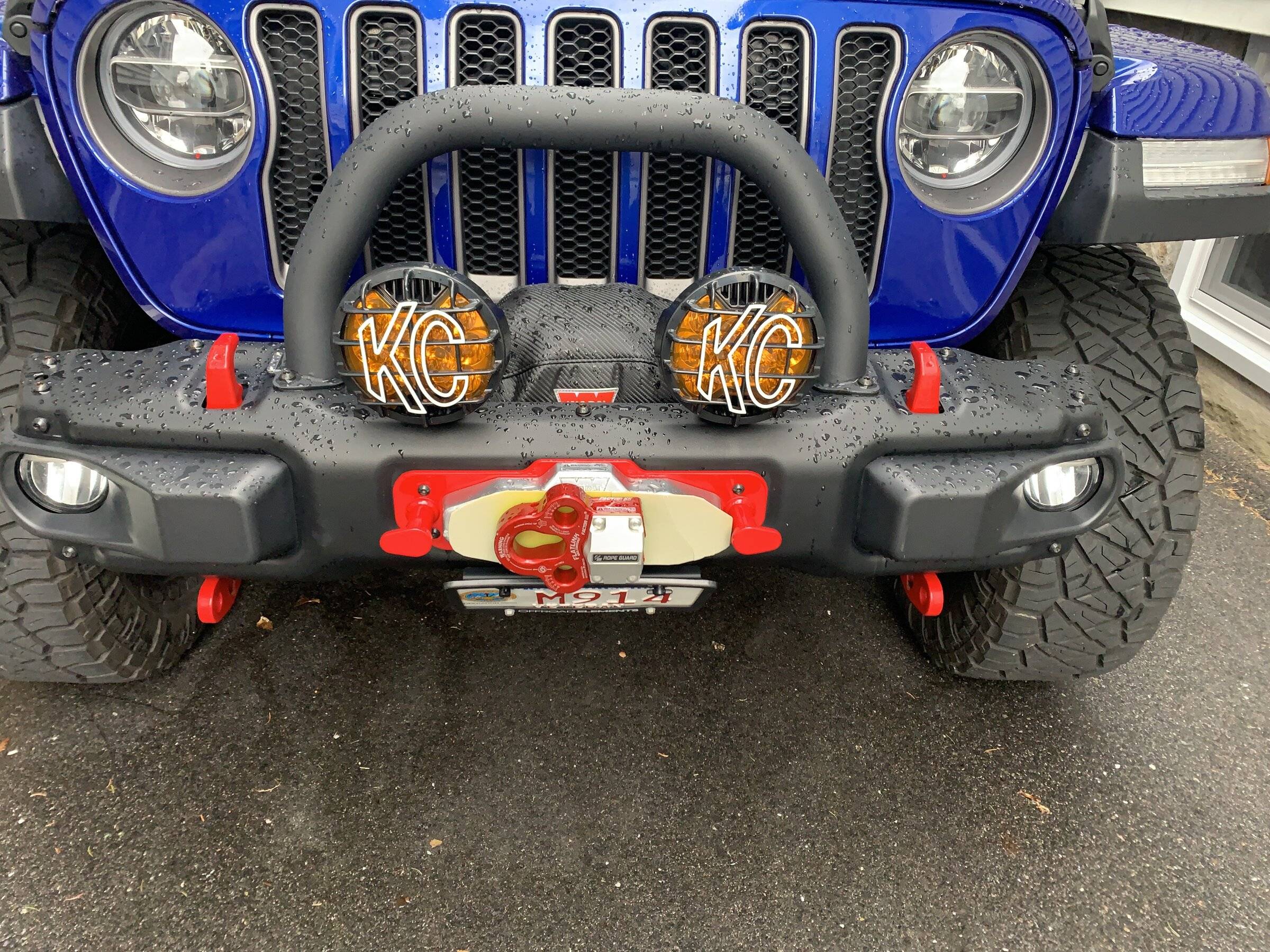

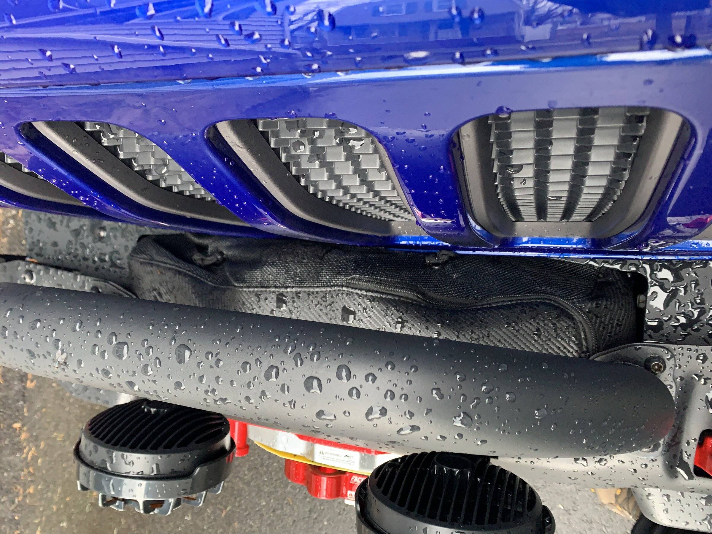

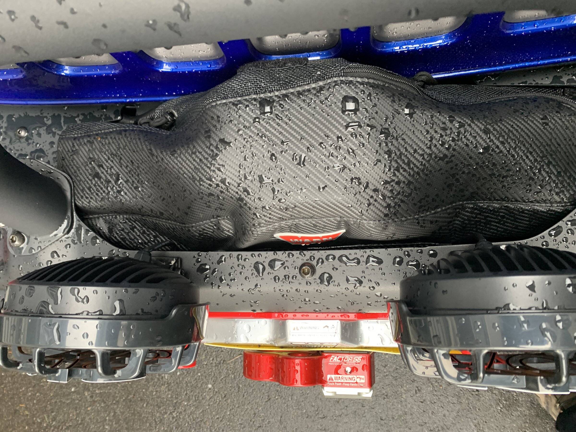

Warn Zeon 10s, Maximus-3 (mounting plate, filler plates, JL front toe loops, license plate bracket and bumper hoop), Warn cover (tight fit, should have put it in when the winch was installed). The yellow is a flexible cutting board I cut to fill the winch opening when not in use to keep salt and ice melt chemicals among other things from getting in and sitting on my synthetic rope.

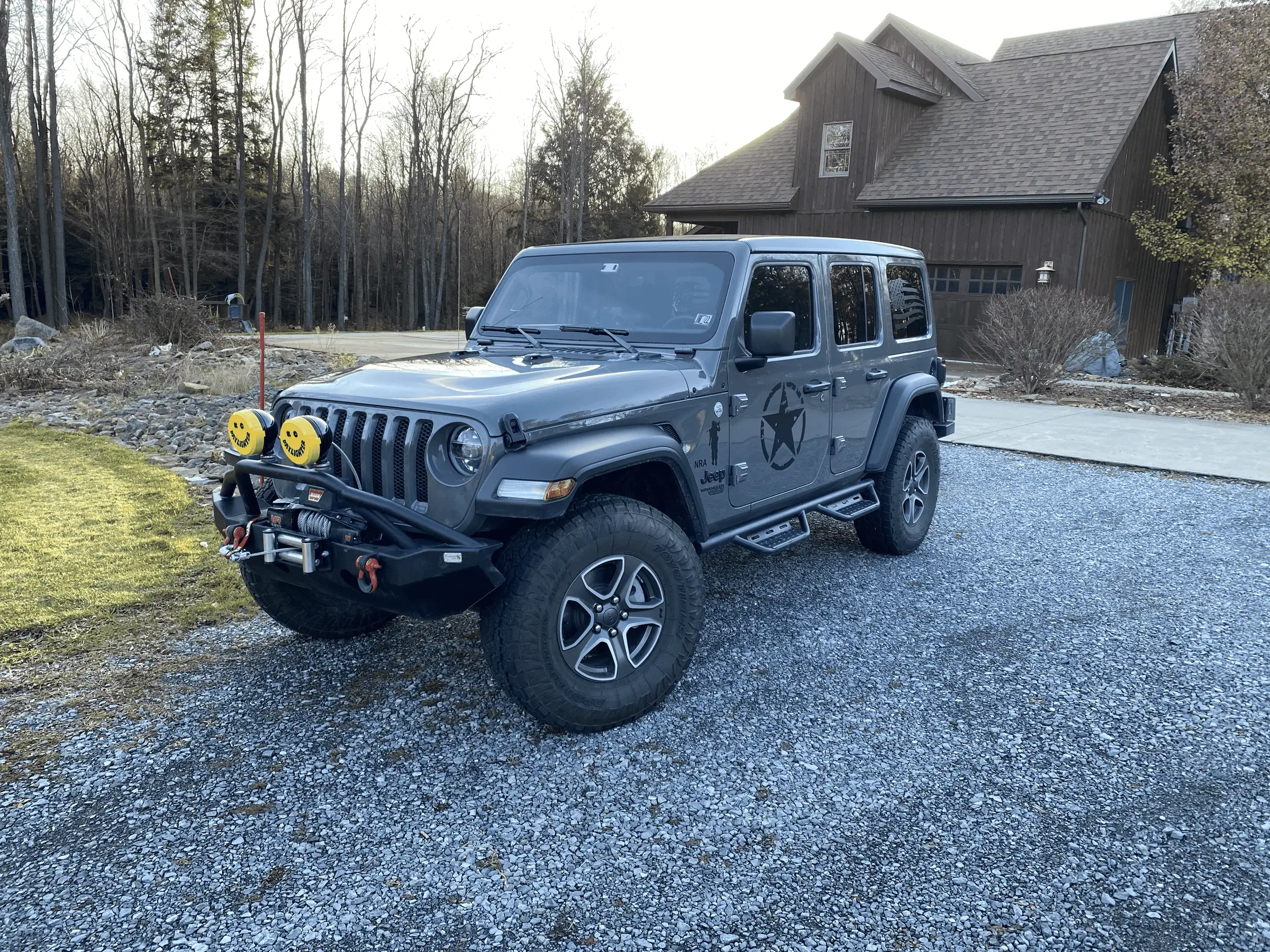

I am in the minority apparently haha! I prefer outside (or top) mount.
I have no idea about other engines, but I have had no issues with air flow type issues. I have the 2.0. I also did top mount in my last two Jeeps (1999 TJ with 4.0, and a 2007 JK with the 3.8) and never had any issues with those either. However..... I also live in the northeast where we only get a few really hot days a year. I would think that your geographic location should be a deciding factor as well.
I prefer the ease of getting to the winch quickly and easily, no worries about the winch actually fitting, and being able to spool it cleanly, etc. I cover it when not in use, so I'm not worried about the rope being exposed to the elements, etc.
The tucked in the bumper does generally look better though I suppose. Although the top mount looks more utility?? All personal preference.

Very cool idea with the cutting board material. I may just steal that idea thank you very much!

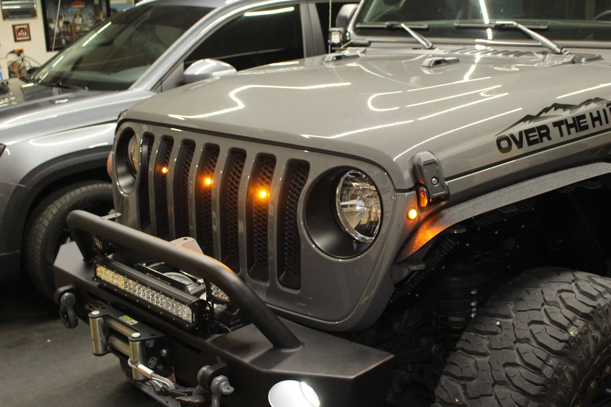

Outside.
The airflow issue is a non-issue and it's much easier to keep clean, service, remove.
