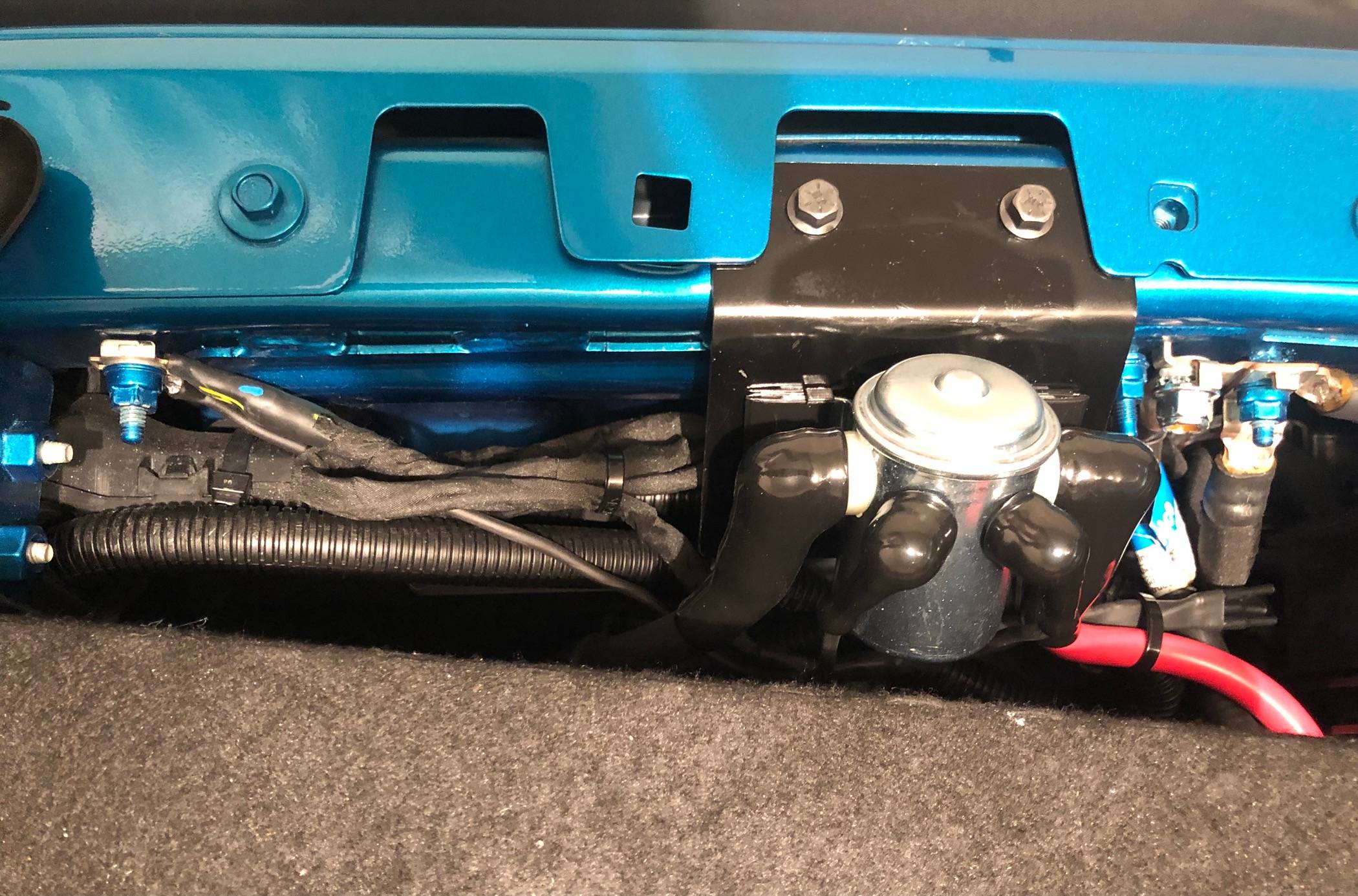

Here you go, Warn Power Interrupt Kit triggered by AUX 4. Took thick piece of aluminum, formed, drilled and painted black. Used one existing threaded insert and installed another in the fender. AUX wiring is near as well as great factory grounding points. About as close to OEM looking as possible!

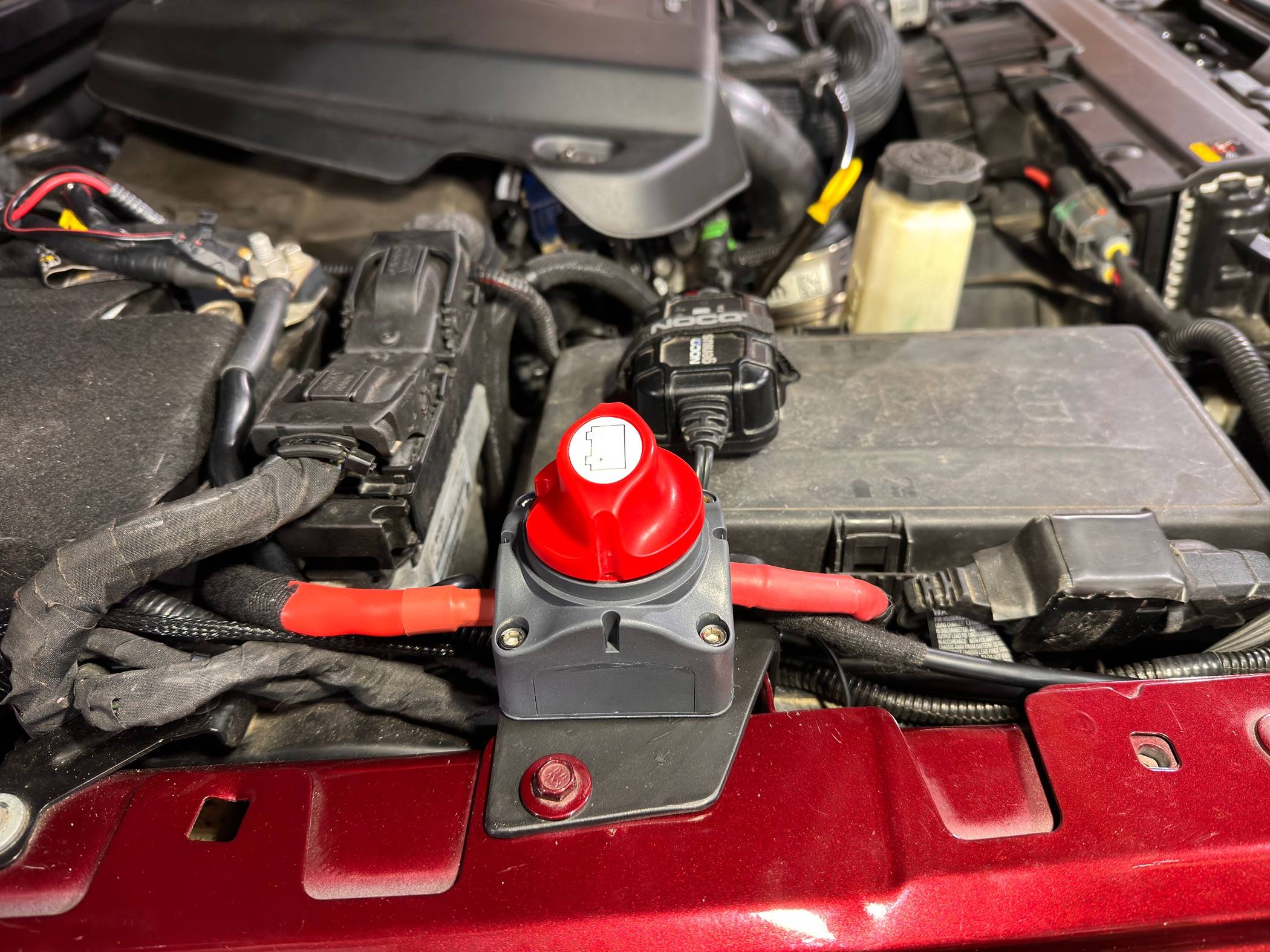

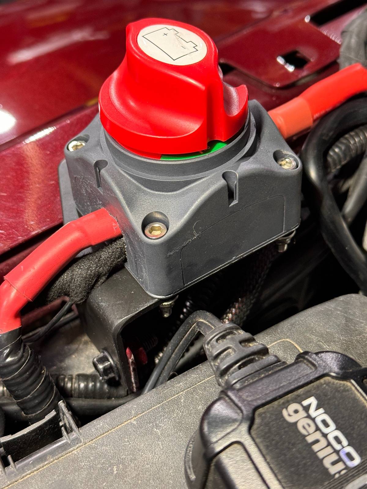

I went with a manual switch. I just bent a piece of 1/8” aluminum and cut it to the profile to fit and make use of an OEM fender bolt and an OEM tab inside the fender that has a 6mm nut already on it. It’s solid. Sprayed it flat black.

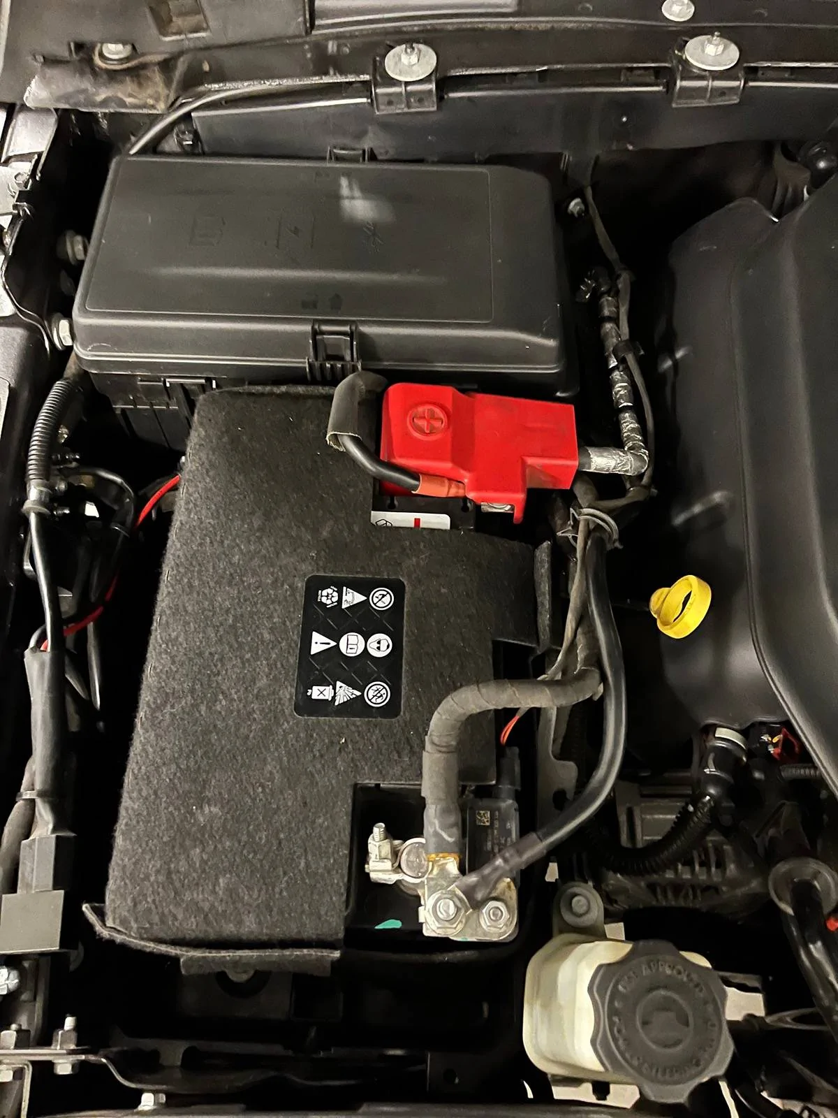

It’s a personal preference. 26 years in the fire service and I have been to hundreds of car accidents and vehicle fires. Not one time during our investigation into the cause did I ever suspect a winch cable as the culprit. That said, I see no reason not to do it if it gives someone peace of mind. My winch cables are directly attached to the battery as designed with no issues or worries. Just make sure you take your time running the cables to prevent any damage or chafing and remember to check on them every once in a while like any other maintenance item.

@Buddy Lee Thanks. I'm confident the way I have the wires run and tied off but I'm going to put a split loom cover on the wires for a little more protection.
