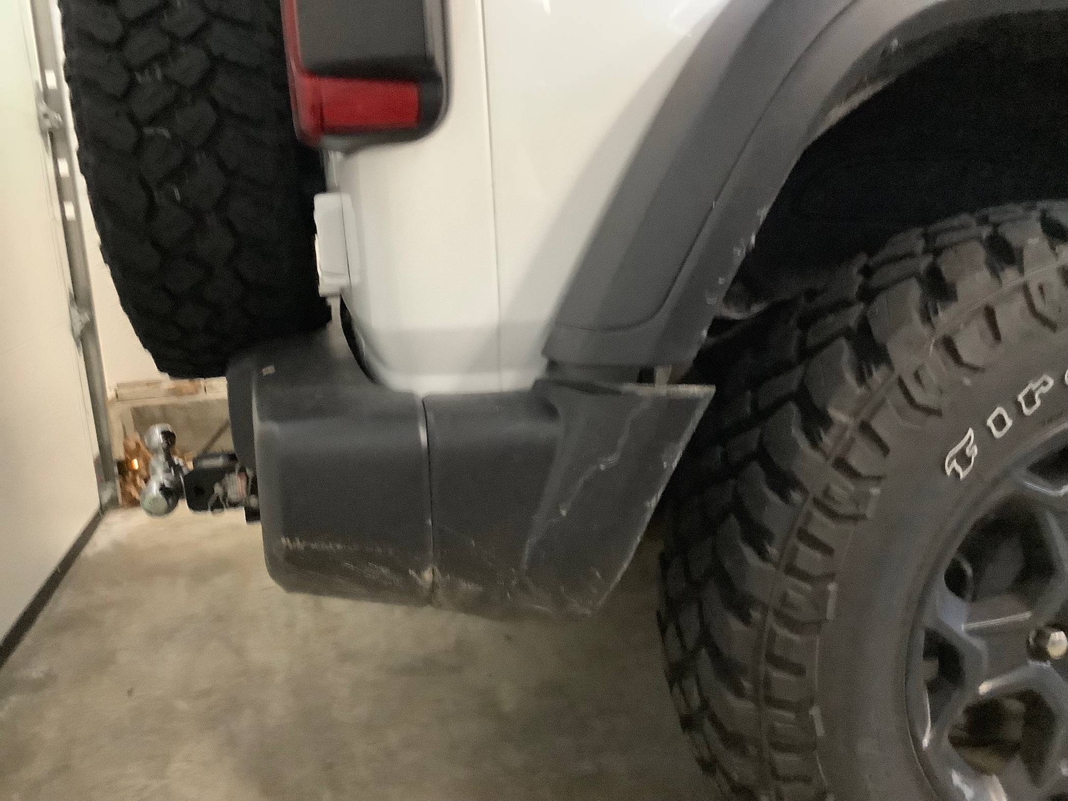

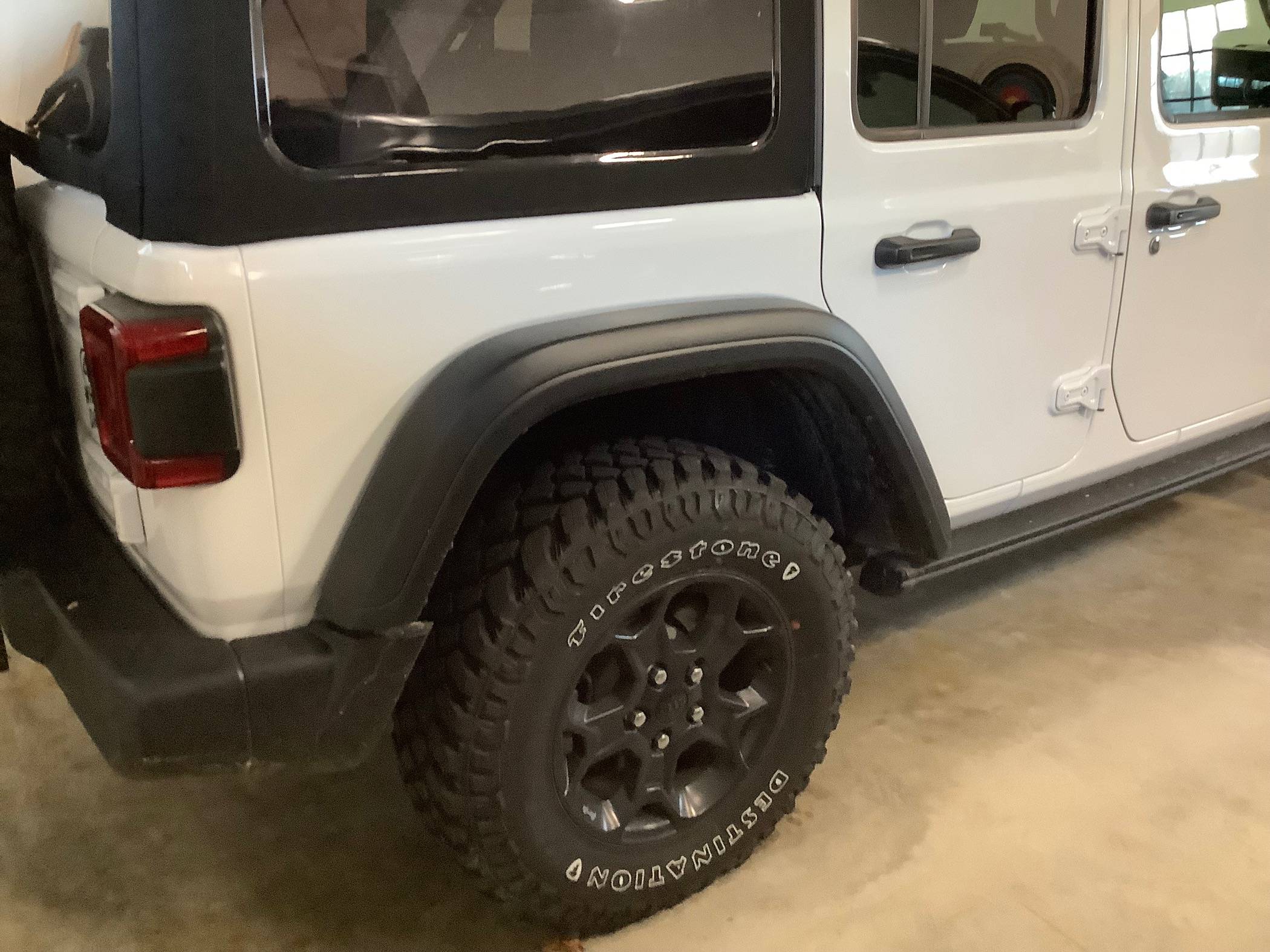

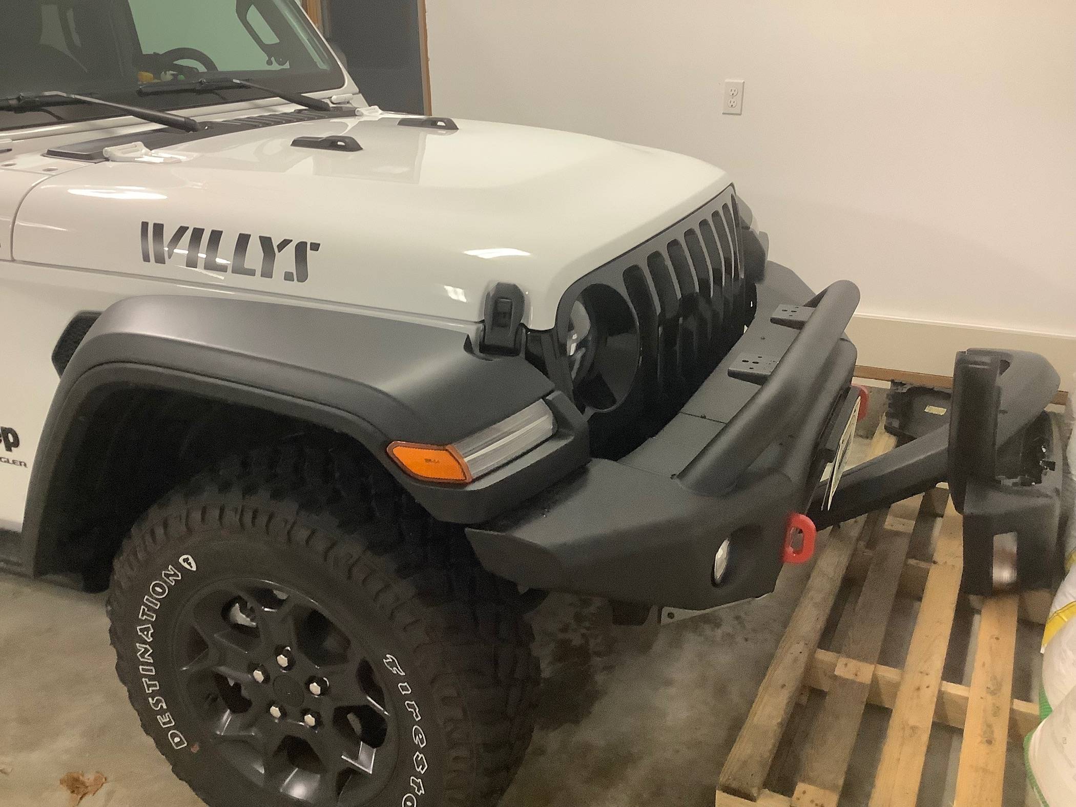

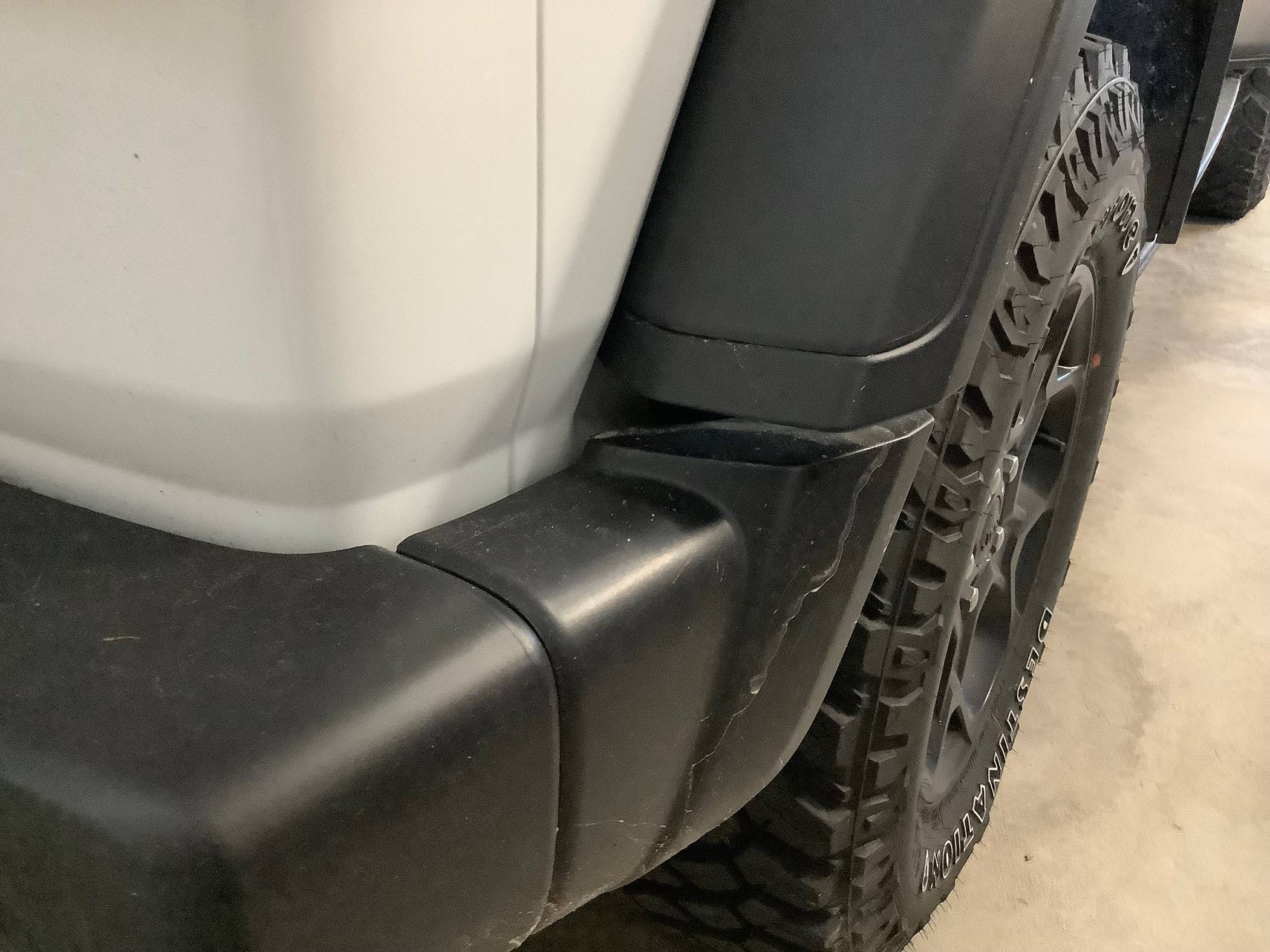

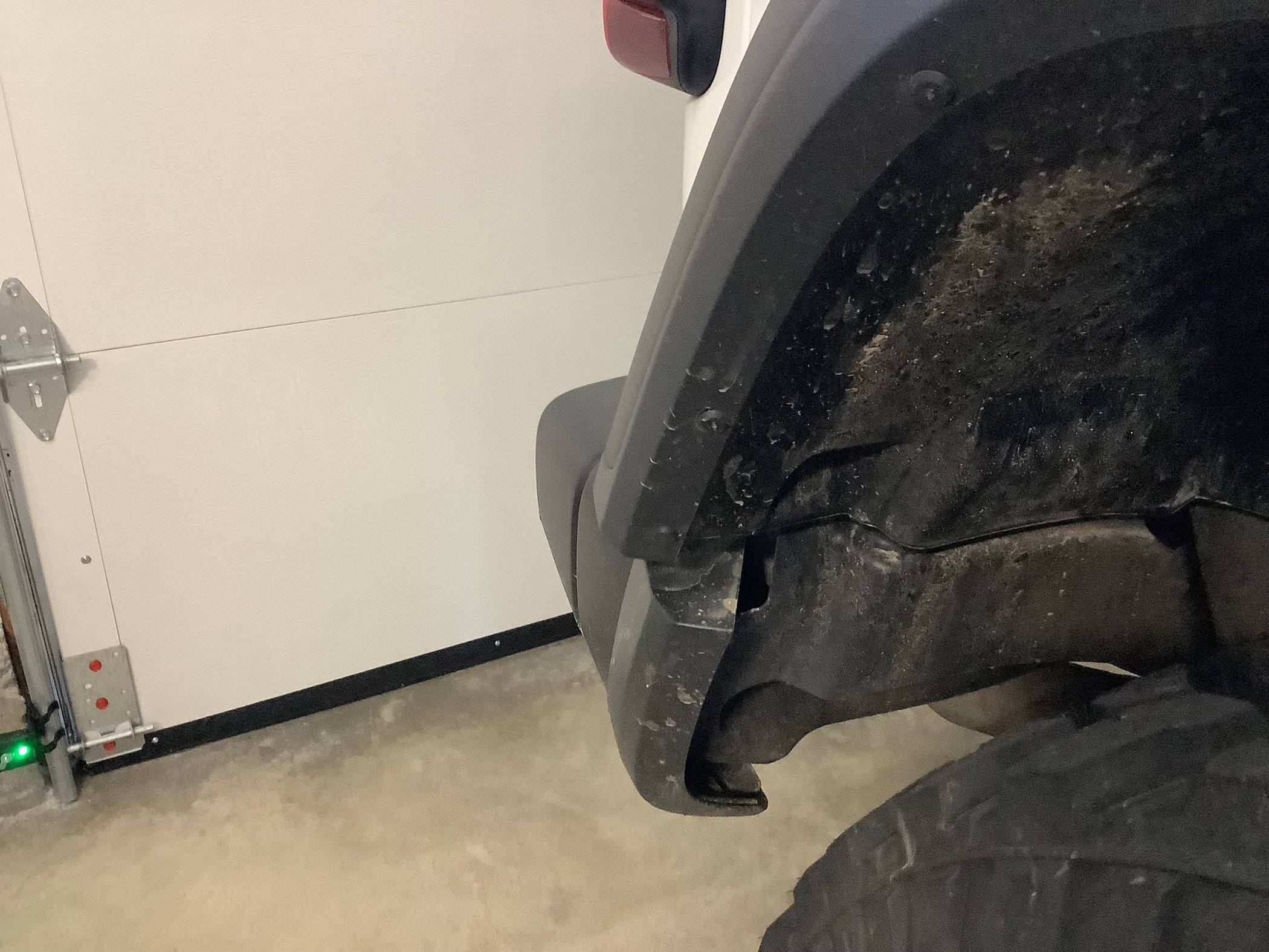

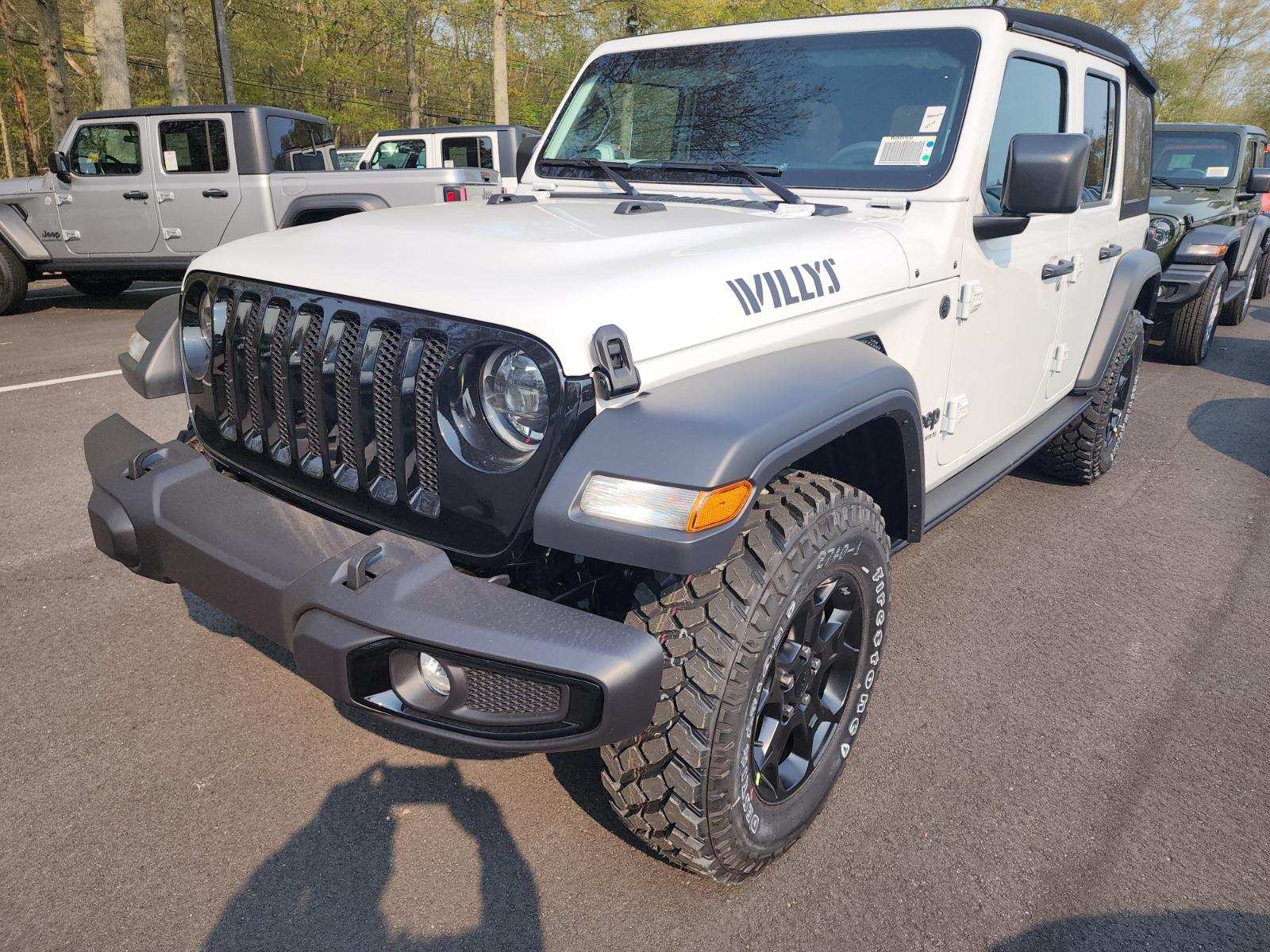

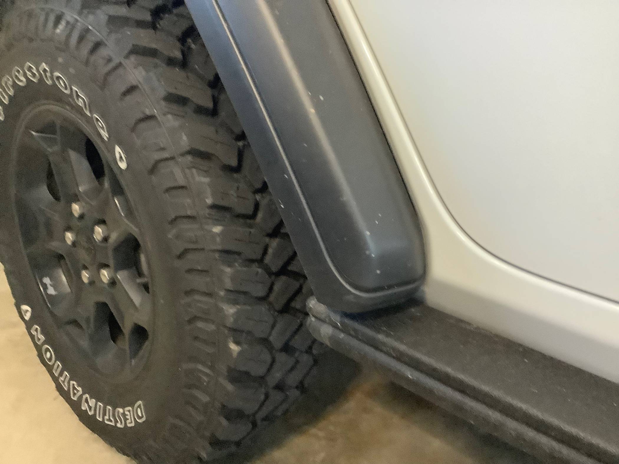

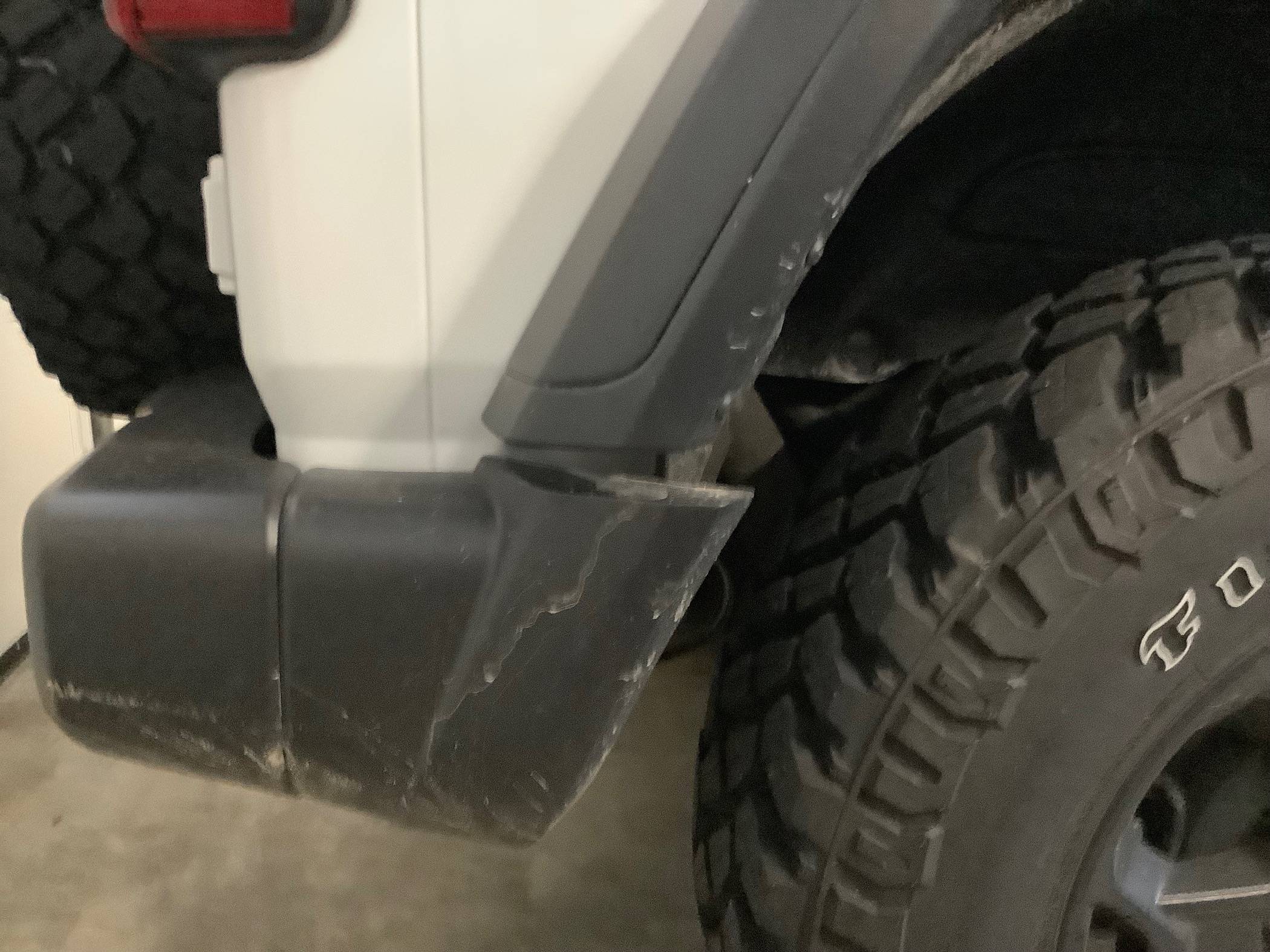

I have the plastic rear bumper on my 23 Willys. I put on the high line fenders to install my ARB front bumper. Here is what the install looks like on the rear. I intend to replace the plastic rear bumper with a metal one this summer. But at least these will show you the match up.
Benny got the fenders for me too. Shout out to him.

Thank you for your post and experience with the Fender flares on your Willys. This is really reassuring that the fender flares Benny suggested will resolve the issue. They are supposed to arrive on Friday. i will post pictures when I get them installed.

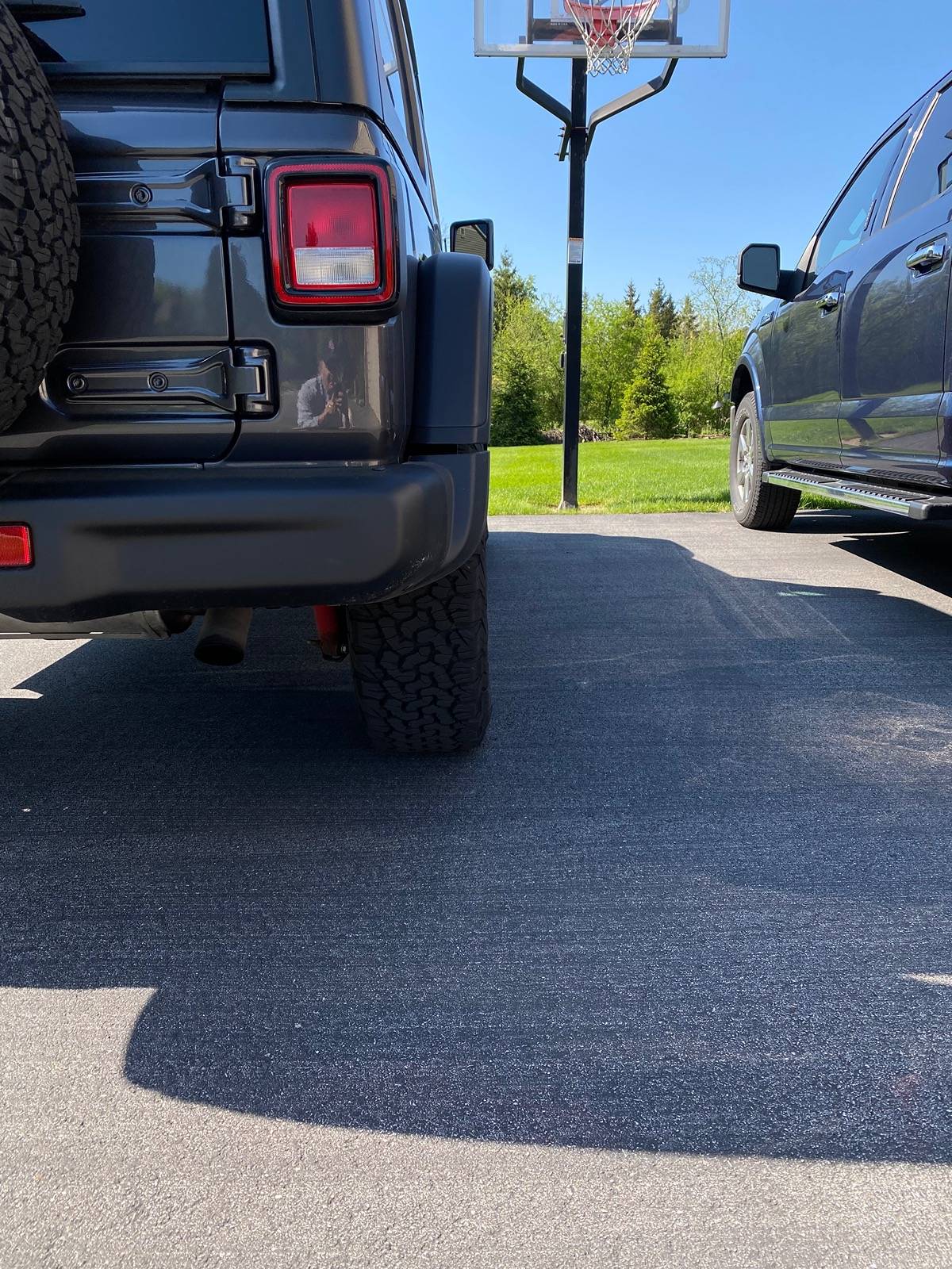

The high line fenders are a bit wider than the sport fenders too. Decided to add wheel spacers to fill the well.

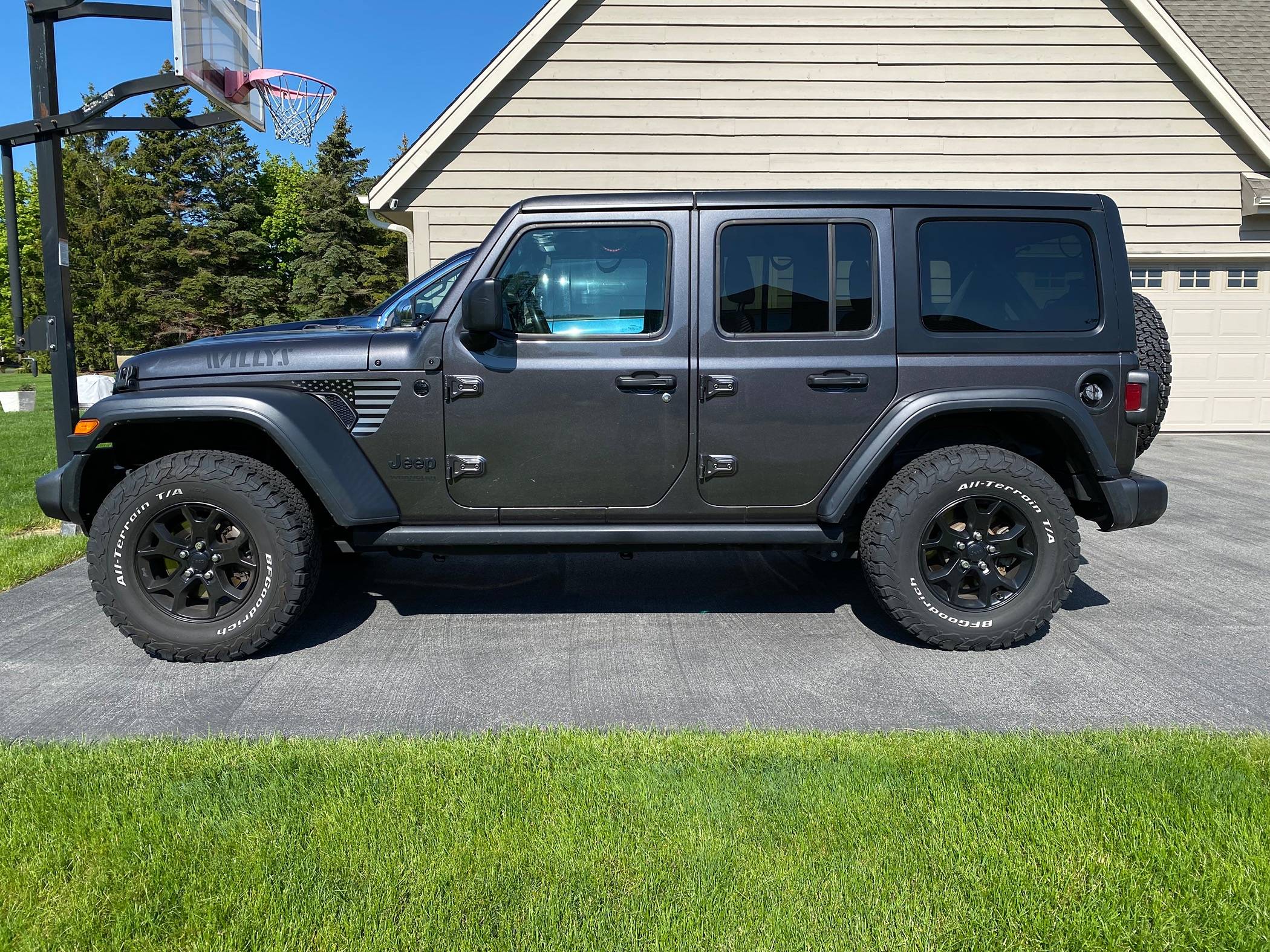

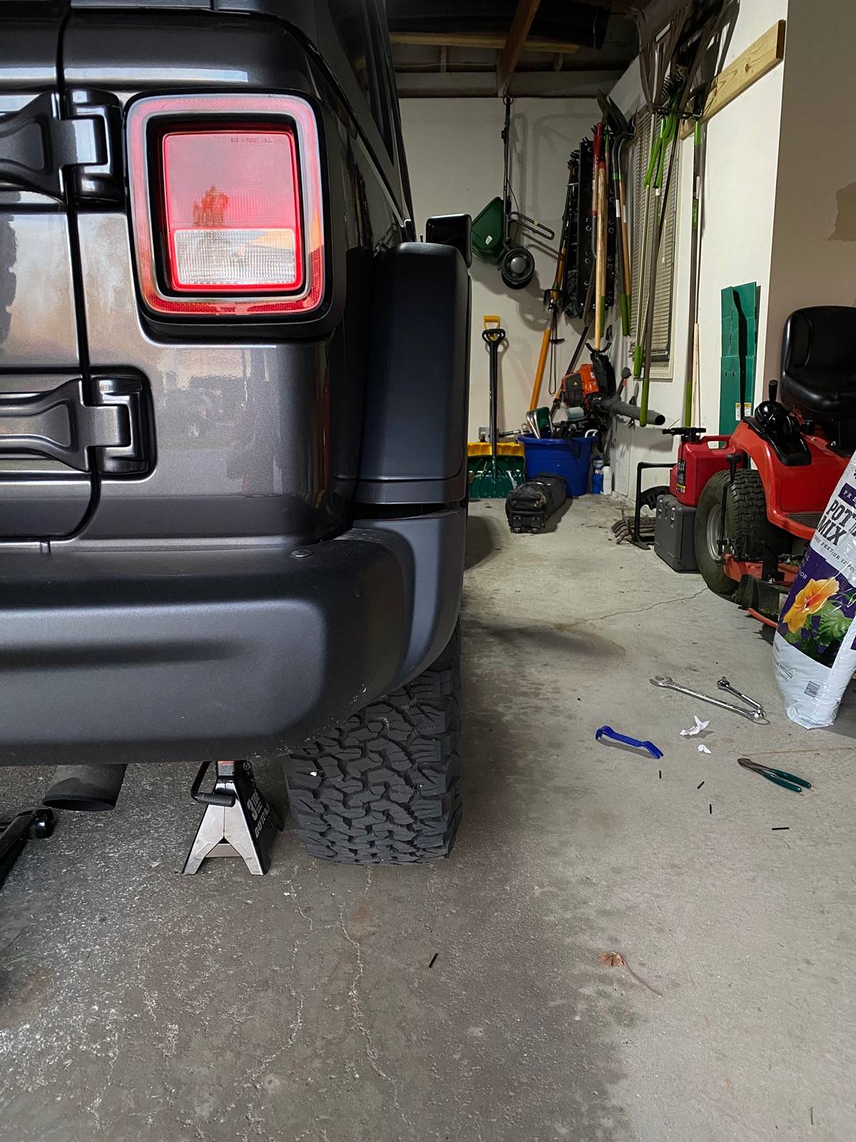

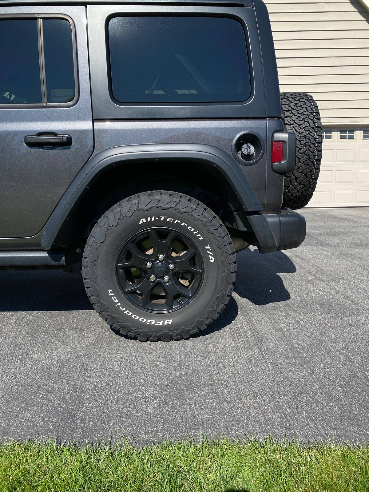

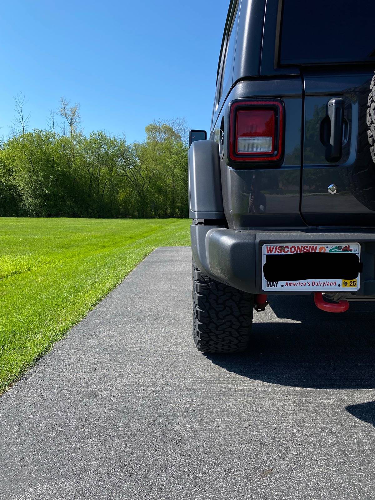

Hi all,
just updating this post...finally got them installed as the weather and my scheduled finally synced up :). i think they look good. And, while some may be able to see the difference in the high line flares from the front to back, i certainly can't tell. Just to be clear, I did NOT add the high line fender flares to the front. I only replaced the back fender flares and fender liners to line up with the Rubicon steel rear bumper. it definitely brought the costs higher but i think for the safety of a steel bumper that keeps the original design, it's worth it to me.
Here are the parts you would need. Again, so many thanks to Benny at All Mopar Parts. AllMoparParts.com
https://parts.allmoparparts.com/oem-parts/mopar-wheel-opening-flare-molding-left-6ce79rxfae
https://parts.allmoparparts.com/oem-parts/mopar-wheel-opening-flare-molding-right-6ce78rxfae
https://parts.allmoparparts.com/oem-parts/mopar-splash-shield-left-68299173ad
https://parts.allmoparparts.com/oem-parts/mopar-splash-shield-right-68299172ad
