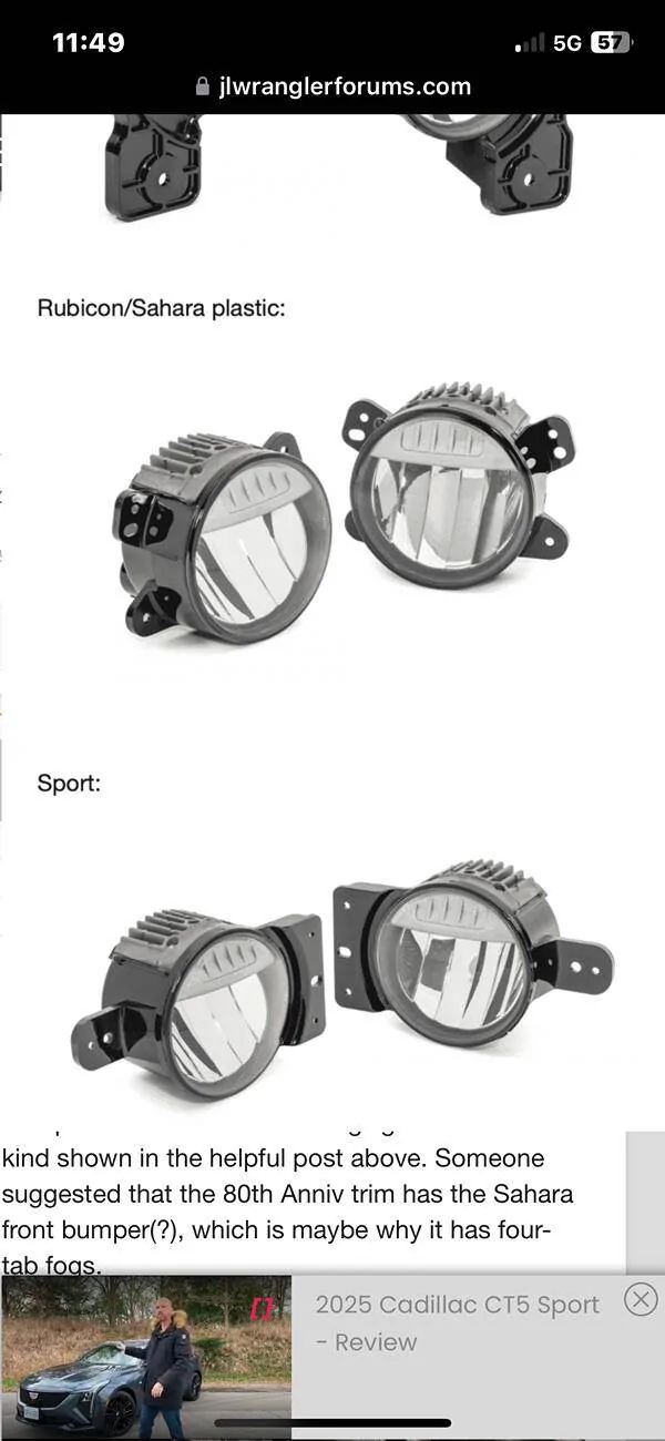

I got this pic from another thread since I am at work and don’t have my lights with me. Mine look like the ones on the bottom. That light like that did not fit in my bumper unless I am completely missing something.

So you had fog lights like the bottom ones and they fit? I turned those things every way I could and I just couldn’t get them on there. I guess I am just missing something. I was thinking I would go with oracles but wanted my original ones in there till I got them.

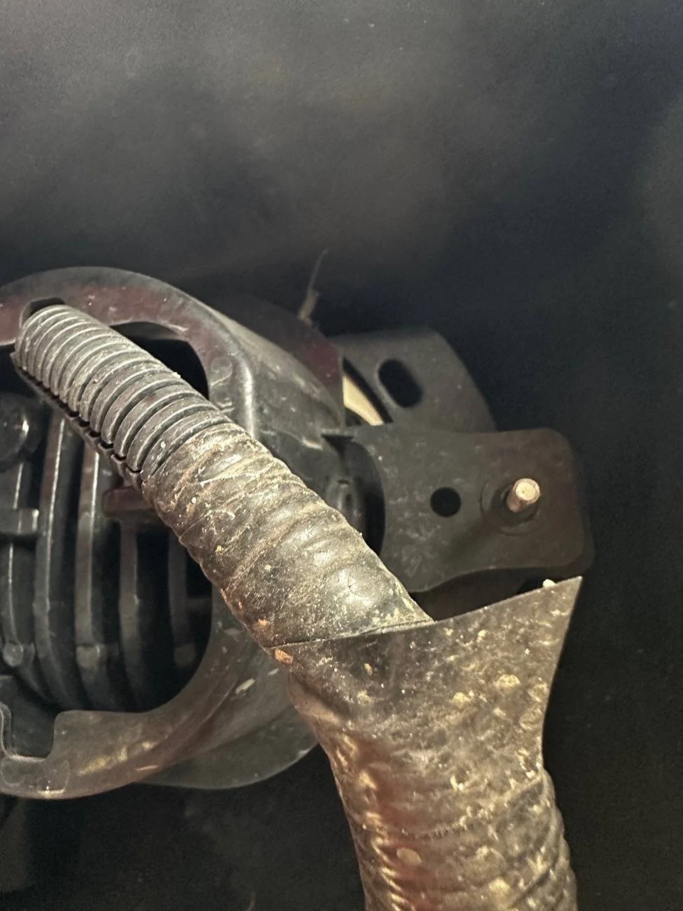

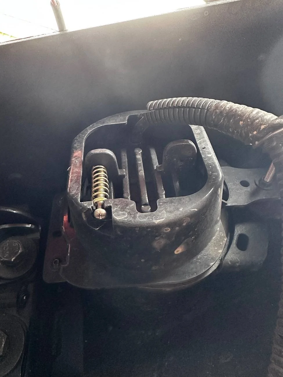

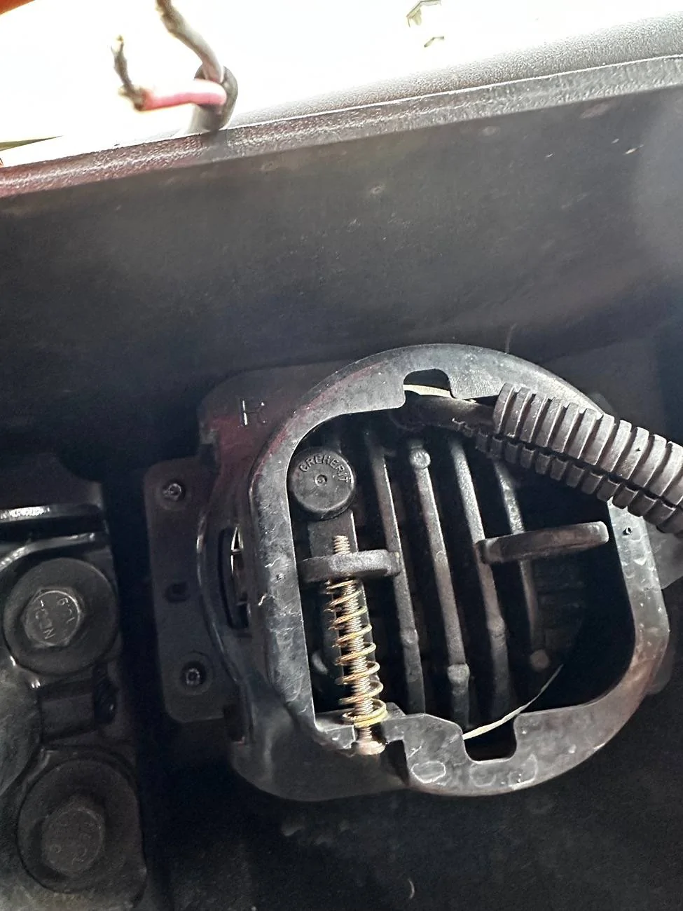

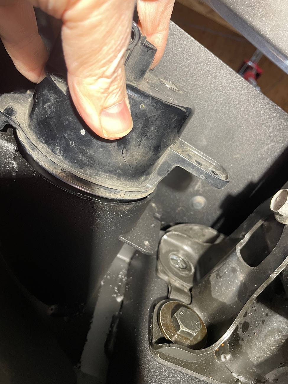

Ok so I got under there again and they do not fit. These pics are both lights trying to line up on the left side. The first pic is the way I would assume it is supposed to go. Even with the metal bracket that is supplied it would still not line up on the side opposite of the bracket. Every thing I have read says that they fit so I am feeling quite dumb that I can’t figure it out.

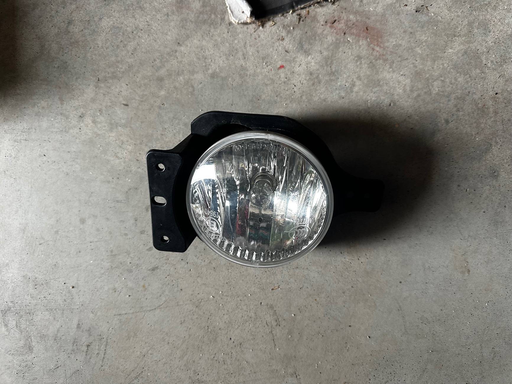

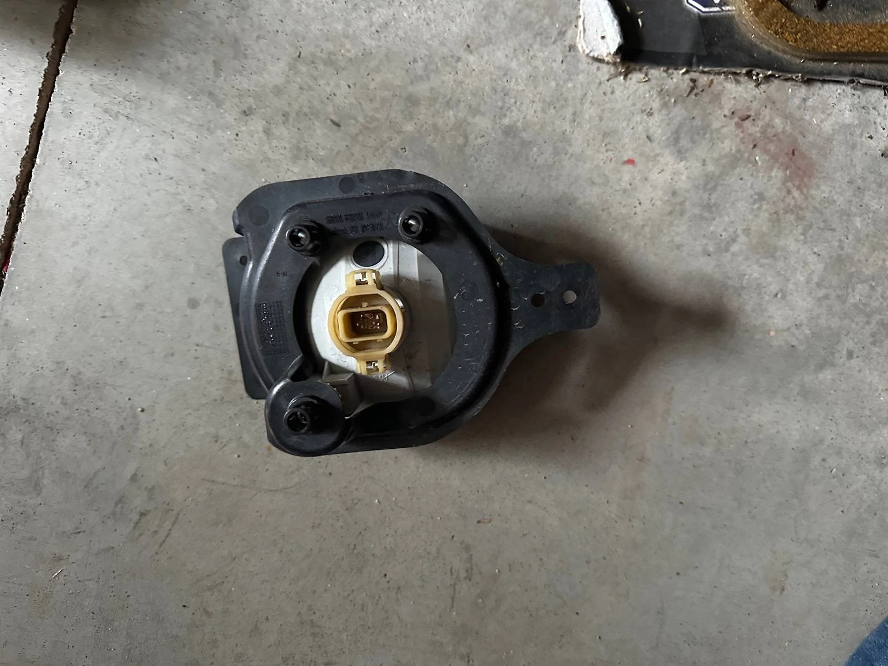

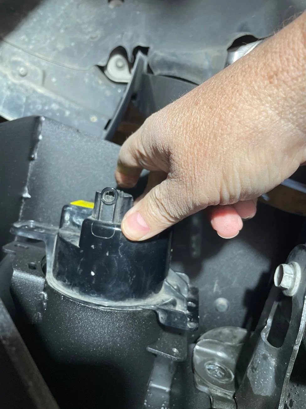

We have different lights. I have a 2020sport s which came with halogen lights. Are yours led. First pics are the oracles second are the stock lights. My tabs align. You could make it work with longer screw. Which bumper do you have?

Were you able to find a resolution? I am in the same situation, with a 2020 JL and the fog lights that came stock with the plastic bumper do not fit at all. I called Quadratec and they recommended I order replacement fog lights that would fit.
JHebs44
Jan 29, 2026
Canton, GA
2026 JLU Sport S
I also have the bottom imaged LED lights that they claim work - they did not. I was able to grab 6x 2" machine screws with washers and locking nuts - after some small drilling to ensure the screws fit snug/actually screw, I was able to get both sides secure enough where there is no wobble and appeared extremely secure and level (just be careful not to over-tighten and crack the plastic). They've been on just over a week and are still snug, but this was the cheaper option than new lights - might change later should they come loose.
