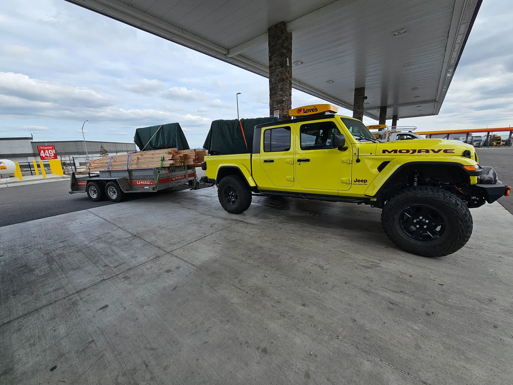

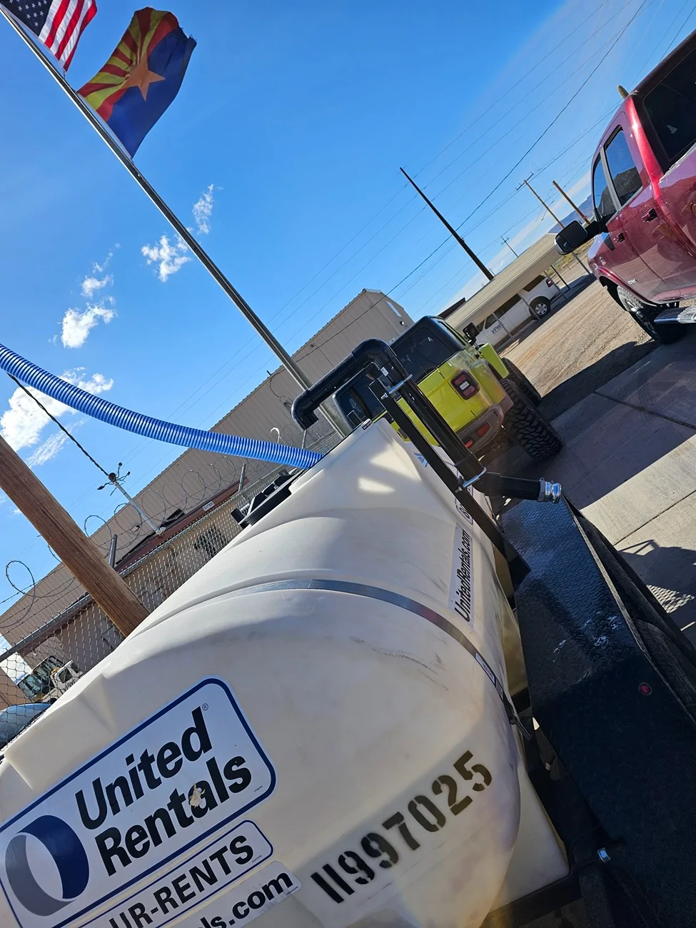

I'd agree with the tires affecting towing ability IF they were the limiting factor. The fact that the diesel JT is rated lower than the 3.6L and the fact they didn't put the 2.0t in the JT tells us what we already know, cooling is the limiting factor in the JL/JT platform. Further is the Dam test in 90⁰+ weather that's required for certification that puts those limits as low as they are. That's why every JLU in Europe and Australia is rated to tow 5k. They're perfectly safe and perfectly happy towing even on oversized tires. Just keep an eye on temps. I intentionally avoid pulling large grades at midday in the summer when towing heavy and haven't had a single issue on 37" MTs on the JT. Not even pulling an 8200lb trailer 600 miles including a pass that gains 4k feet in 20 miles. The 6k pound water buffalo isn't the slightest issue. And every heavy trailer has been drug out to our off grid property that includes 20 miles of washboard dirt roads. Not saying anyone rise needs large tires, but if you do for the wheeling you want to do, you can still tow just fine. As they say, pics or it didn't happen.
