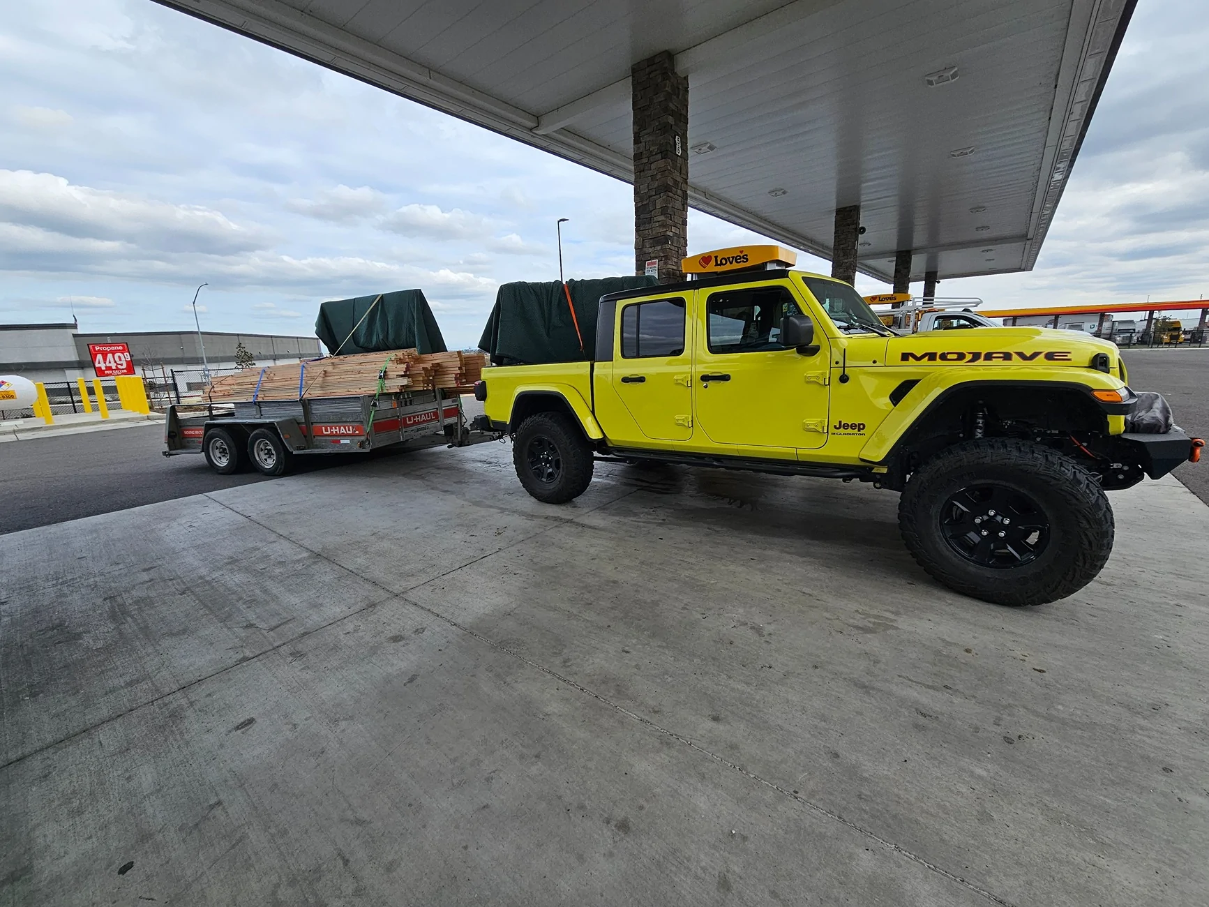

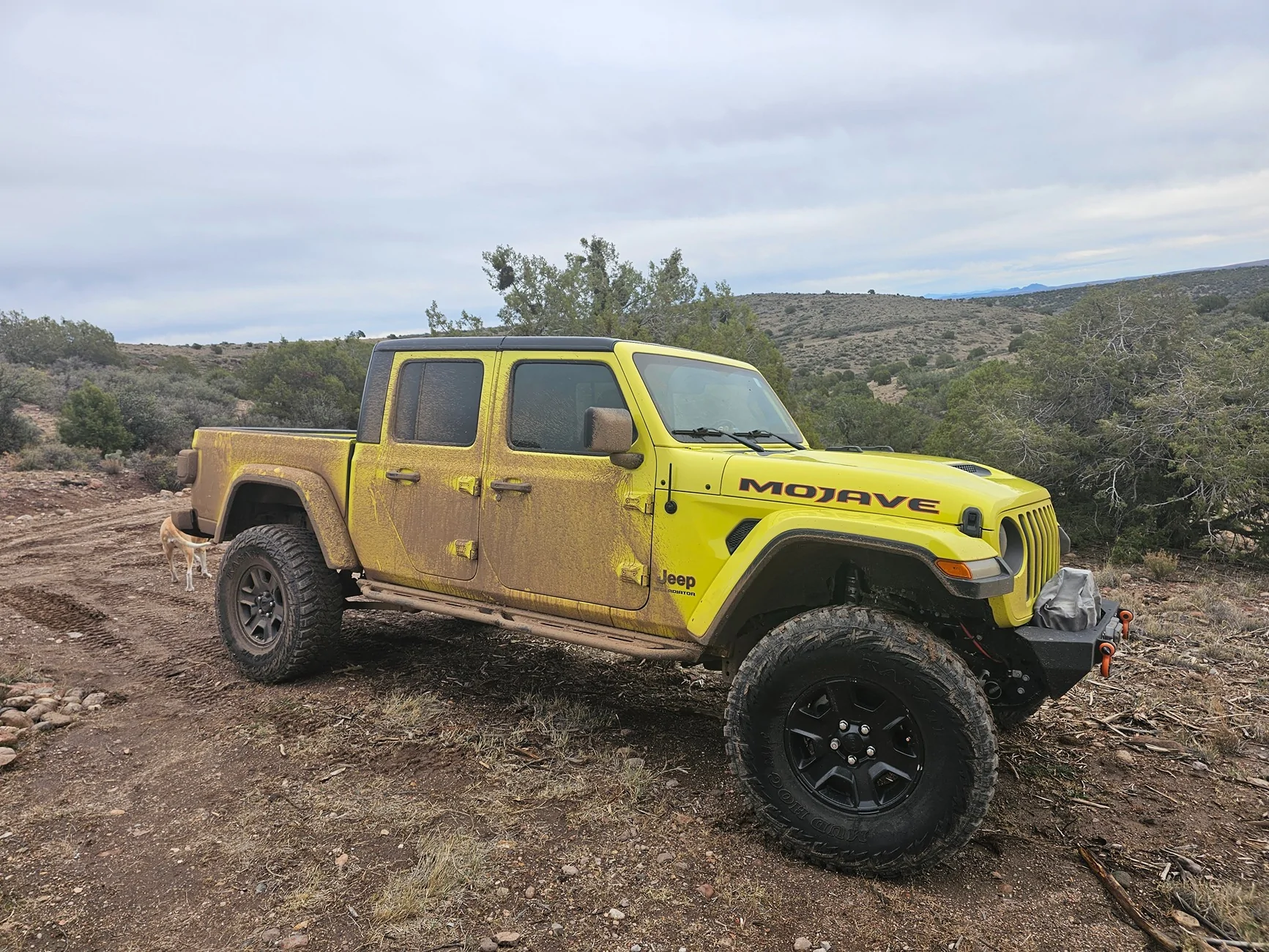

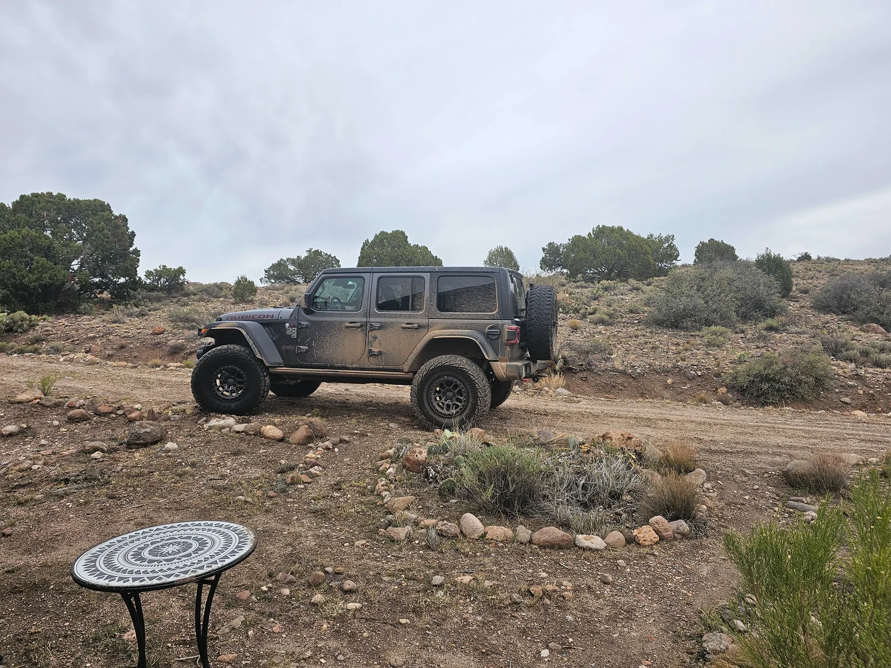

The pentastar moves the JLUR on 39s no problem even with the stock 4.56 gears. Of course it moves the JT with 37s and 4.10s pulling an 8400 pound trailer so why would a little bigger tire be a deal breaker. Could it use more power? Absolutely. Will the thing still hit 100mph in the desert no problem? Of course.

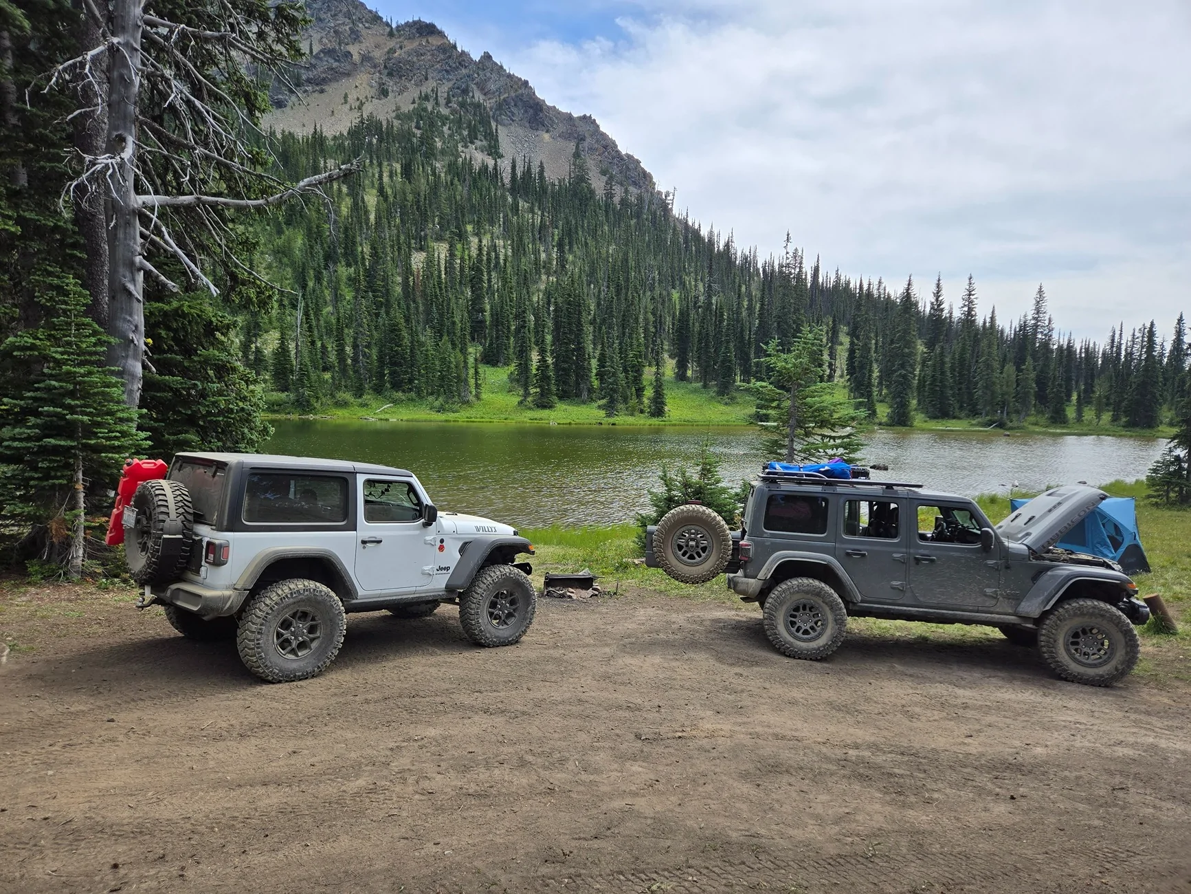

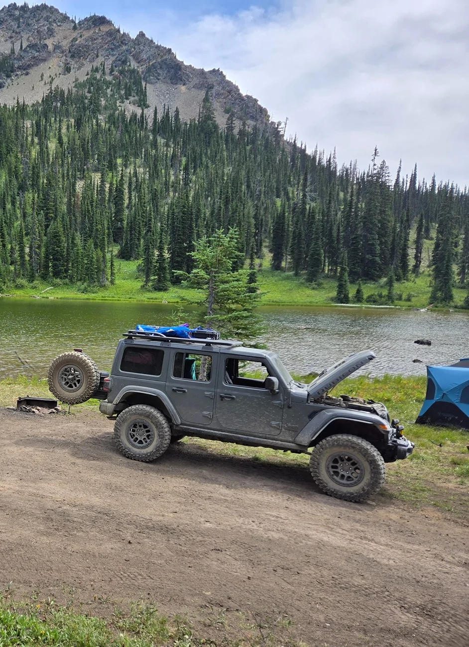

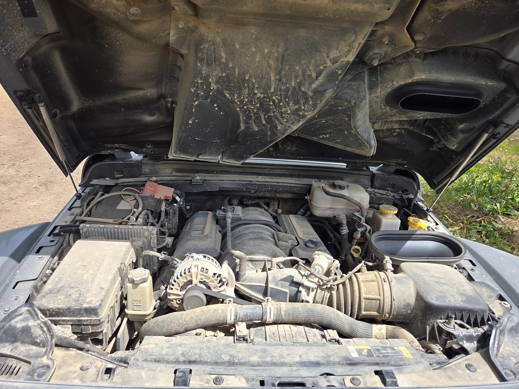

It was my first time on that trail to the lake, and this 392 guy said follow me, and he was going over obstacles like crazy and on that silent remote trail his exhaust sound was all over the place. I had a tough time keeping up with him
