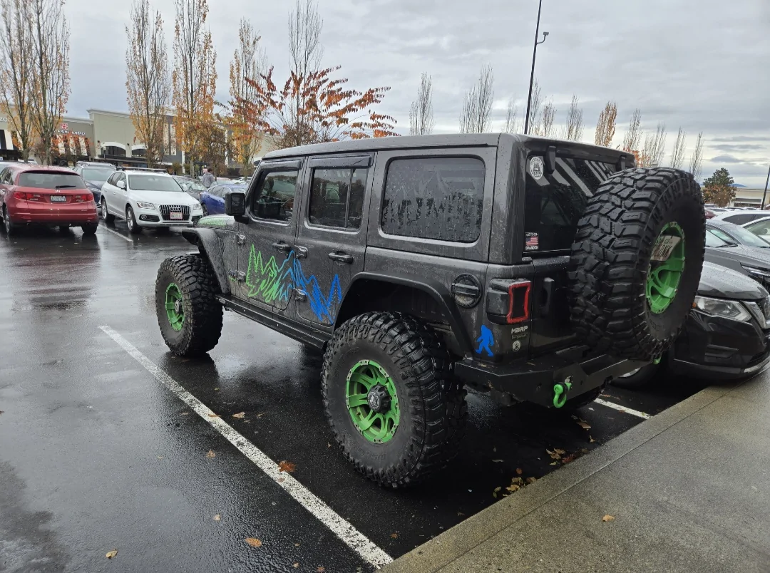

Hey I said crazy in a positive way. I mean look at this, and he said he still gets over 20 mpg 🤯 Diesels are crazy impressive. I doubt the Pentastar would even move with all that.
