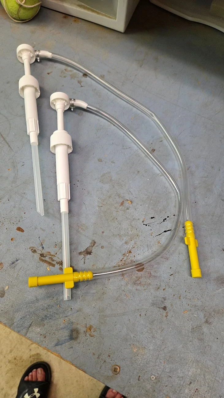

I end up using pumps with hoses that I've had forever. They work great with gallon jugs.
These! I have a different one for every flavor of gear lube in the garage. Pro tip. Ihave had good luck getting them for free from any place that services outboard engines. One usually comes with every cases of lower unit gear oil. They usually have more coming in than going out.

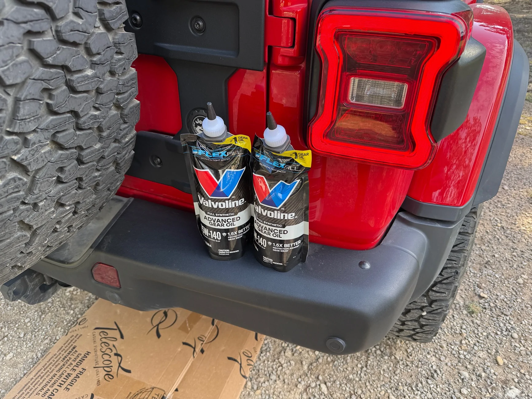

I just replaced front and rear. Used valvoline 75W-140. The squeeze packs are easy to deal with. Good price on Amazon. Used almost 3 of them.

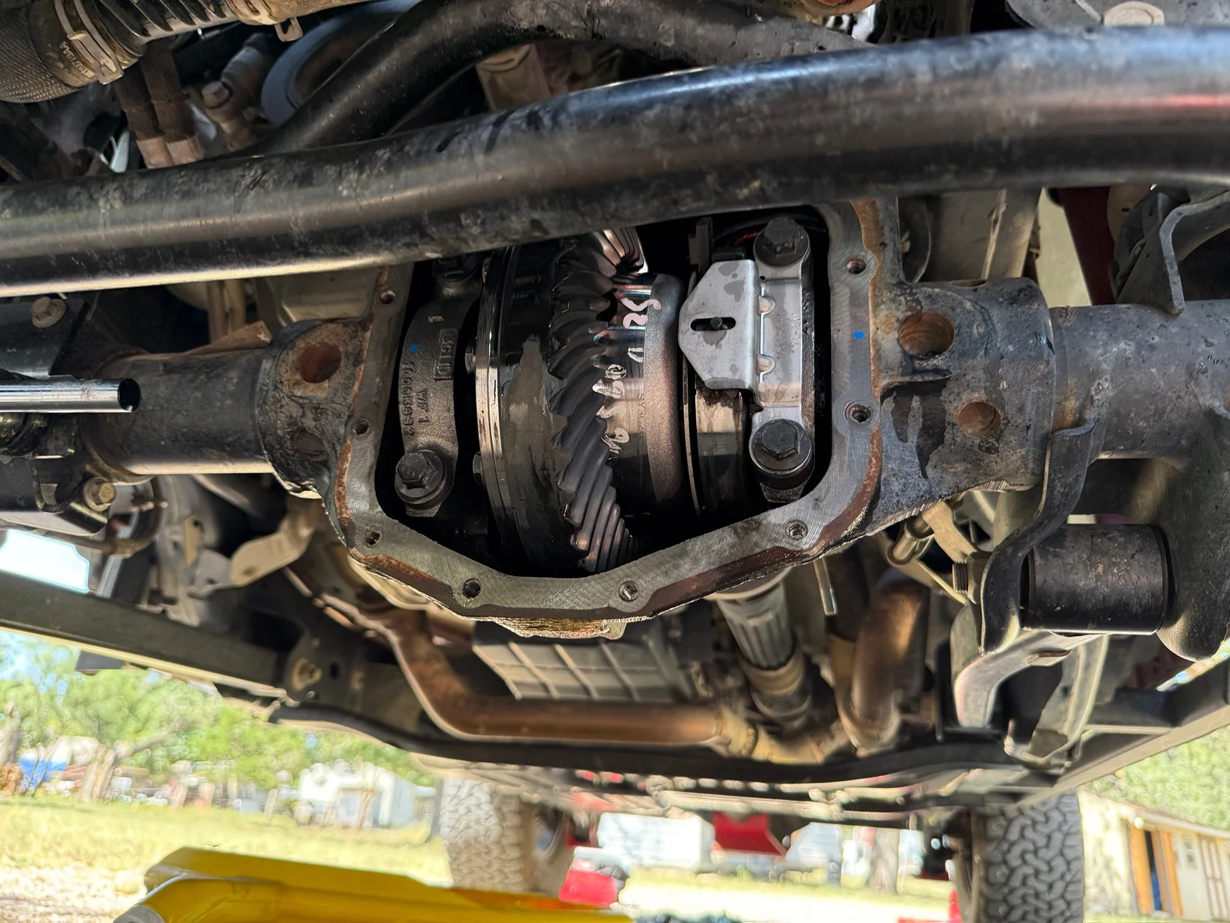

Big thanks to everyone for the help! I was able to get the fluid changed with no issues. Went with 75W-90 (Purple). My 2022 doesn’t have the front drain plugs, and getting a few of those top-right bolts out was a pain—but it’s done. No leaks so far. You guys are awesome!
