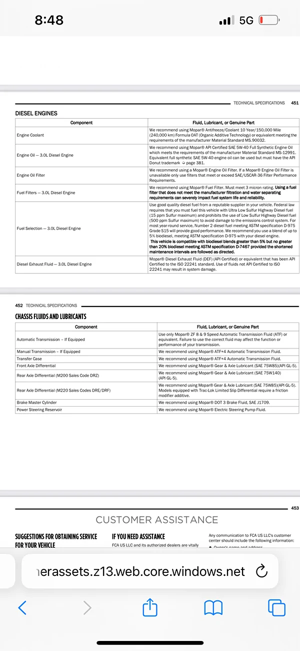

I have a 2022 Jeep Wrangler unlimited sport and I’m having trouble understanding the manual, please see the attachment.

This subject gets beaten to death regularly.
The short version is:
  1. Jeep recommends a thinner oil (75w85) specifically to improve fuel economy by a barely perceptible amount.
  2. The axle manufacturer recommends a thicker oil (75W140) because it protects better.
  3. The thinner oil will get you through the warranty period without failure.
  4. After warranty, Jeep doesn't care.
  5. Most people use the thicker oil.
  6. Using the limited slip additive doesn't hurt anything if you don't have a limited slip.
  7. Not using limited slip additive when you have one is very bad for the limited slip.
That's about it.
Just get the 75W140 and use it.
Edit: Any oil that meets API GL-5 standard is a good choice. Some other oils that haven't been tested may or may not be good. But you can't go wrong with an oil that meets spec.
2nd edit: if you have an aftermarket Eaton TrueTrac limited slip, you specifically want no limited slip additive. It works differently than the factory clutch style limited slip. The additives affect the internal gears and throw off the torque bias. It doesn't hurt anything but it reduces how much it limits slip.

I would follow the factory recommendation and not the oil experts in this forum. You will need to identify which rear axle set you have in order to use the proper oil.
Even if the factory makes a recommendation based on fuel mileage rather than on longevity of the axle?
And which factory? The factory that built the axle or the factory that assembled the Jeep? They have different recommendations in this case.
