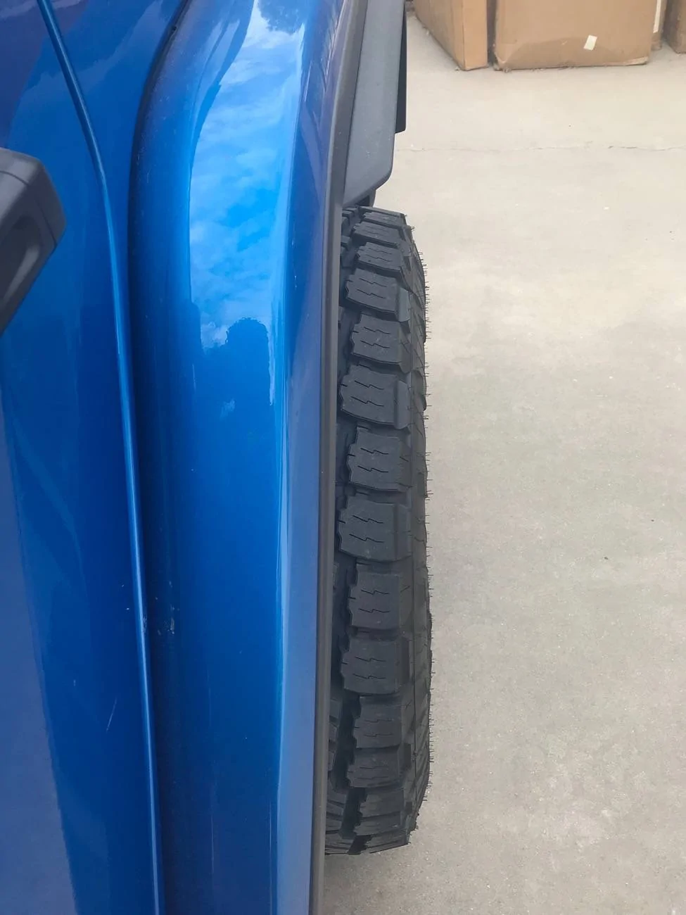

With 8.5” -1mm 12.50’s tread Is ~ even with XR extensions. -12mm would be ~1/2” more poke.

On my JLURD I'm running Teraflex Nomad Split Spoke wheels:
17x8.5
Offset -12mm
Back Spacing 4.25"
Toyo Open Country R/t Trail 35x12.5x17
I have the Mopar lift with the remote Bilsteins.
No rubbing.

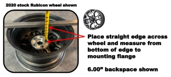

My suggestion: be sure to do your homework, get your measurements correct. Where you want your tires to be regarding rubbing and poke. Get it right the first time to save headache, disappointment, and $$$. You're in the right place, get lots of advice, photos, don't make your purchase until your at least 95% sure. You can also order 1 wheel and tire to be sure of fitment and rubbing before ordering a full set.
https://tiresize.com/wheel-offset-calculator/
Best of luck my friend.
