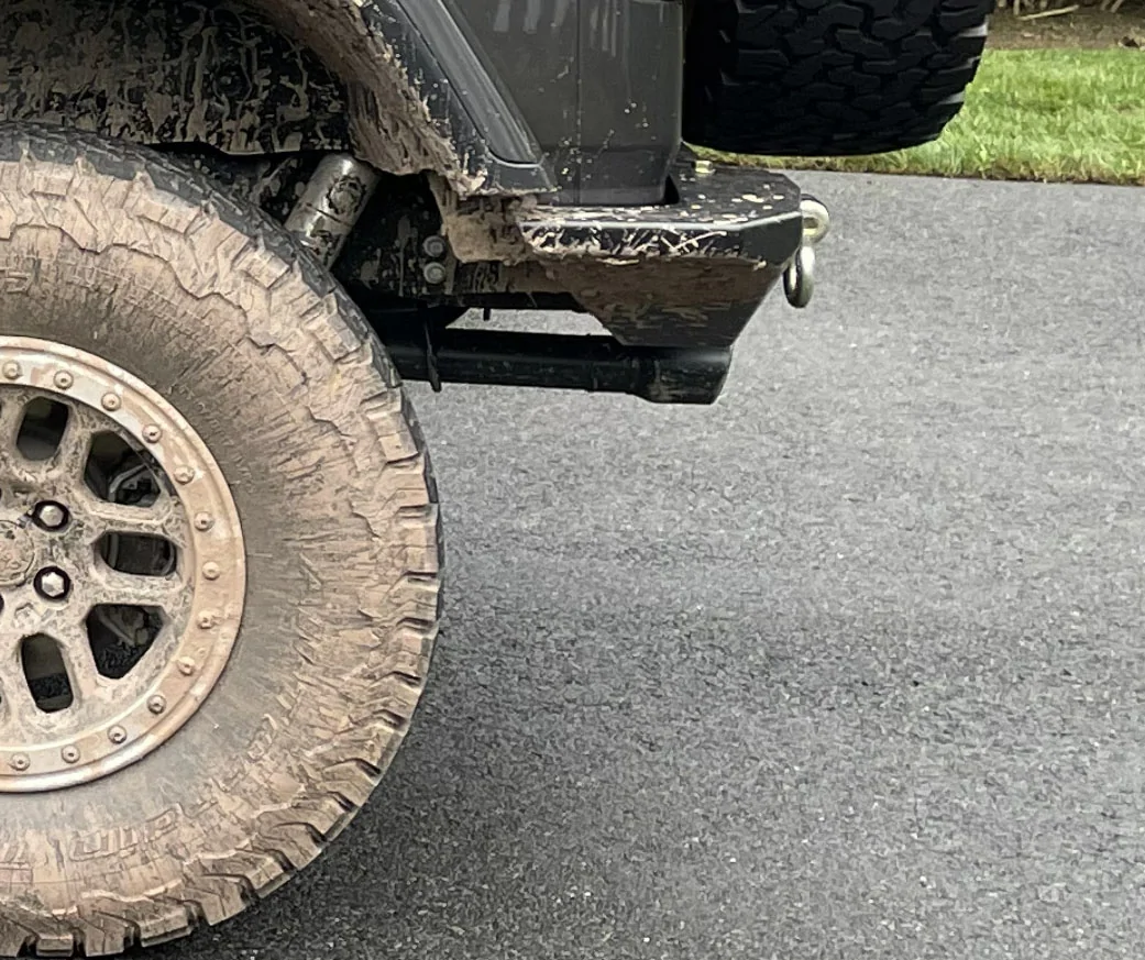

That side picture shows better what I am talking about. If someone needed more clearance, they could just remove 4" of that exhaust tubing right after the exhaust hanger and reweld the tip on 4" closer to the Jeep. No downpipe needed. It would still look great, but without the tips sticking so far out.

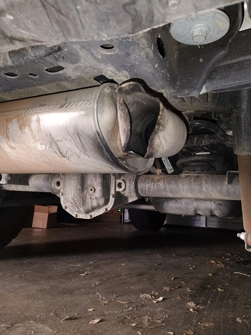

The exhaust outlet is like a sacrificial bumper skid
