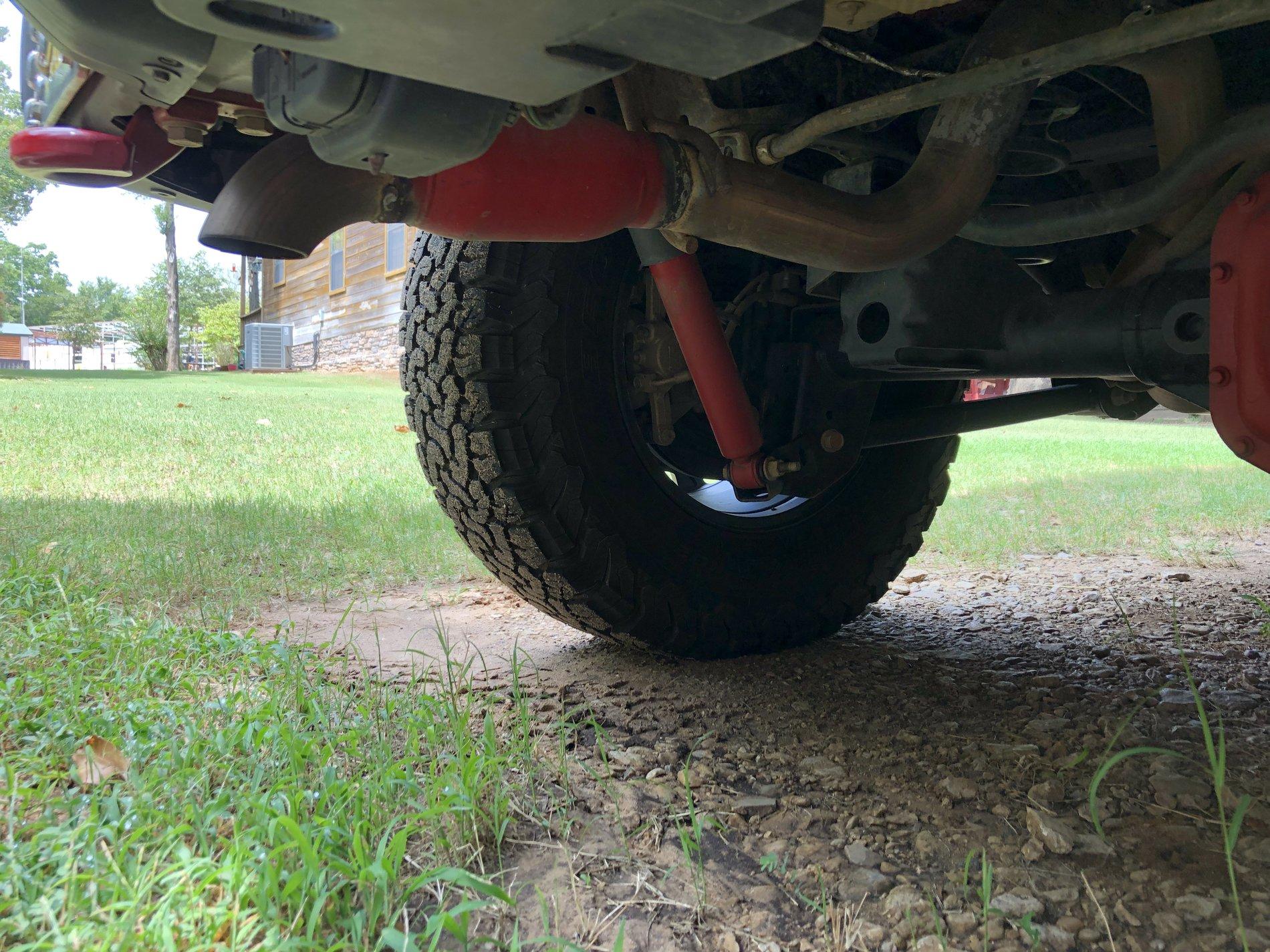

Yes $80 for delete pipe and $20 for 12” long 2-1/2” ID glass pack muffler from JEGS

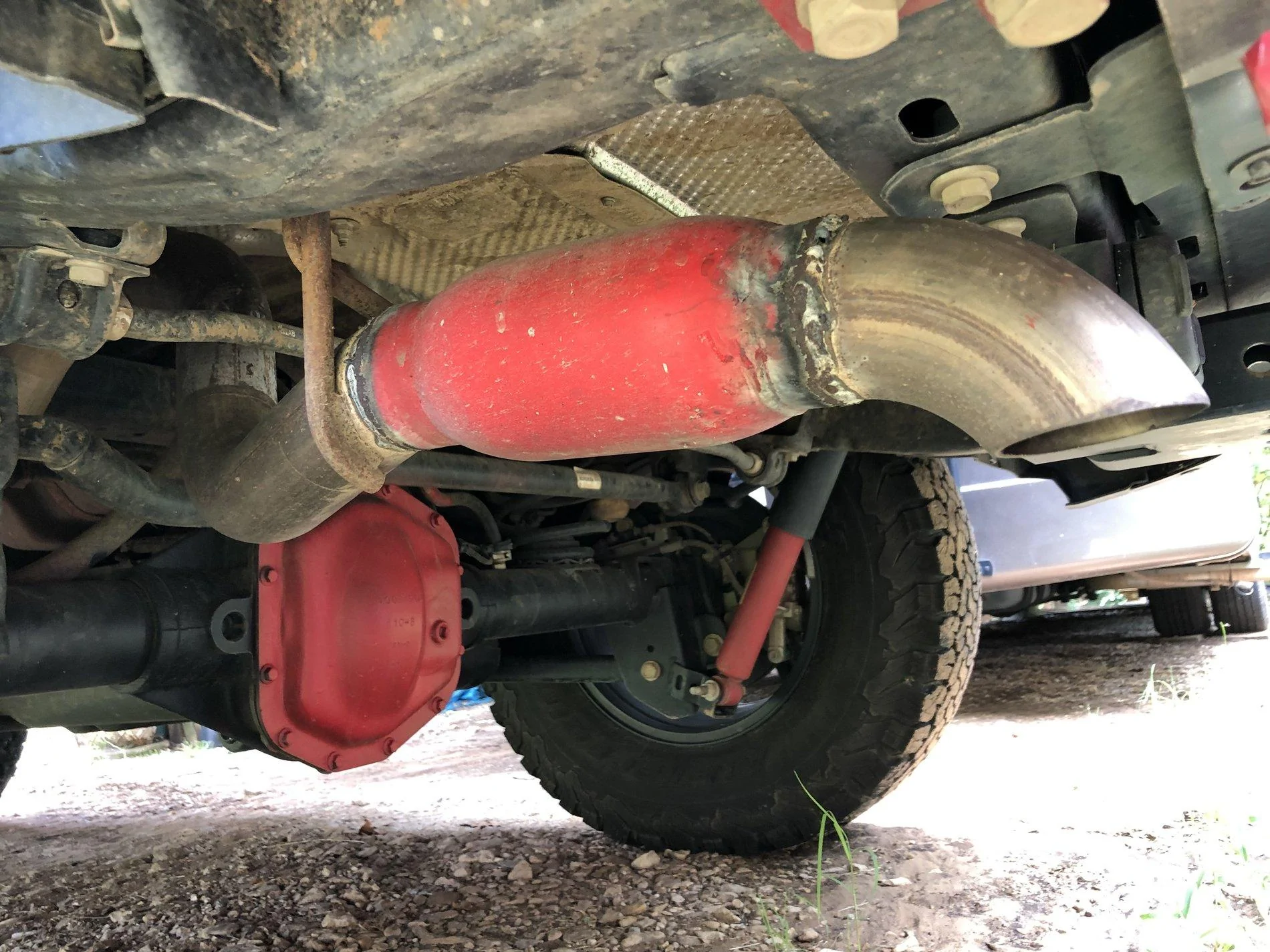

I like that... installed where? Just before the delete pipe? Did you shorten the factory system to fit it? Got pics?
Cut delete pipe off just past the hanger, cut inlet and outlet off glass pack, welded on delete pipe, used cut off turn down from delete pipe on outlet of glass pack Will send pics tomorrow

I will try. It is louder than stock muffler but quieter than just delete pipe!

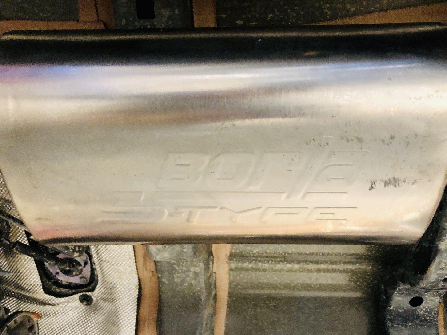

I’m running the Borla Climber (S type). Love it! Sound is throaty under load and quiet when you’re maintaining speed!

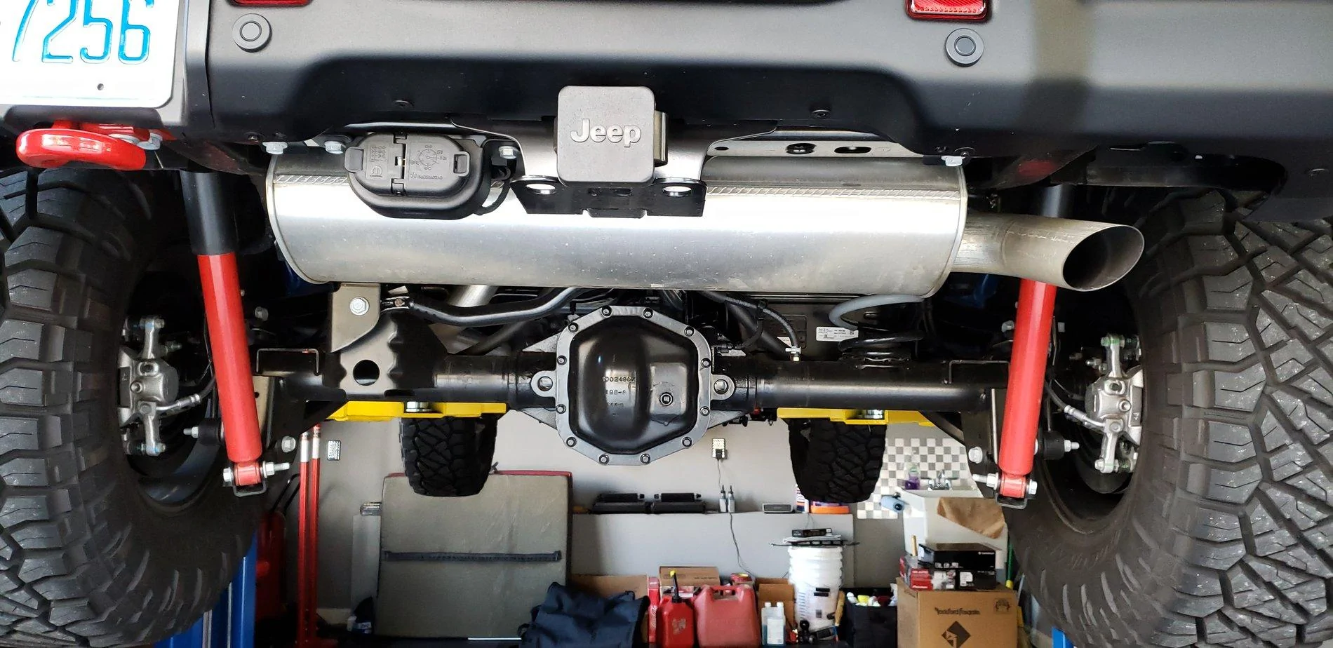

I went with the magnaflow 19388 catback and couldnt be happier. I've had it on since Jan. It has the low sound increase under acceleration without any drone and also cleans up the look in the rear as well. Heres a before and after.
