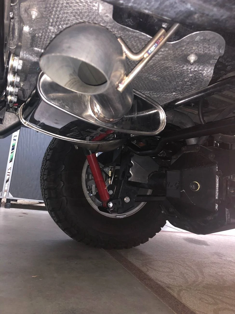

Got the Injen High Tuck Stainless during their anniversary sale several years ago. You can’t see it from the rear of the Jeep. Did this to the rear bumper and the muffler was untouched. The clearance was the goal. It’s no longer shiny like this install pic though

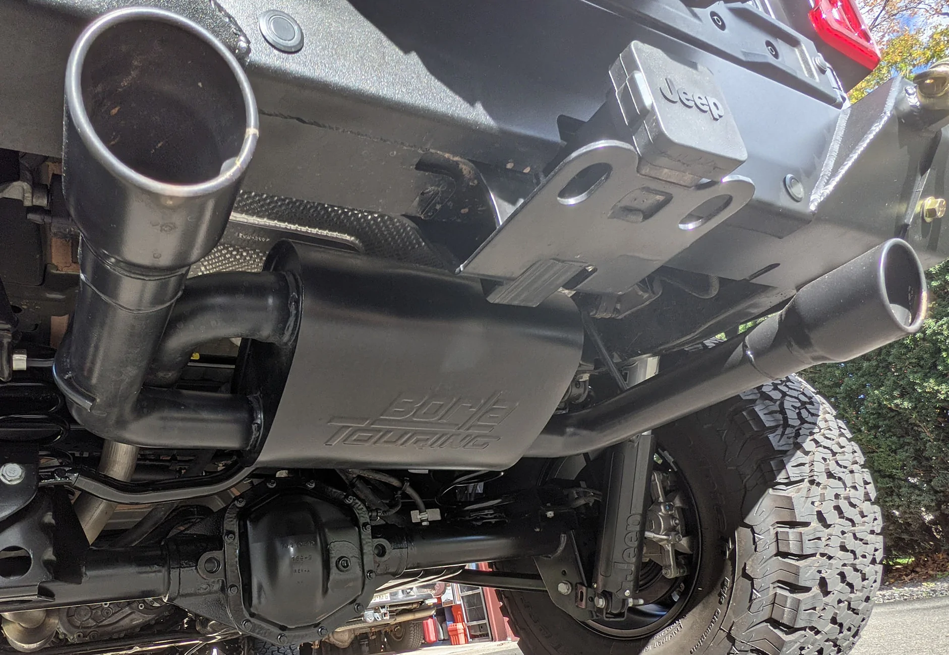

I'm very happy with my Borla Touring cat back exhaust going on 5+ years. There is no drone at all and super easy install. With the manual trans the stock exhaust was totally silent and made driving/shifting by ear difficult (at least to my old ears) It has just enough low frequency engine sound so I can actually hear the engine, but doesn't bother my neighbors and doesn't sound like a rattly coffee can exhaust. You're never going to make a 3.6 sound good by going louder anyway. The clearance isn't much better than stock, so if rock crawling is your thing, probably not going to improve things. I also like the subtle look of the dual black tips - big improvement over stock.

Definitely possible - but I found this side view that shows how the pipe sits under the back. They are lower and straighter out the back than you'd think. You could probably cut them back to the hangars and just weld on a turn down. I think that Borla at least also offers other more low profile options (i think they call it their Climer models). But then you're into more than a bolt on and its louder. I don't do much that requires super high clearance and I certainly didn't want loud - so this one fits my use case perfectly--- your mileage may vary :)

That side picture shows better what I am talking about. If someone needed more clearance, they could just remove 4" of that exhaust tubing right after the exhaust hanger and reweld the tip on 4" closer to the Jeep. No downpipe needed. It would still look great, but without the tips sticking so far out.
