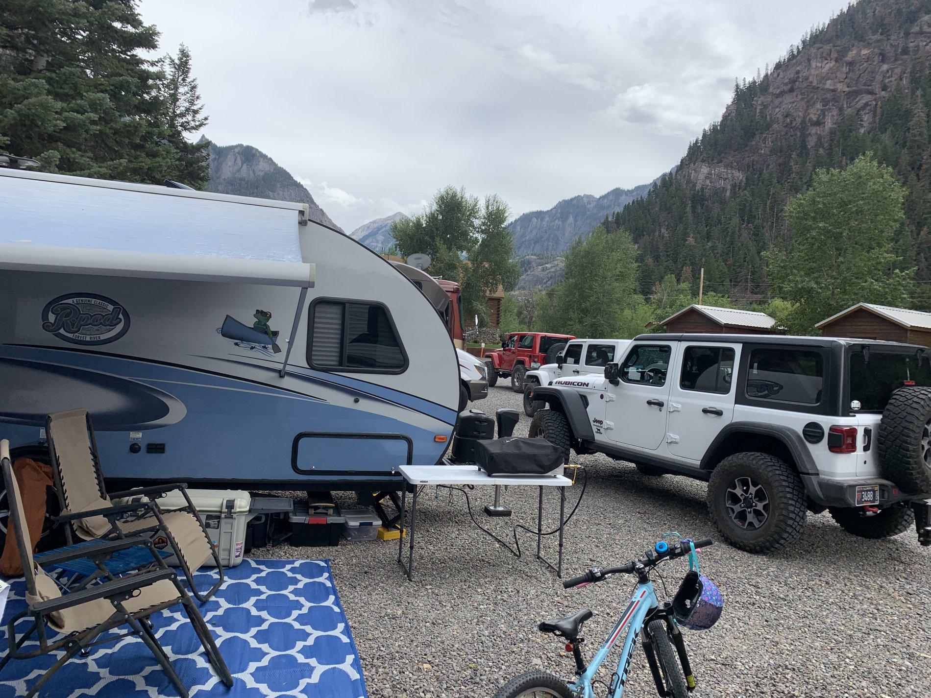

Towed this through I-70. No issues. 3.6L
Also did Imogene and most of the other passes in the San Juan’s and was never left wanting/needing power.
